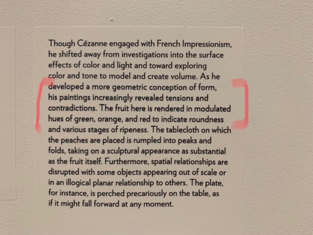

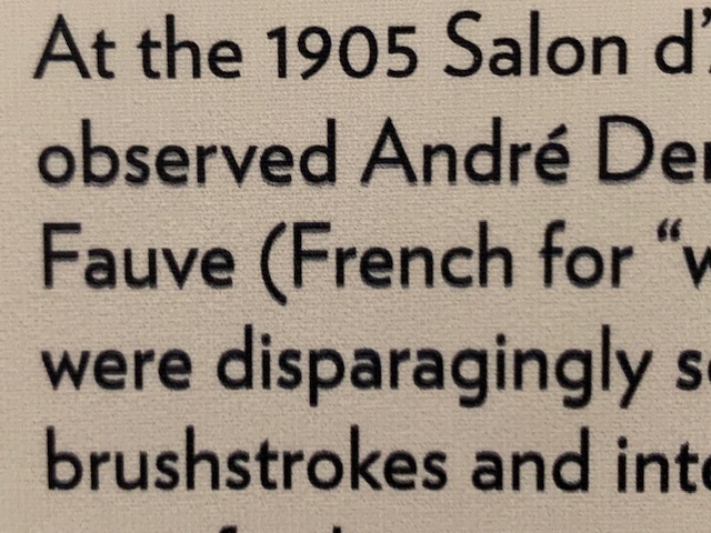

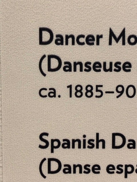

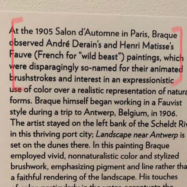

I am experiencing a new problem. I am printing small 4" x 6" labels and posters on phototex, and getting offset print happening on the black type just the text. SEE PIC. Both black and cyan printheads look good.

What is the print direction? Did carriage move in the text direction?
Was there something around the text like pictures or else? It's important to know.

type is horizontal so the printhead is oriented to print it left right. Put another way the printer is oriented to print it like a typewriter. There is an offwhite color in the backround and the file is an eps. Its a new problem but not a new job, been doing these types of prints for about 2 years.

Well then it's a momentary movement error.
Did you attach to take-up? Or did you move the material by hand, did it touch the floor, end of the roll, something else? Have you cleaned the OMAS window?
If you want you can turn off OMAS and do a manual feed calibration. That should solve it.

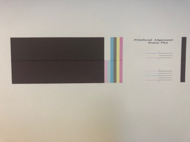

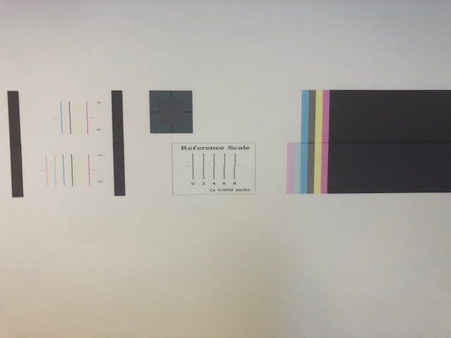

here are my recent alignment tests. NOt sure how to read these but they look good?

It doesn't have anything to do with your alignment because it works most of the time.
You need to go to substrate Library and modify the print mode you are using. There is advanced settings and OMAS option to turn it off. At the same place you need to introduce advance calibration value. That test you can find in the settings under image quality maintenance.
All this stuff is also in the user guide.
If I had to guess maybe that 3rd party take up of yours gave it a good pull or something, because that sort of thing made this error happen.

I'm surprised no one mentioned this yet, but what is your ink density? After printing on phototex and other fabrics for year's, that inconsistent haloing is actually the ink bleeding into the fabric. It can be solved by reducing the ink density.
Being a fabric product the fibers can draw ink into them. I bet if you print the same file and same profile on a vinyl substrate you will get different results.
