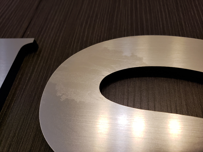

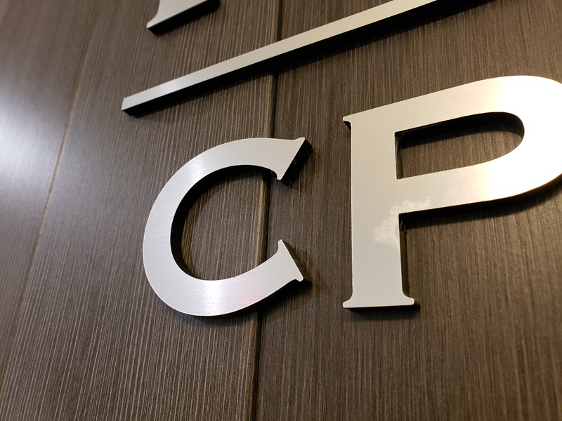

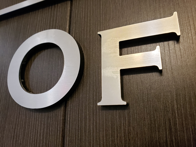

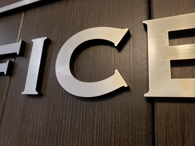

Last night I showed up at the new office to install the letters onto the new wall. Once all the letters were installed, I started peeling away the transfer tape and noticed that anywhere where there was a bubble or wrinkle in the transfer tape, the GemLeaf finish was compromised. It looks like some sort of weird oxidation/chemical reaction and upon closer inspection, as seen in some of the photos, it even appears that the finish has been depleted or eroded. I called Gemini and even though they have had some reports of this happening from others in the past, they have no suggestions as to what we can possibly do to fix it, which leads me to believe that there is no fixing it and that trying to remove and relocate GemLeaf letters is just a bad idea altogether.
I'm going to watch some YouTube videos and see if there is anything at all that I can do to try to restore the brushed finish on these to at least look 90% as good as the original, but this is going to stress me out, for sure. Gemini is sending me a couple samples of the brushed aluminum letters that I can experiment on, plus we have a couple small samples here already in our shop that I'm going to play around with also. I'm hoping something as simple as brushing over the grain with Scotchbrite or some fine grit sandpaper in the 400 range might be enough to fix the flaws that appear to affect about 75% of the letters. I know that GemLeaf itself is a very thin coating, so I won't be able to sand a whole lot, but if I'm lucky maybe it won't take much. If I'm not lucky, I'll be cutting the letters off the wall and replacing them all, like I guess I should have just done in the first place.
Has anyone here ever run into this issue? If so, were you able to fix it and how did you go about fixing it? I'm open to any and all suggestions at this point. 2022 is starting off to be a bad year thus far.
