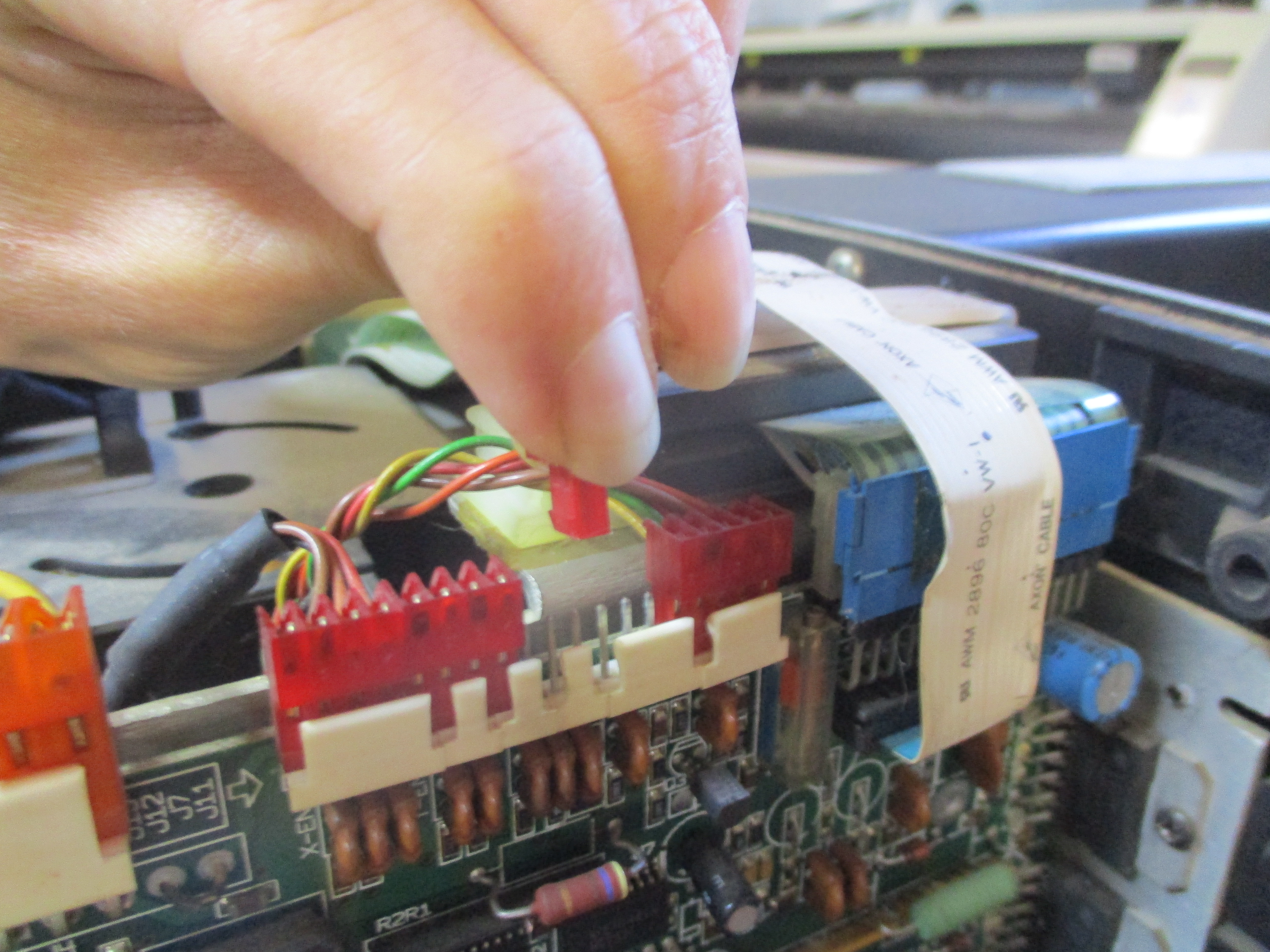

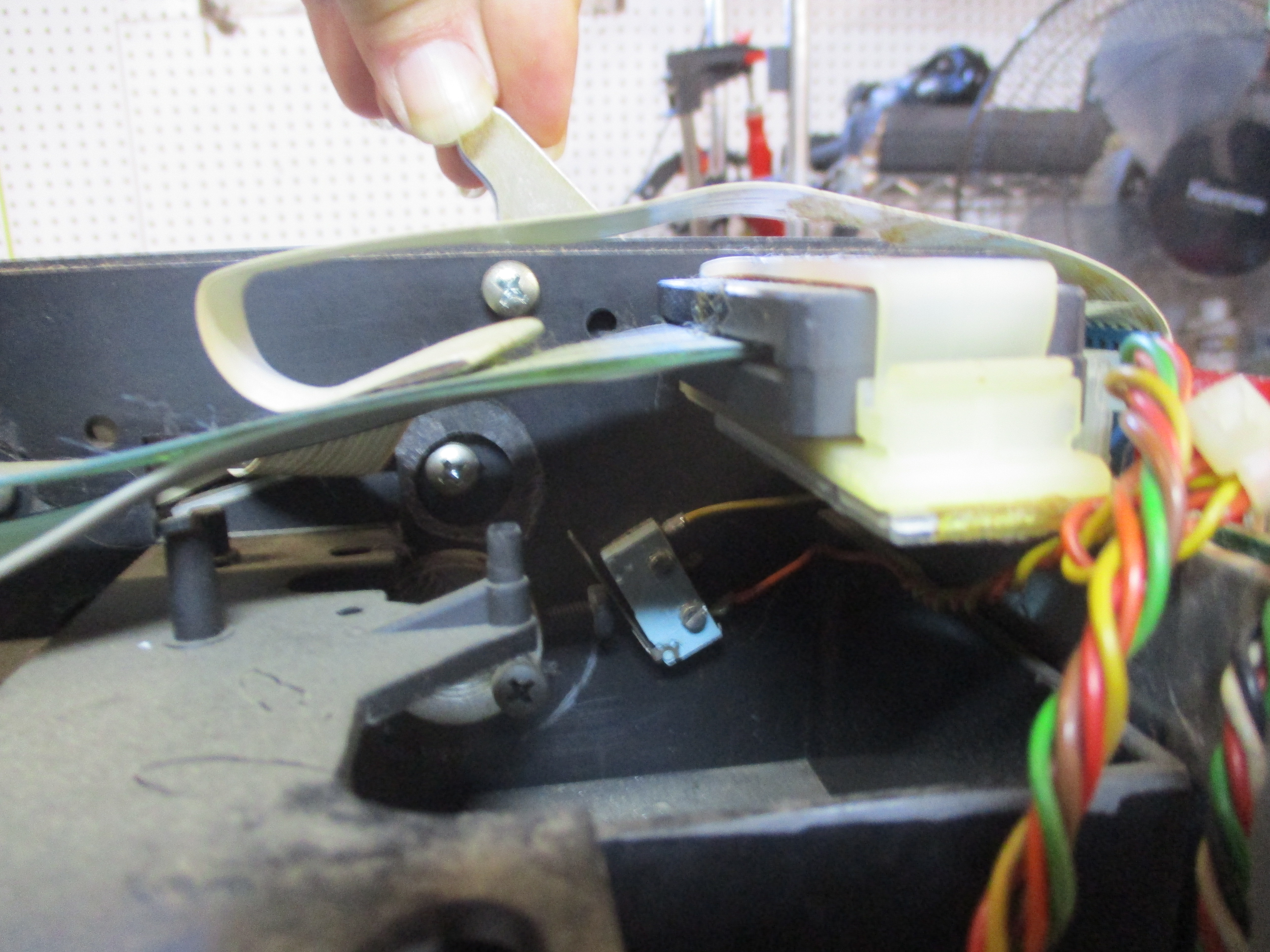

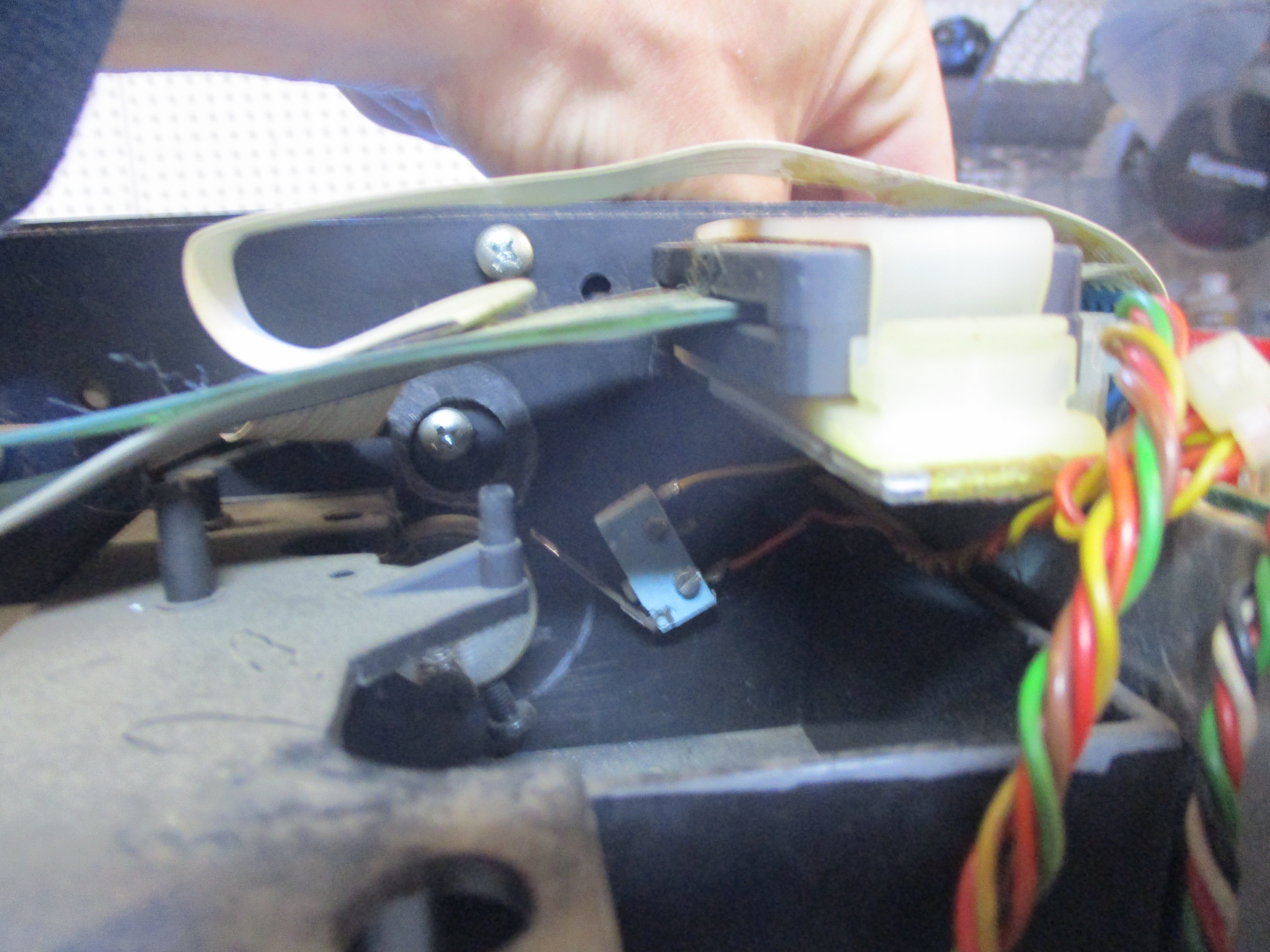

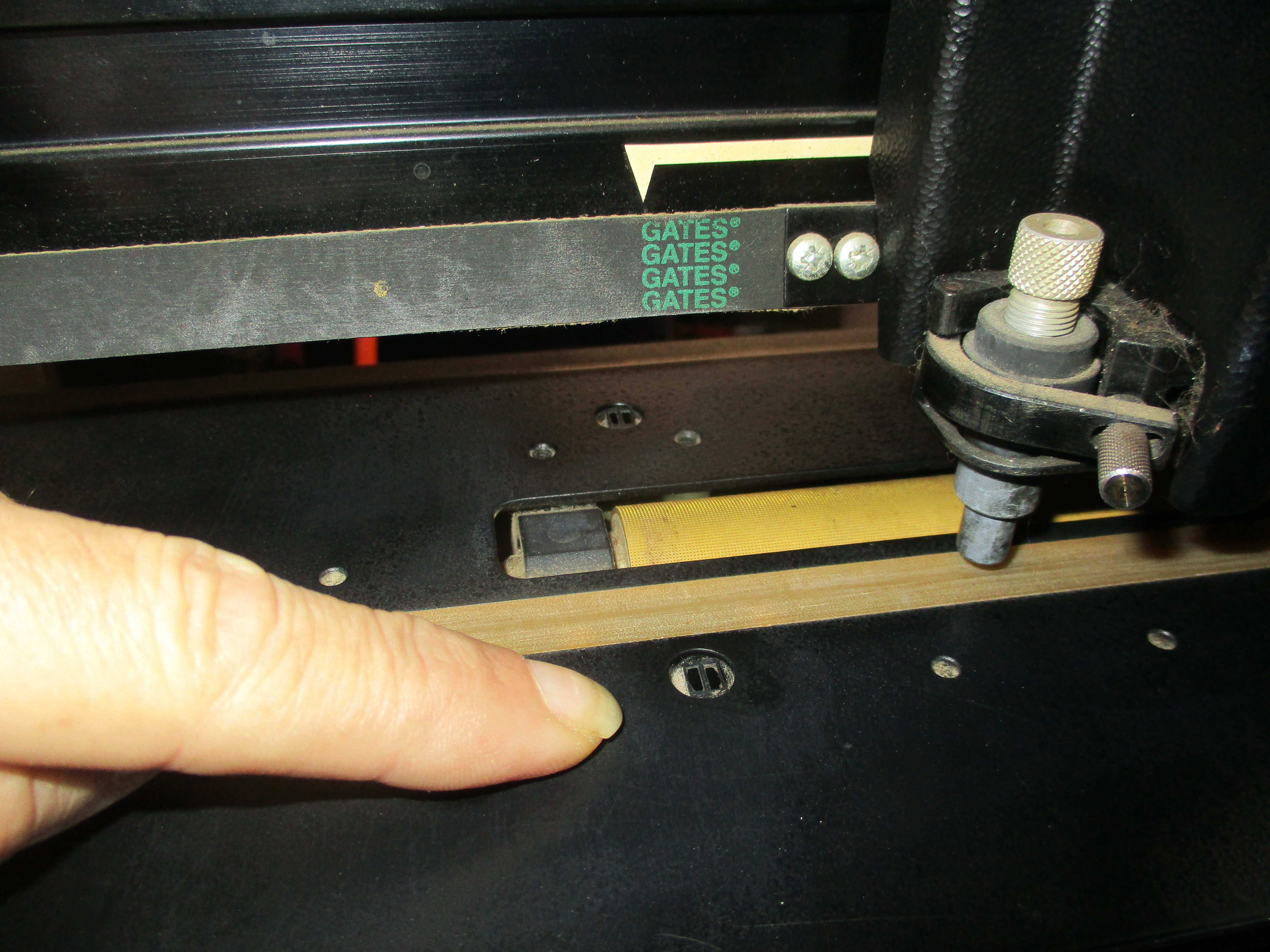

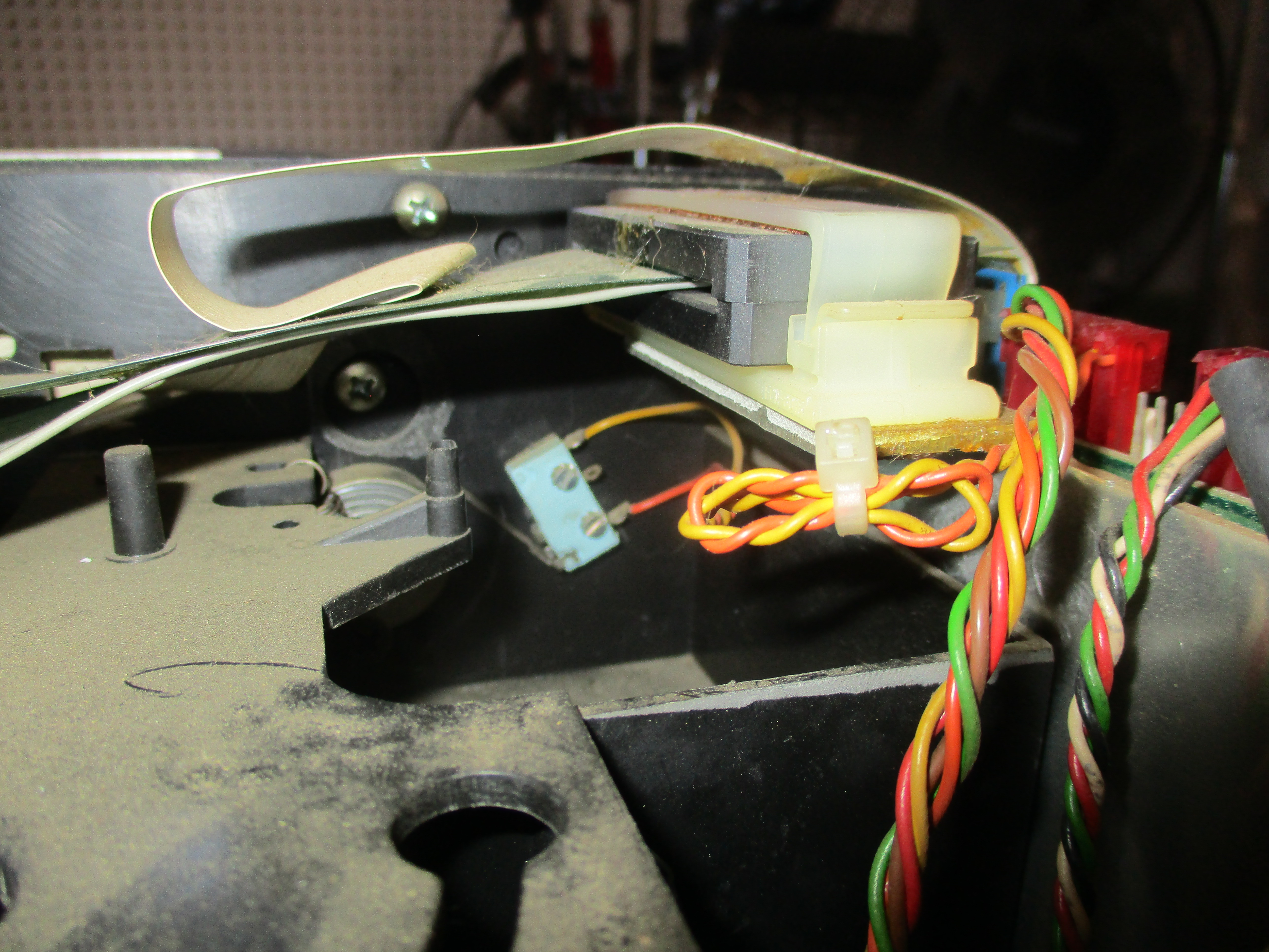

yea it's a summa sign pro D610 24" .. has a little LED display on the right. .. in these pics i took the cover off the side. it is my workhorse and no other cutters can match the accuracy so i want to fix this one if i can. i looked at the new summa's. I'd like to get a new one but i don't have the funds for a new one and not going to buy any US cutter crap. the last pic i'm pointing at the sensor, but there is another one in the rear you can also see. i put my finger over that rear one and as i mentioned, nothing happens, so i assumed there is 2 different sensors without cracking open the bottom steel plate yet. regarding the plug, i unplugged it, it was not loose or off, just showing where the little blue switch in there plugs into motherboard.

I told you how to check and adjust the sensor, have you tried that?
For letting the cutter start loading media, the little blue switch needs to switch (you should hear a „click“-sound), and the back sensor should recognize media. If nothing happens if you cover the back sensor you need to check the sensor or you need to switch them off.
Attila Nagy
The switch wired directly to a Motorola Processor's port, and only 1 port could fail. I used to replace them on some motherboards, but in my cases it behaved like the rollers were in low position, so I could initialise the media by turning the machine off and on again.

DLed manual. went through sensor test. all it does it bringyou into a menu where you can adjust the sensitivity of the front or rear sensor. I don't see where it tests if it actually functions. Unless the reaction of the machine while pushing the left and right arrow button to adjust sensor level is what tells you the sensor is doing anything.. Which i can say that while in the adjustment menu for sensor setup. after pushing the enter button (bottom right) the gold drive shaft turned slightly forward and slightly backward repeatedly. when i pushed the left or right arrow it stopped for that moment and started again back and forth repeatedly until i exited out of that level of menu. I did cover the sensor half way, but it doesn't say half way front to back or left to right. it looks to me like there are 2 sensors one left and one right inside both the front and rear sensor ports. So, pretty much don't know if i even did the test right because the manual doesn't give enough information. Any insight on this Frank? thanks buddy
FrankW
Front to back. When moving, it switches between covering the sensor and open the sensor. You should see a reaction level on the display. Covering half way from left to right doesnt make sense.

UPDATE: i see the reachion.. upper left top layer of lcd.. you see an arrow pointing to the right it kind a looks like.. my lcs is pretty faded at this point 20 years later of working. lol ... so thanks again Frank!! so yea, both sensors reached. and yes i do hear the blue switch click when the arm lowers the wheels onto the sleeve, but idk if a click sound necessarily means the switch actually working unless the click means the circuit is closed. i don't have information on that part. but i consider this progress so far anyway.
FrankW
If the sensors react, and the level goes over the asterix for both sensors, you can unplug the switch from the mainboard, set some media, lower the pinch rollers and switch on the cutter. If the switch is really the problem, with the switch unplugged it should load the media.
