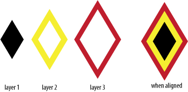

GypsyGraphics
I like to make a solid diamond for my first layer and graduating diamond outlines for each layer that follows. I put them on the left and right, either top or bottom. Prefer not to have to pull them off the substrate so I trim them off once all layers are in place.

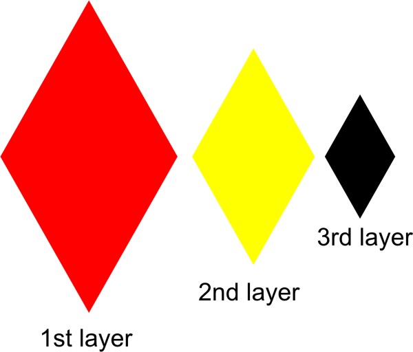

Seems like a lot could go wrong with that. Are your cuts EXACT, meaning that the vinyl butts up against each other or is there overlap? And when your vinyl is layed together edge to edge, when the vinyl shrinks won't that leave you with a gap between each color.
I prefer to stack solid color on top of solid.

GypsyGraphics
If your cuts aren't exact, your going to have a problem no matter what form of registration you use.
The open diamond gives additional points to align. A solid diamond means eyeballing it to center the diamonds.
This is one of those "whatever works best for you" deals. Input from several people should be helpful. You try out the different suggestions and go with what works for you.
