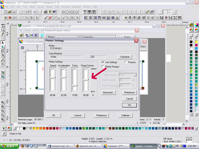

In Omega GSPPlot, press the F7 key > Settings to open the Plotter Settings screen. Adjust the slider for More or Less Sharp Corners. Make sure that the Use Settings box is checked. Do some test cuts until you have it as you want and then save the settings as a preference.
These settings will be different for each type of vinyl, so you will have to adjust and save as preference for each.
You may find that Speed or Acceleration settings will have an effect on your cornering as well.

Omega treats the Graphtec cutter as a simple HPGL cutter. No special feature support, etc. If the cuts were good at one time and now they are not I'd be looking at the cutter (blade), not the software.
The difference in the software maybe in the way the software "breaks" down the curve data into small "chords". I believe Gerber uses a chord derivation (error) of .0005", the small that number the more data / segments, the larger that number the less data / segments.
