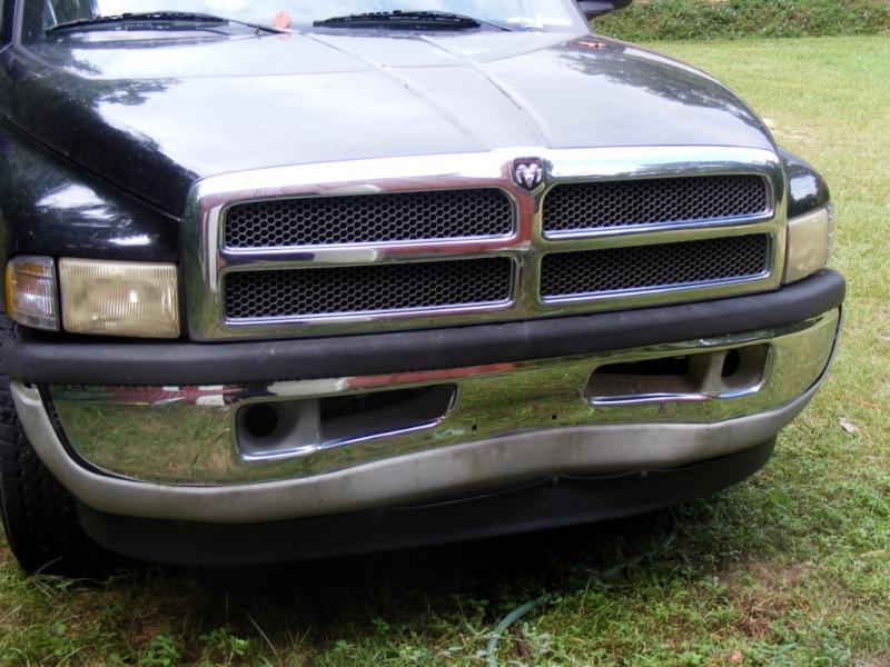

A LITTLE EXCITEMENT............but bummed out cause i rear ended a car last nite!!!!!!!!! $166.00 ticket for reckless driving, but the problem was actually MECHANICAL FAILURE..........i hit the brakes, in plenty time to stop........but the peddle got really hard, i heard a "POP" under the hood then i pushed the peddle to the floor then BANG!!!!! I HIT THE CAR IN FRONT OF ME THAT WAS STOPPED!!!!!
so today i will spend time on line filling out the accident report to the insurance co, taking the online driving school so i dont get points added to my license then i have a mechanic freind of mine who is coming here after he get off work today to access and diagnosis what happened to the brake system. then i will have to replace the front bumper at a later date.

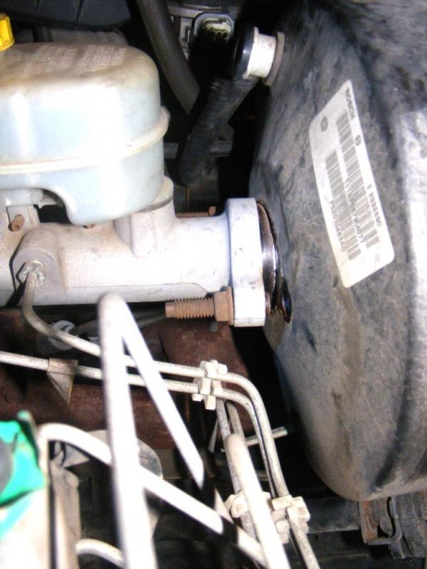

my mechanic friend came by a little while ago to diagnose the problem with the brakes. i was right MECHANICAL FAILURE!!!!!
the whit thing to the left is the master cyl. it is BOLTED TO 2 BOLTS that are PERMANENTLY attached to the black round can, which is the power vacuum booster. when the bolt pulled out the black can i lost the vacuum boost for braking....reason i lost the brakes!!!!!

You might be surprised but you may just be able to pull your bumper back into place. Unless you have some kind of law that says to replace it. On the other hand if your going through your Ins. Then I wouldn't bother. On the up side you still had brakes but you had to use them like you were driving a 1970 dodge lol. Ah remember the days with no power steering, no power bakes and the three on the tree........kids these days have no idea...
Glad your ok.

OP you are the luckiest unlucky guy around. It's a good thing that didn't happen on the freeway going 80 or 90.
You lost more than the vacuum booster (you can still stop a vehicle without assist) you lost most of the connection between the brake master and the brake pedal.

glad your ok .. yes you live near the coast, rust plays a factor, plus your power booster was probably on it's way, putting more strain on bolted area.
OldPaint
this truck is virtually "rust free." for a 1999, and 99k on it. i do all the maintenance as needed before stuff brakes. have original rotors, same rear brake shoes as when i bought it with 63k on it. replaced pitman arm, idler arm & ball joints with in the last 2 years. so i keep up with mechanical problems befroe they get really bad. in all of my years of "turnin' wrenches," ....and been doing that since i was 10-12 years old....working in the automotive parts business for 15 years .........NEVER EVER have i seen this happen. those 2 bolts are WELDED on the inside of the brake booster!!!!
