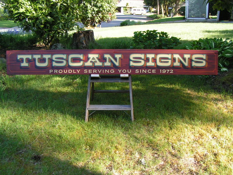

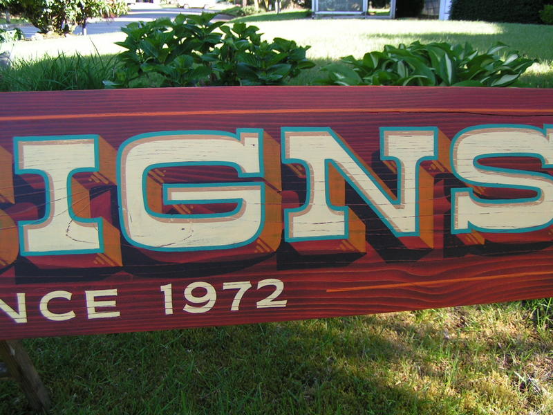

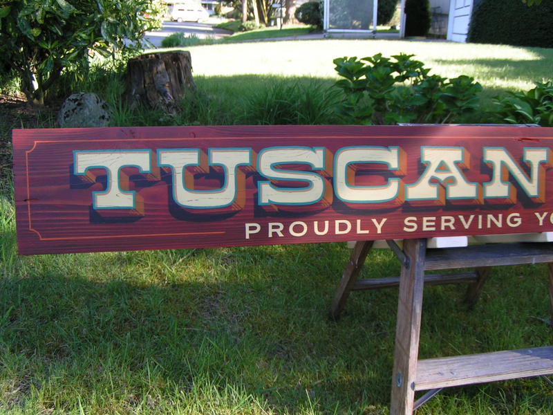

Here's a hand lettered piece simply for fun, exercise and therapy ...romancing the brush again and utilizing a technique called "Mock Block" which has recently been taught to me by one of my mentors (John Downer).
"Mock Block" is the name of a sign painting technique for achieving the appearance of three shade colors by applying only two. The background color serves as a separate segment of the shade, when the construction and color assignments are well planned. - See more at: http://www.mapdays.com/list/event.asp?ID=2432195#sthash.cNU7Uqb4.dpuf
This piece is an old pine board with enamel rubbed finish and hand lettered with 1-Shot lettering enamels, finished with a coat of MAN O'WAR Satin Spar Varnish. The shadow effect ("Mock Block") is a style of shadow that is seldom seen today in any form of signage regardless of the process of creation. I hope some find inspiration in the style.

oksigns
This is beautiful! I never knew the name of this technique, but there is a similar effect under illustrator/indesign.. this just makes you appreciate the craft so much more. Thanks for sharing

Note that the underside flats of the "Block Shadow" (in the above sample) are the same color value as the background and are enclosed by the Purple colored "Cast" shadow.
In the pictures of the hand lettered piece I posted, the bottom flats of the block shadow are nothing more than the wood grained finish background showing through without any added color to that portion. That portion of the block shadow is enclosed by the Black colored "cast" shadow.
