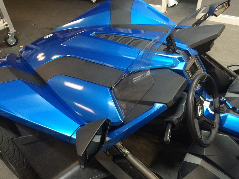

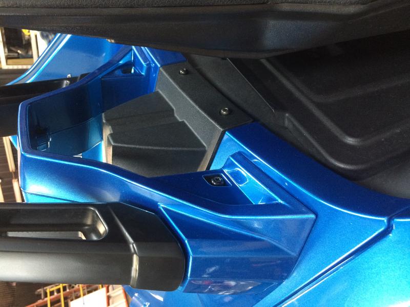

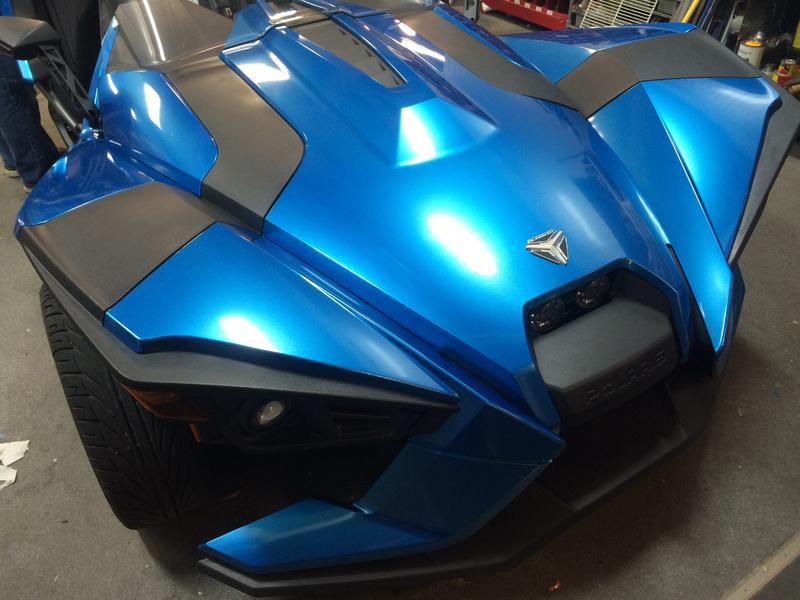

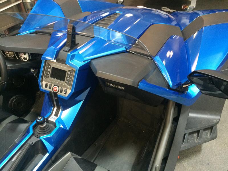

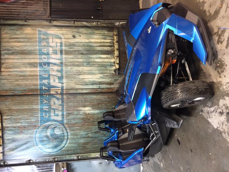

We wrapped this Polaris Slingshot in 1080 gloss blue metallic. There were so many pieces, and was so cut up. It was a real pain. But the end result looked amazing!
We charged $2400 for it. We have about 5 hours total in disassembly and reassembly. And 12-13 hours in wrapping it. We used about 20-22 feet of vinyl. I priced it to what I thought was a little high at first knowing it would be a big challenge, glad I did because in the end it worked out about right.
