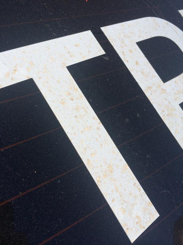

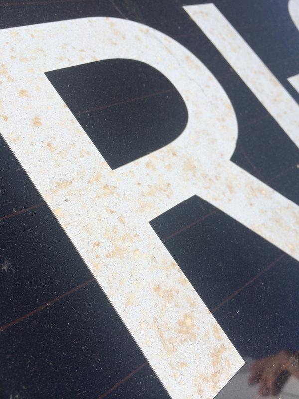

A few months ago we put some Oracal 651 on the back window of one of our customer's cars. Yesterday he brought it back in because it's starting to discolor?
It's on a dark back window that's angled up so it's facing the sun, so I'm wondering if this is some sort of burn that's happening? We tried cleaning it with water and alcohol, but both did nothing. It's seems to be the material itself.
On the same window we had a piece that was printed and laminated (Oracal 3651 with 210 laminate) which doesn't have any discoloration at all.
Is the heat just too much for the 651? Should we re-do the whole window printed and laminated?

we have used 651 on slanted / tinted glass here in TX and have not seen that issue before, especially in the time-frame you are listing.
I'm an curious how old the 651 roll is, I'd also ask how the vehicle was cleaned after vinyl install, or where it was parked, looking at the glass there appears to be debris, is that tree sap / pollen? which I have seen do funky things to vinyl

Another thing to consider - maybe car was parked under trees and it got tree sap etched right in the vinyl? I know that would need a lot of tree sap but you never know. See it a lot on car's clear coat when we are doing PPF

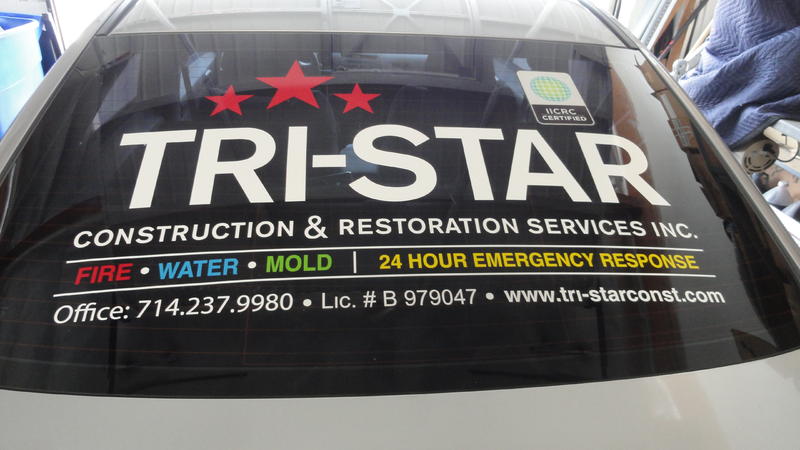

I don't have a pic with he discoloration all in one picture, but here is after we installed it at first.

I'm pretty sure the white vinyl was ordered in the past year at the latest. The other colors (red, blue, green, and yellow) maybe be older, but they're all showing the same problem (though it's more obvious on the white)
The customer says that it was parked in the sun, and not under any tree or anything. I didn't ask about how he's been cleaning it. There's dirt/dust in the first pictures I posted, but after I took those pictures, he went and got the car cleaned and came back. The discoloration didn't change at all.

Looks like oak tree pollen to me. Stuff gets stuck over our cars like crazy when we go up to the lake. Gives a yellow/brownish look. Won't come off to save your life. Hours of claybar.

we use 615 extensively. I have never seen this before. I'm 99% sure this is an external stain of some sort. Be it sap, pollen, road grime, etc.....

Look at the glass. There is just as much garbage on it as the letters. He parked under some type of tree that is causing the staining. Not your fault.

Put some rapid remover on a paper towel and try wiping off the stain in a small area, if that doesn't work, try some printer cleaning solvent on a q tip, another thing i always try is soft scrub with bleach, if you show the customer it is a stain, (and it most assuredly is a stain) then it would prove it has nothing to do with the lettering job, I wonder if it is the soap that rains down on the car from the car wash. Or most likely something from a tree. I recently had a pipe drip something on my car from a parking garage while visiting a Pgh hospital, whatever it was got on my paint and windshield, I used everything I could think of to get it off, and turned out Murphy's oil soap took it right off. Good luck

I have had a look at the pictures and have used 651 for a number of years without issue.
But maybe the issue isn't tree sap or heat issues, it is maybe the chemicals that they are using in his line of work.
Just look at what he advertises he does!!!!
I would take a close look at the paintwork of the vehicle. I would bet their is something similar happening on it.
