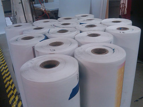

The current project and main reason we bought the machine will keep the machine fed 24/7 until April with a total of 850,000 s/f of print. The requirements for the project would not allow Solvent or UV cure printing as we have done in past and Latex was the only way to do it and meet requirements.
http://www.piworld.com/article/merr...ntal-demands-hp-scitex-large-format-printer/1

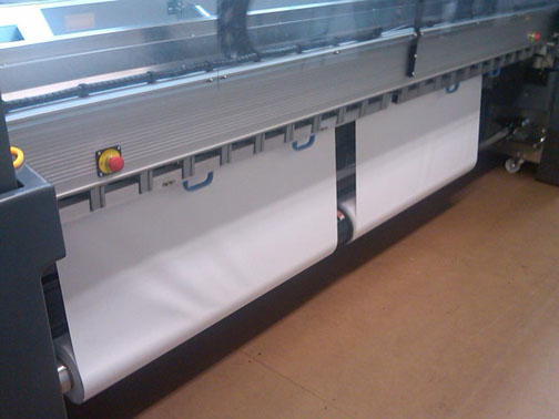

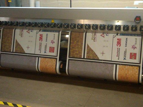

This project requires to print 2 rolls up of 51" x 450' foot media.
The dual roll system on the LX is not as user friendly as some of our other machines and takes a bit longer to web up also. It is also very particular to the weights of materials. Part of the problem is on our end using such big heavy rolls the other part of the problem is the differential system on the dual cores which could and I am sure will be upgraded over time.
The quality coming off machine is amazing but speed is slower than what we have run this job at in the past on our Vutek. That is the trade off we went from running at 1800 s/f/h to right around 650 s/f/h on the LX. With that being said we did get 6 extra weeks to meet this deadline.

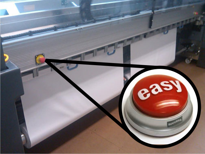

All in all the LX and latex technology is great and we are pleased so far. The machine is also super easy to run and way less of a learning curve than any Grand Format machine we have ever had. My 3rd shift LX operator guy never ran a printer before just did finishing. He was running on his own with no issues in 2 days...

good grief how are you finishing all those banners?
Zund Cut and bulk packed on 4x8 skids and then packed into 2 shipping containers. No other finishing needed.
