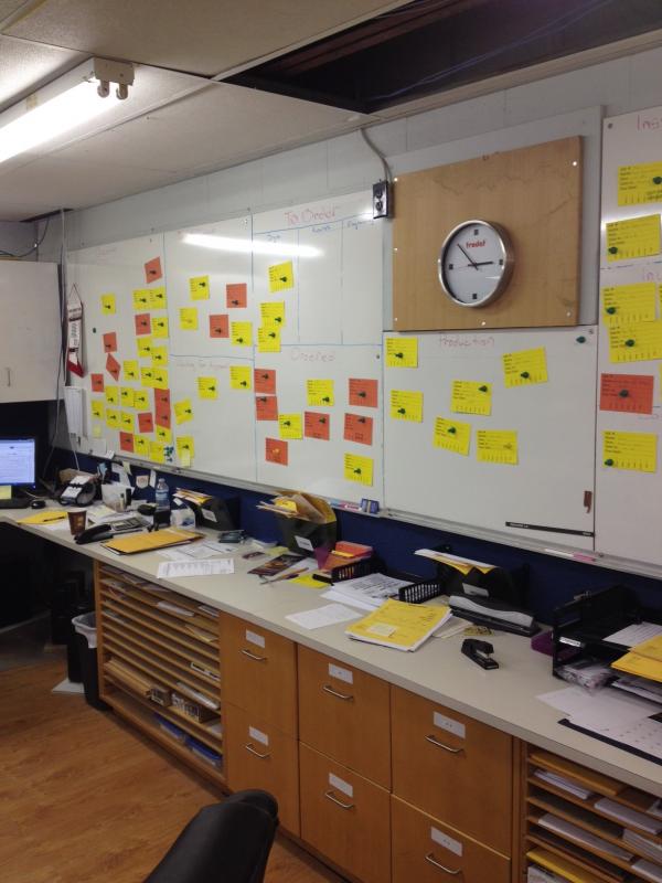

about 5 months ago we implemented a card system, every job gets a card filled out with basic info (customer, job #, job description, due date) the card travels through the different stages (quote, design/proof, order materials, production, installation, invoice) there is a paper work order that has all the details of the job that go in a bin under the job stages on the board, when the card moves, the work order moves.
So far it has worked well, you can organize the cards on the board in order of importance, so employees don't just grab jobs they "like" to do. it's the employees job to move the card through to the next step when they are done with their portion of the job.
I looked into a computer based system, and in the end, we chose a paper based system as well, it allows me to easily sketch a drawing or write little notes on the jobs that I feel wouldn't get done if I had to type everything into the computer. Plus some of our owners/employees are not that computer savvy, so I would be playing "computer guru" alot.
