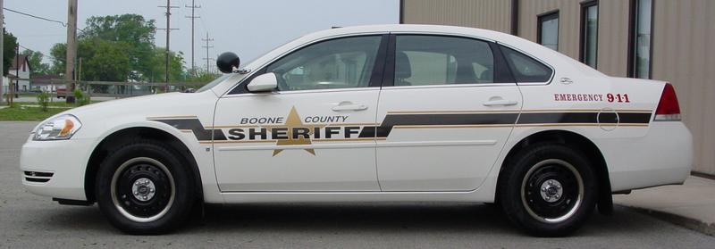

Old design . . .

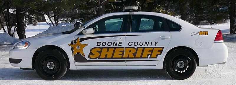

New design . . .

I think it's a vast improvement, except for one thing. The 'Call' being in a casual, just takes away from the fact that it's an emergency number. Regardless if you know it or not, it just doesn't sit right with me. Aesthetically it works, but just not the emphasis.

I would have taken the black swoosh into the front panel by itself and left the badge unbroken on the door panel

That was exactly my first thought also. To me, using a casual typeface for a message of priority does seem a bit peculiar. It looks somewhat aesthetically pleasing, but out of place at the same time. Leaving it to say 911 alone would suffice.
All around it's a really nice layout, but I think I would have gone with a beveled look on the SHERIFF lettering. Adding a highlighted bevel to this would help to up the contrast, make it a little more interesting, and a lot more three dimensional. The overall flow of the design looks great on this body style.
TimToad
Overall, its a vast improvement from the previous design.
I'm also in the drop the Call text camp. Its not a plumbing outfit coming to roto root your septic tank.
As a former 911 dispatcher, brevity is crucial when one is flustered or a caller's nerves are shot. The 911 could be a bit bigger and for some reason I'd love to see the Boone County right justified over the word sheriff. That double space you have between those two words just leaves me hanging onto Boone too long without a nice flow into County.
I'm not sure in fiscally conservative Indiana, if they'd justify any kind of convex or bevel treatment for the word Sheriff, but it sure would look cool if they did.

Nice Job, I like it - BIG improvement!
So, is this all cut vinyl?
Did you use reflective?
Details please..........

In 1998 our Sheriff contacted me and wanted to know if I could come up with a new look for the county squad cars. Their current cars had a single black (brown) reflective stripe with a gold reflective stripe above and below it along the bottom of the cars with a “badge / patch” graphic on the front doors. A former officer applied them.
The catch with regards to the new design, someone inadvertently ordered (1) case of the 3” black reflective instead of (1) roll. (12) 50yrd rolls of 3” black reflective at my disposal. “We need to come up with a design using this tape . . . we don’t want to waste it”
So the “old” design shown is what I came up with. Many, many, many of the first cars striping was all hand cut out of that plethora of 3”rolls.
This past December we had a changing of the guard. Our Sheriff of 38 years retired and the new Sheriff inquired about a new design. The two guide lines I was given. (Along with some reference photos) A large badge and large “Sheriff” is what was requested.
I continue to find it interesting that when you post photos of finished jobs here, people suggest changes. It’s finished . . . this is “their” new look.
I don’t mind critiques . . . as they say there is more than one way to skin a cat, but I think some here just look for something to pick a part. Plus fortunately we all have our own tastes . . . that is what makes the world go around.
That said I will respond / explain some of the thoughts here.
The “Call”; I submitted (3) layouts (2) with a more “professional” look, this one was unanimously selected. Personally I tried to push to have it eliminated altogether, I think it is unneeded.

“I would have taken the black swoosh into the front panel by itself and left the badge unbroken on the door panel.”
"I'd love to see the Boone County right justified over the word sheriff. That double space you have between those two words just leaves me hanging onto Boone too long without a nice flow into County."
They wanted the badge and Sheriff as big as possible, no way to do that and avoid the body panel gaps. I will be using this design on several different vehicles. While designing this I had the layout on a Dodge Charger, Durango and Caravan, along with a Ford Explorer and GMC truck. All of which this design may end up on.
The double space helps avoid the gap between the doors throughout the different models and sides of the vehicles. The different configurations and sizes of doors and fenders make it impossible to avoid gap for the badge area while keeping things “big”.

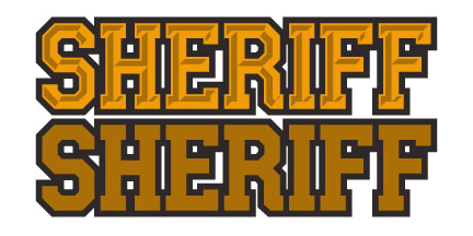

“I think I would have gone with a beveled look on the SHERIFF lettering. Adding a highlighted bevel to this would help to up the contrast, make it a little more interesting, and a lot more three dimensional.”
“So, is this all cut vinyl?
Did you use reflective?”
This is cut vinyl (Oracal 951 brown / 3M yellow reflective)
I’m very confused as to how a beveled edge would “help up the contrast” I still prefer cut vinyl on these cars, (many are on the road here longer the I think printed graphics would last) and all it takes is a search online or a simple look around to see there are more than enough Police cars on the road that are hideous with fades, poor layouts and really bad color choices.
I know I said we all have our own tastes, but there are so many I see that are flat out illegible.
Again, I am not opposed to the critiques but this is a finished job. Approved by the Sheriff department and receiving great reviews from the local citizens . . . I can live with that.
Thanks for the positive comments as well !
This is what I was referring to.
Obviously not this font, but just this idea. This is my own personal preference.
