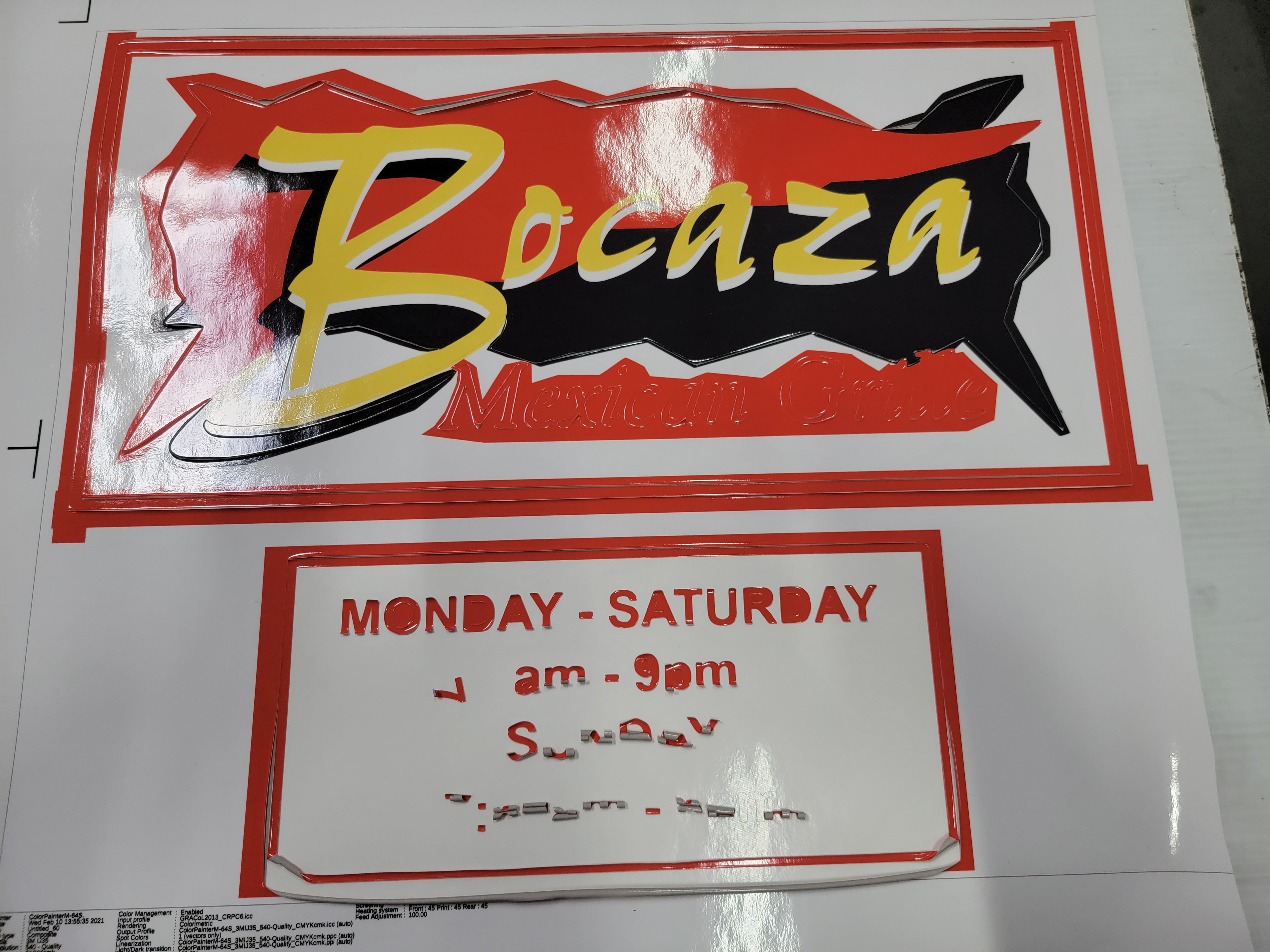

Hello all,
Just wanted to get everyones thoughts on this curling as I'm almost 95% sure that this is because our operators didn't not let it sit before it was laminated. Not to mention they weeded it and didn't apply premask (also left over night ). What say yee! :)
Material IJ35
Printer: Seiko M64 - Solvent
YHEcdaozxEfF8FaH6
Armando
MikePro
possible outgassing, as stated above, BUT could be as simple as too much tension on laminate feed....stretching the laminate as it applies, and then wants to curl-back when contour cut.
Joseph44708
I Drink And I Know Things
Yes. Cut while the ink was still wet.
Yes.
Cut way to early.
I have found when running large solids on solvent printers the ink and heat softens the vinyl, so it need extra time to cure (out gas) especially when cutting into the bleed.
I've seen that happen, but not that quickly. Wrong profile for the media and cut too soon. Seems like no one in your place knows what they're doing.
Basically the wrong use for the machine vs. your needs.
