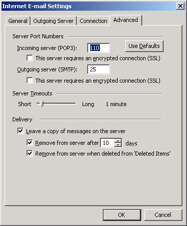

go under tools, options, mail setup, email accounts, view or change email accounts, next , >select the acct name and click "change", go to more settings, and window pos up like attachment , and those are my settings on the screen and have no problems.
May want to leave the delete from sever one unchecked so you emails don't go bye-bye if you don't check them for a while.

Can you access your email through your server? The problem seems to be that your old setup left a copy of the email on the server, so the new computer considers all of these new emails since it's never seen them.
If you can access online, then you can delete the emails that you want there... if you aren't sure contact whoever your email is through to find out how to get to the online control panel for the email.

i would definitely contact whoever runs your email account as bigdawg said, the messages weren't deleted from the server.....that helps if you have and email program setup at home and want to still be able to download the emails at work but not if you're on your primary computer

Flame you should be able to get to your isp email through webmail. once you get there you can delete all the old email you do not want to download.
