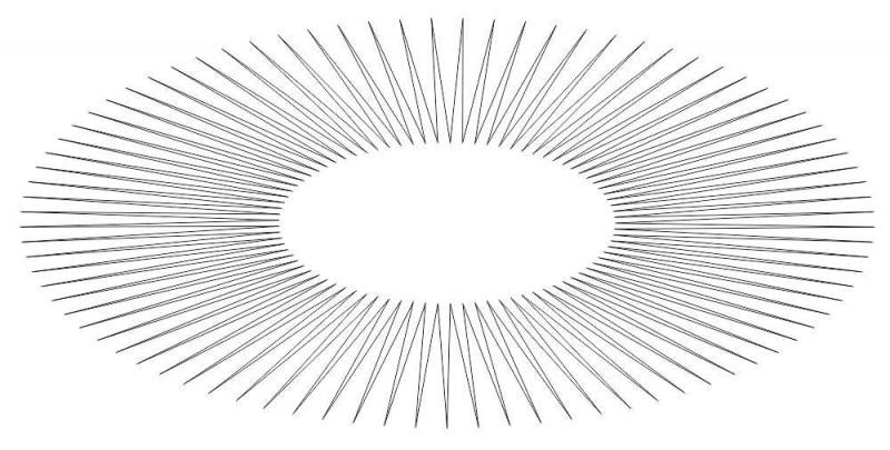

Are you aware of any feature in Illustrator, Gerber Composer or any vector based program that will automatically generate equal line segments around the circumference of an an oval?? I need to create a star burst oval with equal distances between the points.
Thanks in advance

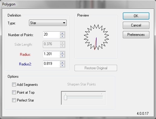

maybe im missing something but why not just used the star tool click once and select however many points you want?
John Butto
is this what you are looking for...make circle with lines or triangles and then transform to oval? These are not evenly spaced but they look like your sample you are trying to acheive in Illy.

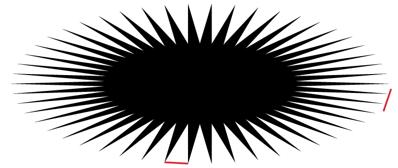

rjpjr
maybe im missing something ....
Yep, I think you are.
Using the star tool in either Illustrator or Composer will create a star based on circular geometry.
There are no options available to create a star based on an oval.
Creating a standard star pattern and stretching it will result in unequal distances between the points around the circumference.
I need these distances to be equal.
Thanks for looking though

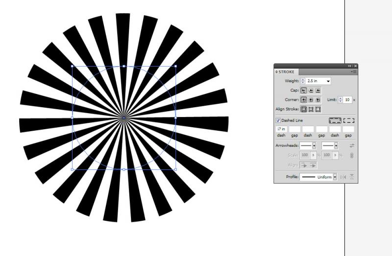

You can use the dashed line tool on the object's stroke in Illustrator to achieve this. The only hang-up could be the distance between the initial point and last point; otherwise that will get you where you want to be.
Sorry! I completely misread what you wanted to do.... that's a sunburst, not a starburst. I don't know of a way to do a "perfect starburst" like you're wanting.

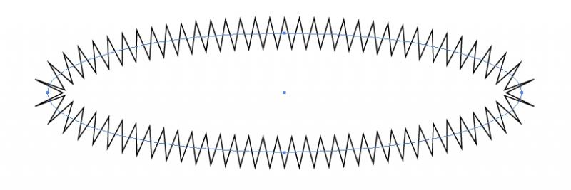

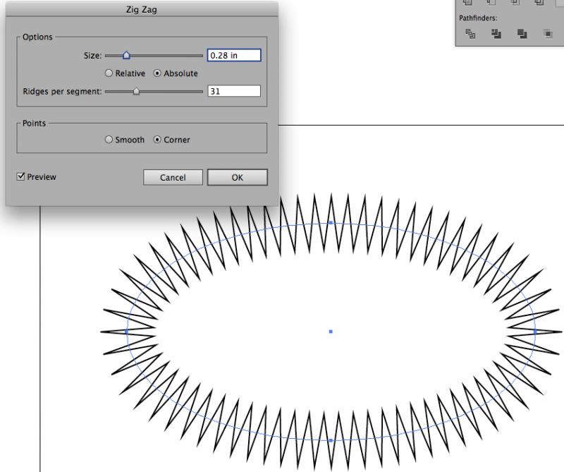

zig zag
the zig zag tool will get you rather close to what you want

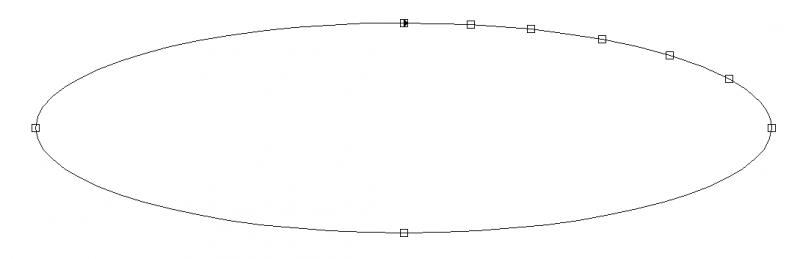

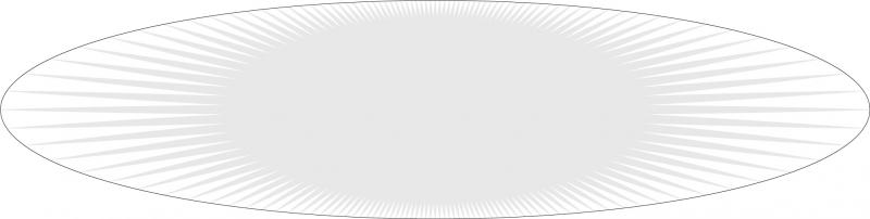

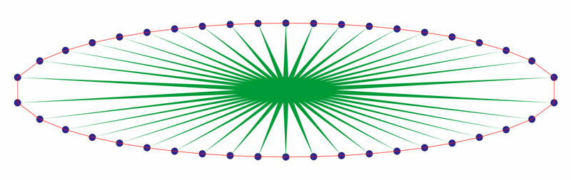

It looks like you could do it in Corel.
The end result is what you asked for but it looks odd.
I used a blend on the oval path to evenly space the blue dots.
Drew a new oval snapping each segment to the centers of the blue dots.
Doubled the points evenly on the new oval (+ key)
Selected every second point,
Used the scale node tool to bring them down into the center.
