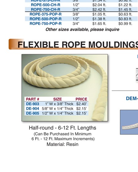

Look through Outwater Plastics molding section. They specialize in flexible molding stuff like that. They've even got flexible rope molding with looks pretty damn cool.
