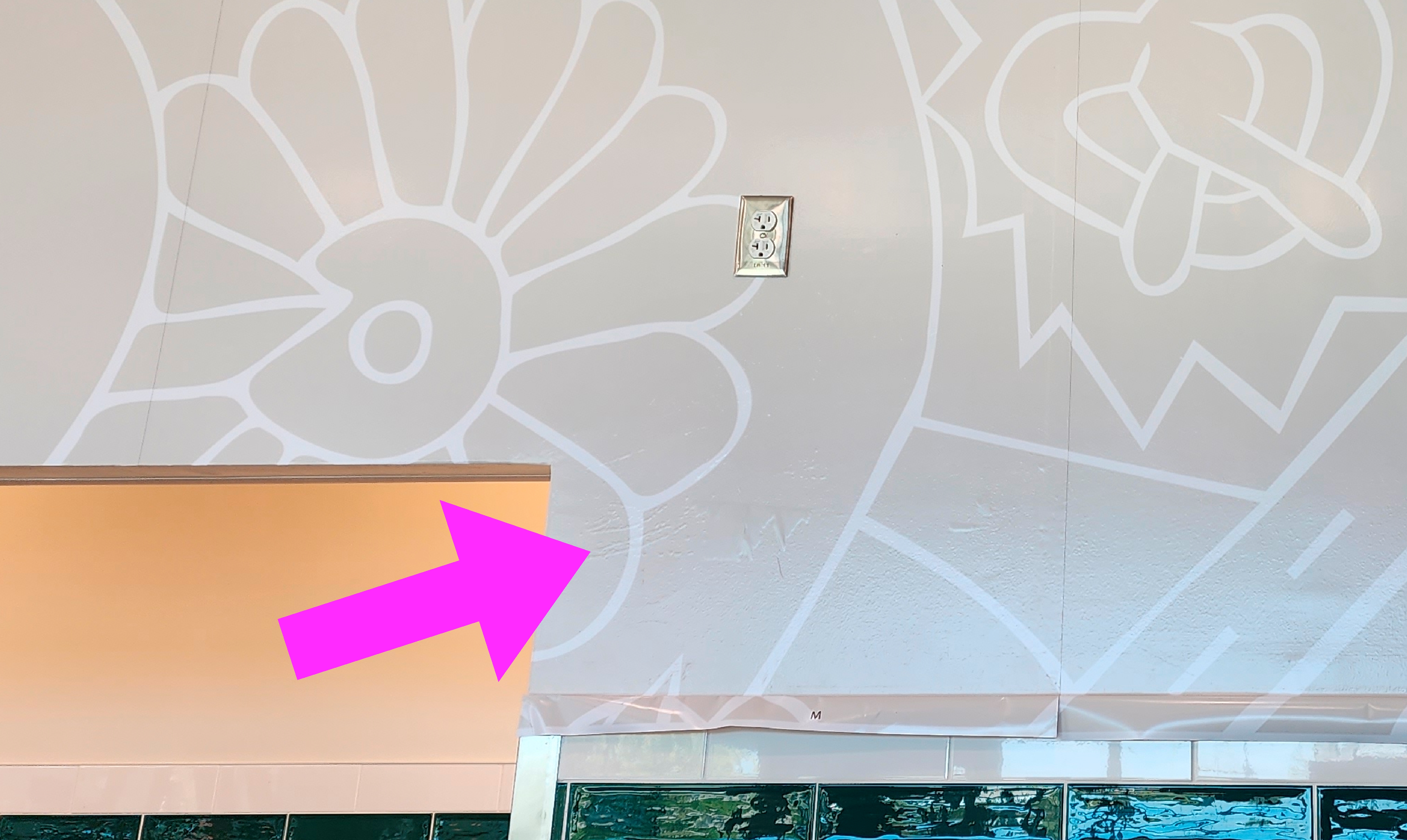

I was wrapping an interior wall when large patches of paint would get stuck to the vinyl and ruin it. Obviously when the paint stuck to the vinyl, it looked wrinkly and bad in those areas because it did not stick to the wall. I can try everything possible to not have vinyl accidently touch the wall before applying it, but sometimes it's unavoidable. The paint was on the wall for 30 days prior to me installing. Is this a problem with the paint prep or should I be super cautions not having it the wall? What happened here is the bottom curled in and trapped a tunnel of air and I immediately pulled it off but it grabbed a GIANT chunk of solid paint with it.

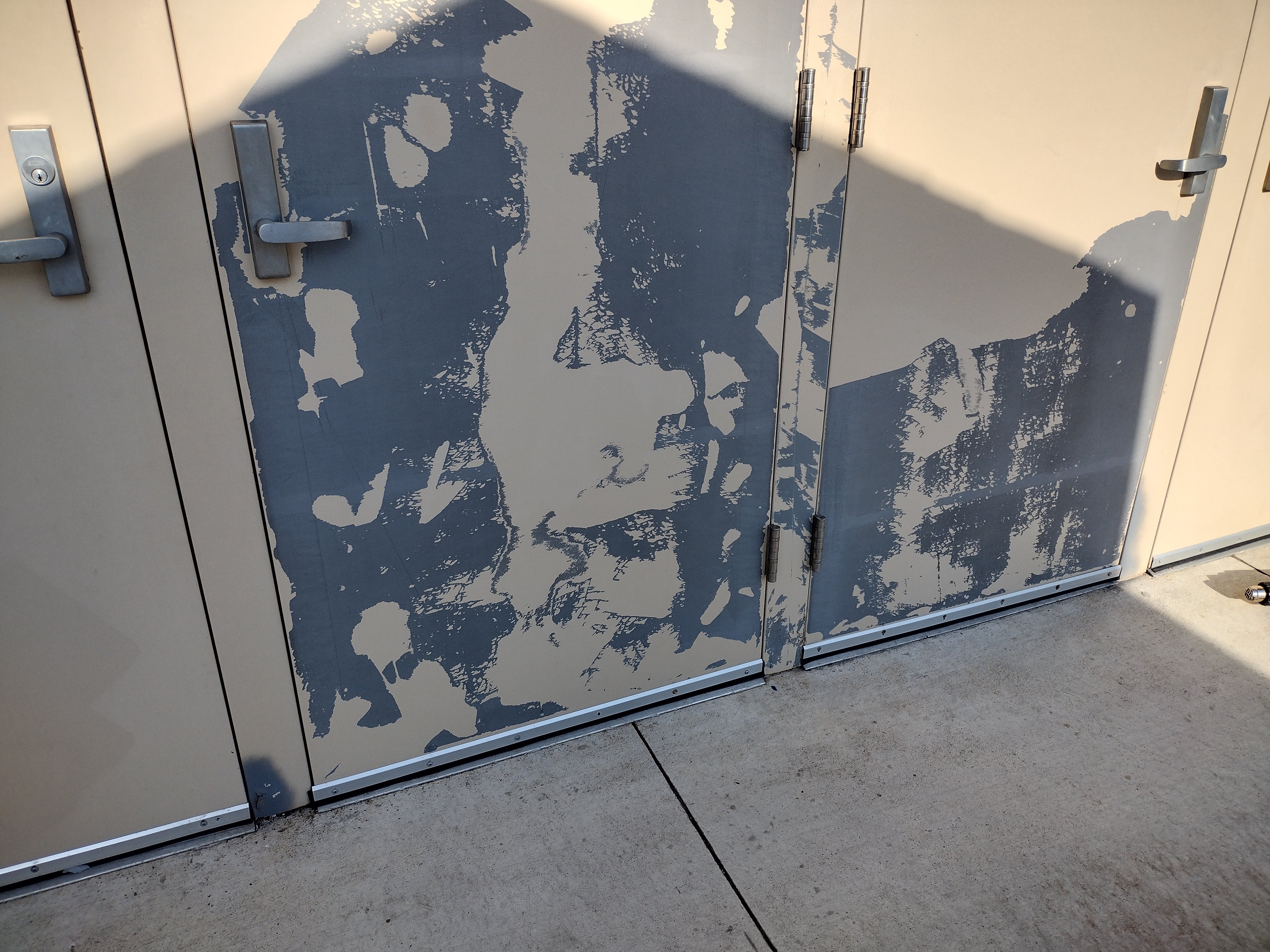

Was doing some doors at a school, doing the 2nd door, the vinyl started just coming loose on the first one... Wasn't the vinyl, pulled it off and this ugliness happened, took all the paint with it. The doors were peeling so they painted them over the summer, they put a nice coat of latex over the oil based primer and paint that was on it without a sealer.
That's what ours looked like. What a disaster

Same idea I had. I told the business owner to hang his licenses there and he agreed.. There are other areas where we can't cover that I didn't take a picture of those.

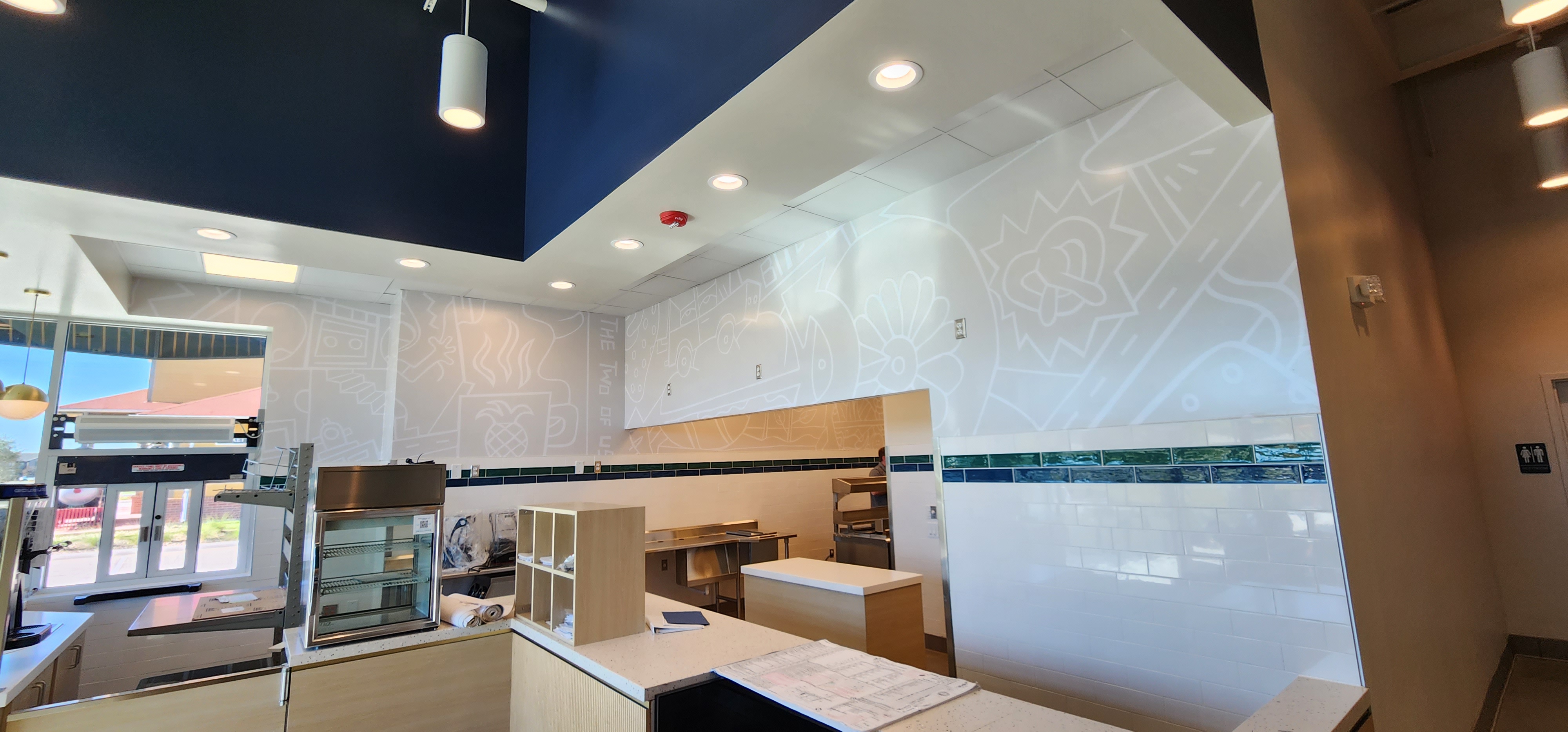

I'm not a fan of the design.. but then again I aint the one paying for it.
