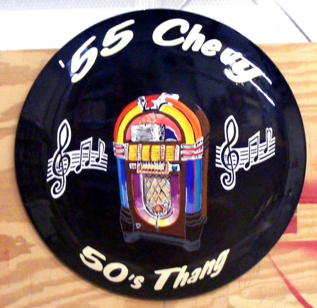

iam with signbrad........IF YOUR GOING TO PAINT THE LETTERING. also i dont think your the guy to do the overall painting. SUB IT or let the owner pay a painting contractor...i would also make sure they use a good high gloss paint!!!!
getting it painted ALL WHITE....... is the way to go here. paining white letters over black background would take 2 full coats for sure. it you paint the background around the letters in black....1 coat will be it.
if your gona hang vinyl on it......still paint black in high gloss. this was white and i put vinyl letters on it then panted the black...
