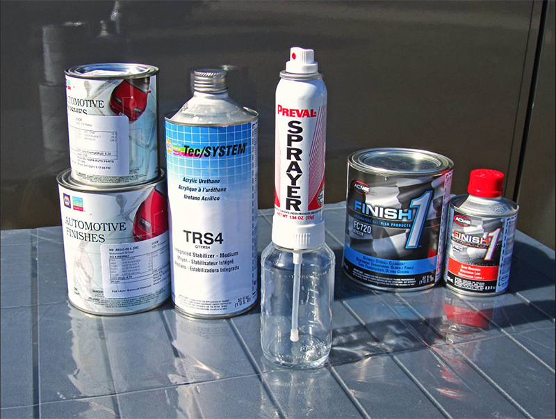

Like I said, you can mix your own and use one of these................
Get 'em at Home Depot. I get dozens at a time. They're cheap enough and you can use any paint base you want.
Oh yeah, most paints are about 4 to 1, while latex is about 3 to 2.

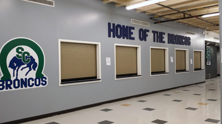

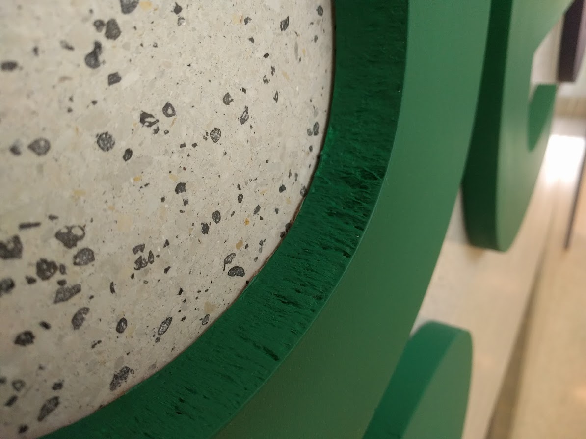

We just use a roller and flat latex - a couple of coats if I recall correctly, and a third on the returns. The picture is a recent(ish) job using 1" Ultraboard - the letters were around 18" high.

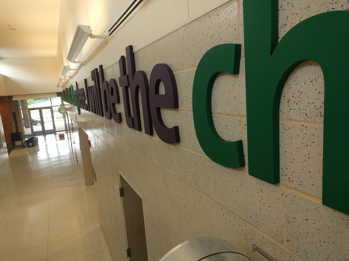

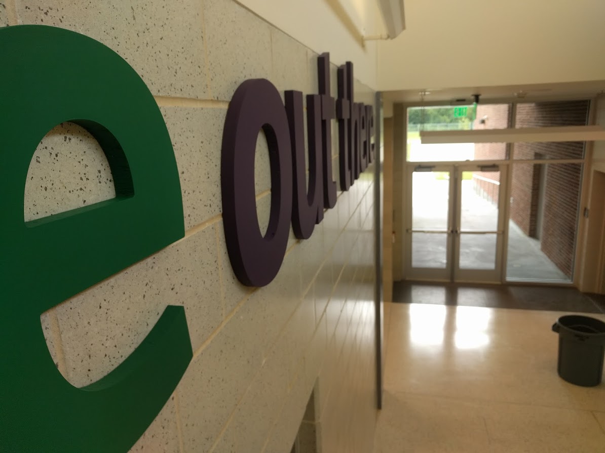

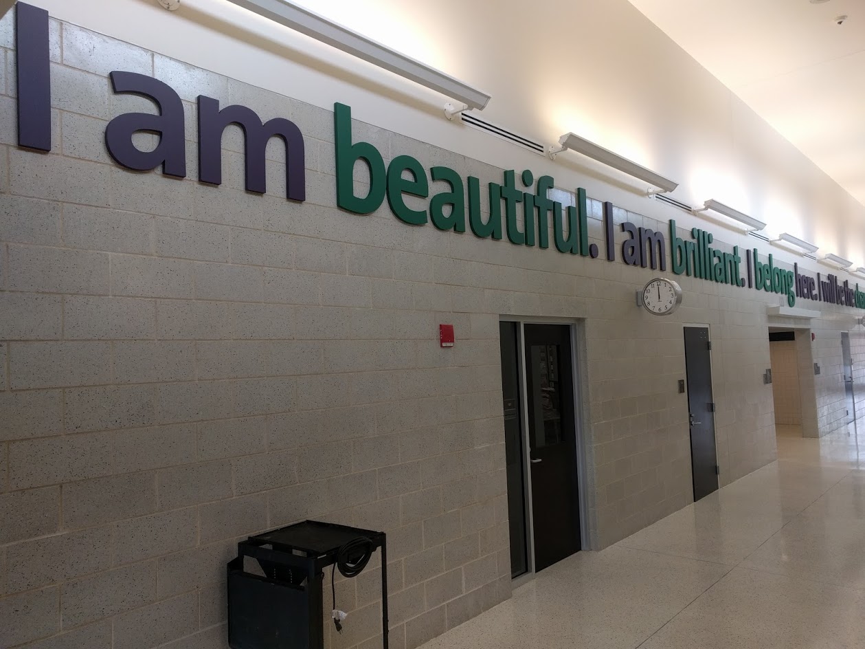

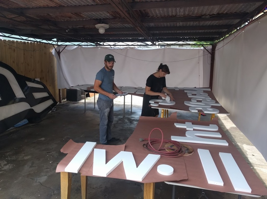

The job is completed.
white 1" Ultraboard
Primed with Kilz2 Latex, sanded edges only 180 grit, two times
Painted with Sherwin Williams flat latex, applied with Graco True Coat
Installed with double-sided tape and silicone
