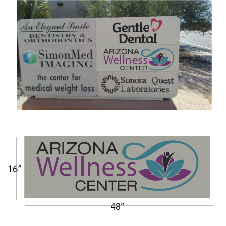

So I have a customer who wants two aluminum panels on a marquee sign changed out and his logo added. The existing signage background is colored so I need to paint the panels the same before I apply the vinyl. The problem is that the manufacturer of the aluminum product seemed to think the white aluminum blanks might not hold any paint that is applied to it. So does anyone have any suggestions where I can get my hands on 48" x 16" blanks that are paintable with no risk of the paint peeling right off or if anyone has applied paint to white aluminum blanks and how you did it? I have attached a sample for the sign. Thanks

There should be no problem painting prefinished white aluminum. Scuff lightly with a fine pad or wet sand, clean & paint with a good oil base enamel (or acrylic polyurethane if you can).
The only good way is to do a proper spray on it. Otherwise, just cover it with vinyl the correct color. Or have a digital print done on vinyl, laminate it and then put it on new aluminum. That old stuff is problem not worth using anymore.

That's basically what I was thinking so I was surprised when the manufacturer said they would recommend against that.

I agree with Gino... Cover with whatever color vinyl you want..shouldn't take more then 10 mins and cost $10 in material.... or just print. New metal shouldn't be more then $40...covering old metal won't look clean and smooth.

I agree with Bill, clean off decals and residue, scuff lightly, oil base metal paint.

I would except the old panel was engraved and not overlayed with vinyl so its not able to be used. And I cant seem to find any vinyl that matches close enough to the paint. Any ideas on how to match the color of paint by printing without having to have several samples printed first? I dont have my own printer.

Print a CMYK color swatch chart. I know in Flexi you can make one easily. I made it and ordered a 1'x1' from Signs365 and it's gets me pretty close.
equippaint
Painting it is more work than its worth, are the existing ones painted or just faded? They don't seem to match too well as they are now. You may have better luck getting a full print to match than you will be going back and forth with a paint match.
If you must spray it then get white aluminum, scuff it and paint it. It will stick to a coated surface.
