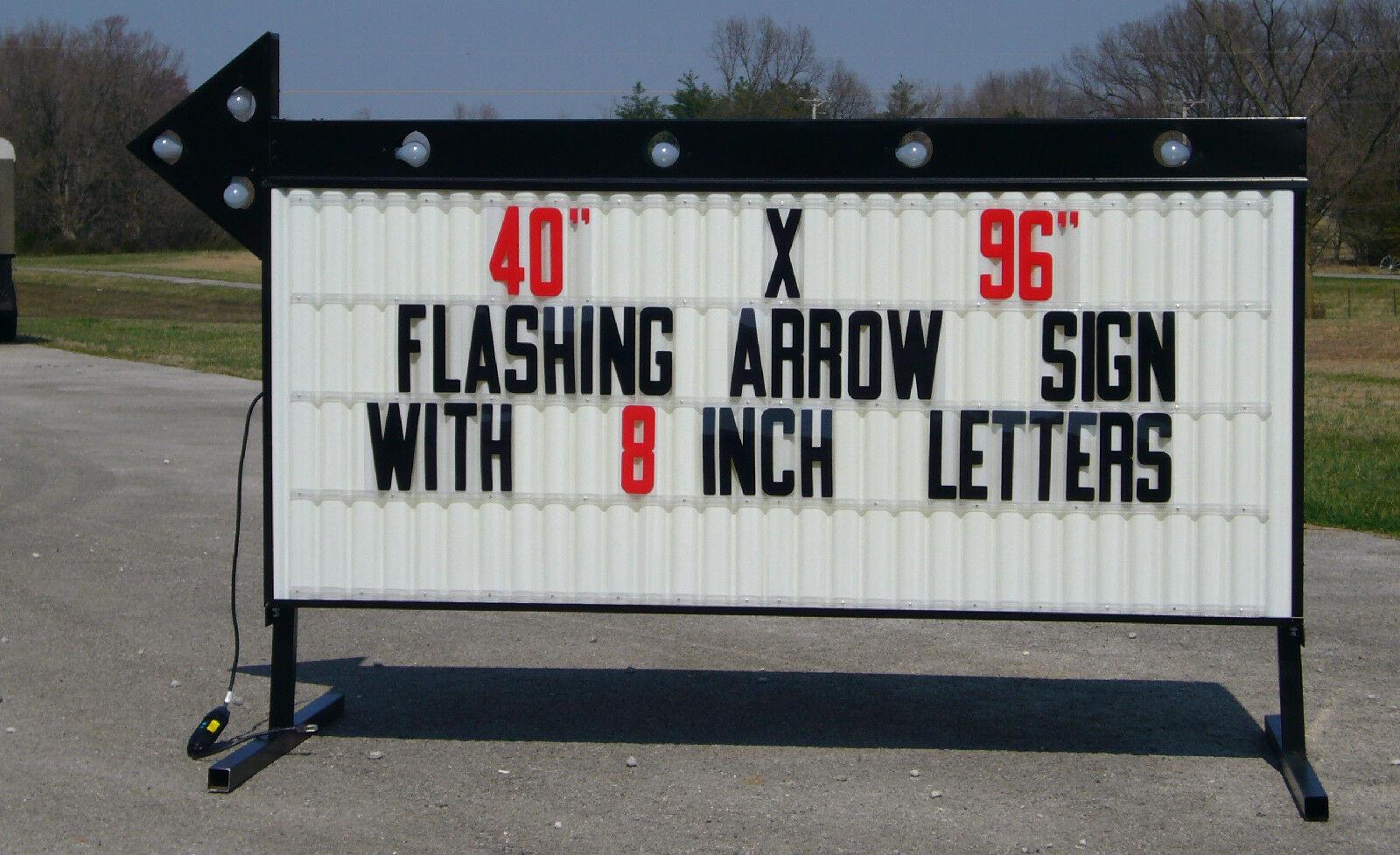

would anybody know the exact measurements for these road signs? (panels only)
customer wants to replace them with plexiglass, i misplaced my notes, i do remember they were like 38.1/4 in height and 96" wide
sign is like an hour away, just want to save myself a trip
thanks

Replacing the face with acrylic isn't going to be so easy. The channel is wide to accept the corrugated face. A piece of 3/16" acrylic is going to flop around like a fish.
Not to mention, who in their right mind would wanna use a $200 cabinet to make a new electric sign ?? The can is so thin, they'll have hot-spots galore. Hey, maybe they wanna put LEDs in it and really spice it up.

We have some very OLD ones still here. Can't promise yours is the same size, but ours takes a 39.5x95.75 panel and the channel accommodates a .75" panel.
