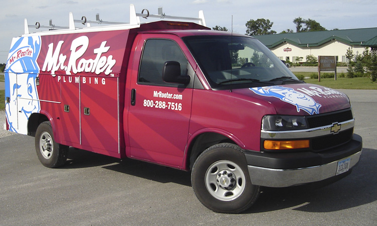

I Google image searched Mr Rooter (we must not have them here as I've not too familiar with them) to see what you guys were talking about. I don't care for the branding and execution. In my view, the problem with it is that it really looks like it hasn't been updated since the 50's. The guys head really looks like bad clip art, and the script for the brand name - I dunno - just does't work well for me.
On the flip side, I'm sure they stand out, which was our objective as well.

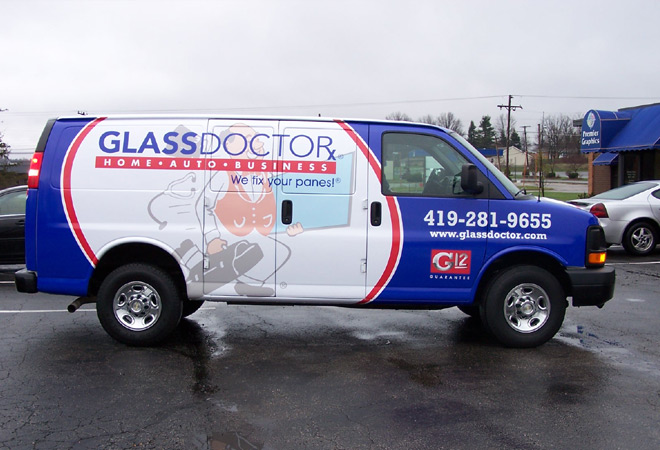

dan, one thing for you to remember, if you do that as a partial, its assuming the client has a white van. they may right now, but all my clients are buying surplus DHL vans that are yellow and we are wrapping them.
with a different base coat other than white, a full wrap will be the only option. just a thought.
we do glass doctor wraps which are also very similar. its owned by the same company as mr. rooter. your wrap is litteraly a combination of the two. the last two we did for glass doctor were yellow DHL surplus vans that were full wraps and looked partially like your design.

looks like the mr rooter design.
I agree, very similar to the Mr. Rooter wrap, as they say, there is nothing new under the sun!
However it is a good clean design, colors look good.

I think Glass Doctor is nothing at all like my design. I think it has some basic layout problems. The watermarking of their brand icon is really odd. This could have been much more effective if the type was stacked, and icon not watermarked. Optically, there's a hole back left. Now stack the logo, and remove the watermark and make opaque and smaller, and it's much more visually balanced, and effective.
signgal
I agree... isn't there some law about not placing text or logos over character faces? Well there should be if not...
