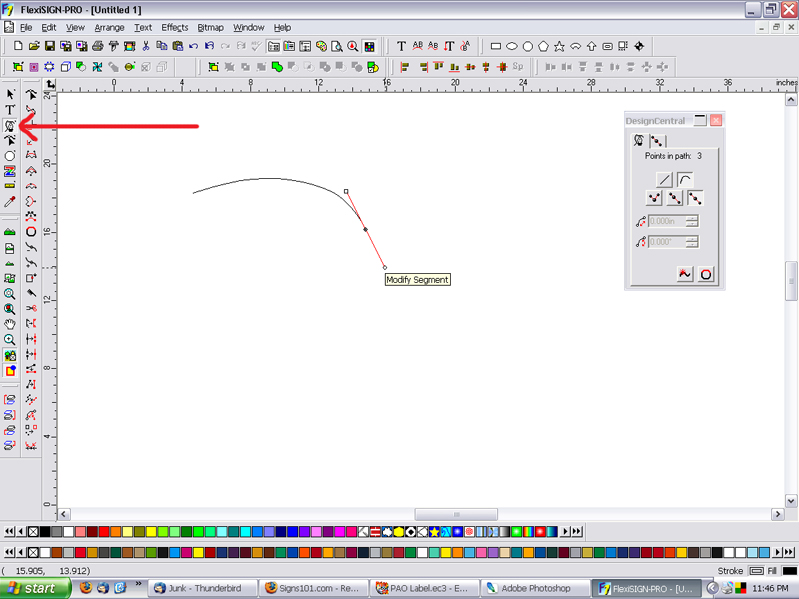

Okay I'm more savvy in Photoshop, and do my designing on Photoshop more than Illustrator, do I have to ALWAYS make paths? Whenever I make a selection as a path it cuts through some curves of the image. Is there an easier way to turn a rastered layer into a path?

I do I have a software for cutting. It's Flexi. But I'm not familiar with the Flexi interface. And I don't have the time to sit down and get to know the interface. They don't even have the pen tool in flexi.

The Bezier pen tool is directly below the Text tool. You should take the time to get familiar with Flexi. It's like Illustrator on steroids.
grafxxx
in flexi if you have the image you want on a white background you can use th e magic wand took then convert marqee to shape and yeah what fred said if you can use the pen tool in ps you will have no problem in flexi
