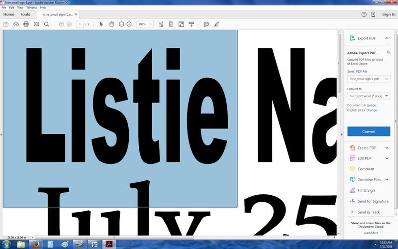

If you are just printing exactly the pdf, If it will open correctly as a pdf in Adobe Acrobat then just resize the image at 100% to start. Go up to Edit then down to "Take A Snapshot", Start at the upper right corner and copy the image and paste it as as a jpg. It will copy at different resolutions depending on the size you have in acrobat.
If you need the vectors, I'm of no help...
