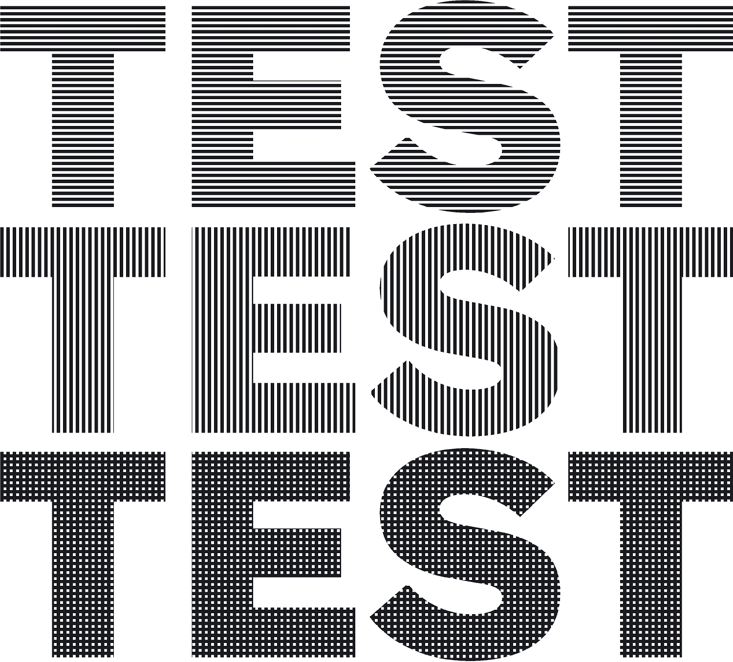

bannertime
To make the weeding go faster, you could make striped letters. One set horizontal and one vertical. Over lay them on the finished product. I have no idea how this will affect the light, since it has overlaps. So no clue if it'd work, but that's what I'd try next.

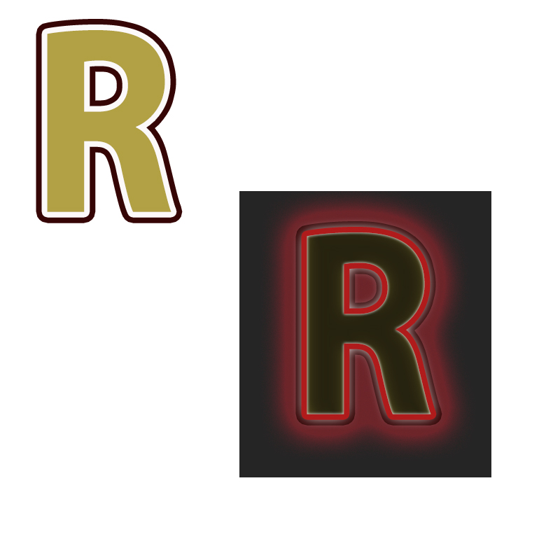

Why not do a halo of red on the building and use an opaque solid mirror gold for the front ?? If you want, add a 1/2" outline to the letters and they'll be a red light coming through there, also.
