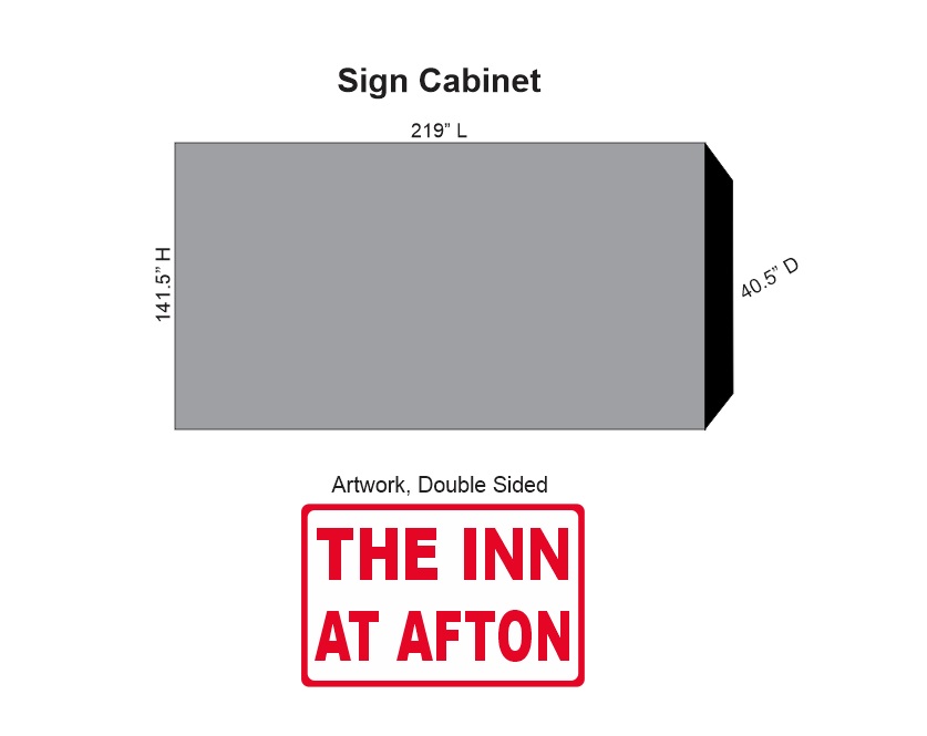

I need to create a "Pillow Case" that will cover over top of an existing sign cabinet. It would be sewn on the sides and slipped over. I would use the retainer to hold it onto the sign.
The problem I am having is:
#1. What size to make it? It needs a few extra inches for play room.
#2. How do I lay out the artwork for it? I thought making it all out of one piece would be best, but maybe two is better?

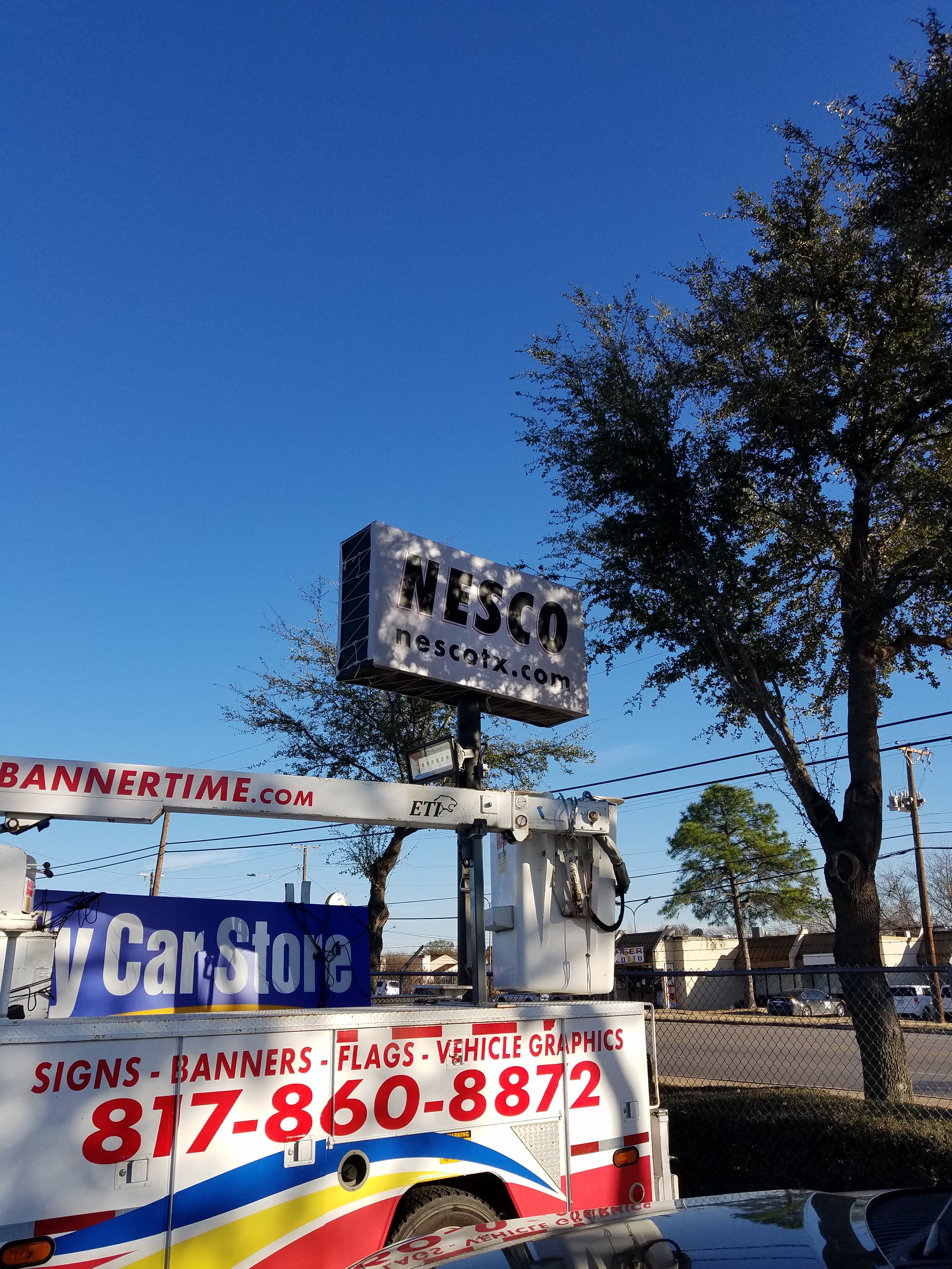

If it's temporary just lace two banners together. We do it a few times a year and have never had an issue. Way easier than trying to do all that stuff.
Caveat: This is in no way a permanent or remotely long term solution. The banners are up, at most, 4 months while we are waiting on customer supplied artwork, approvals, or permits.

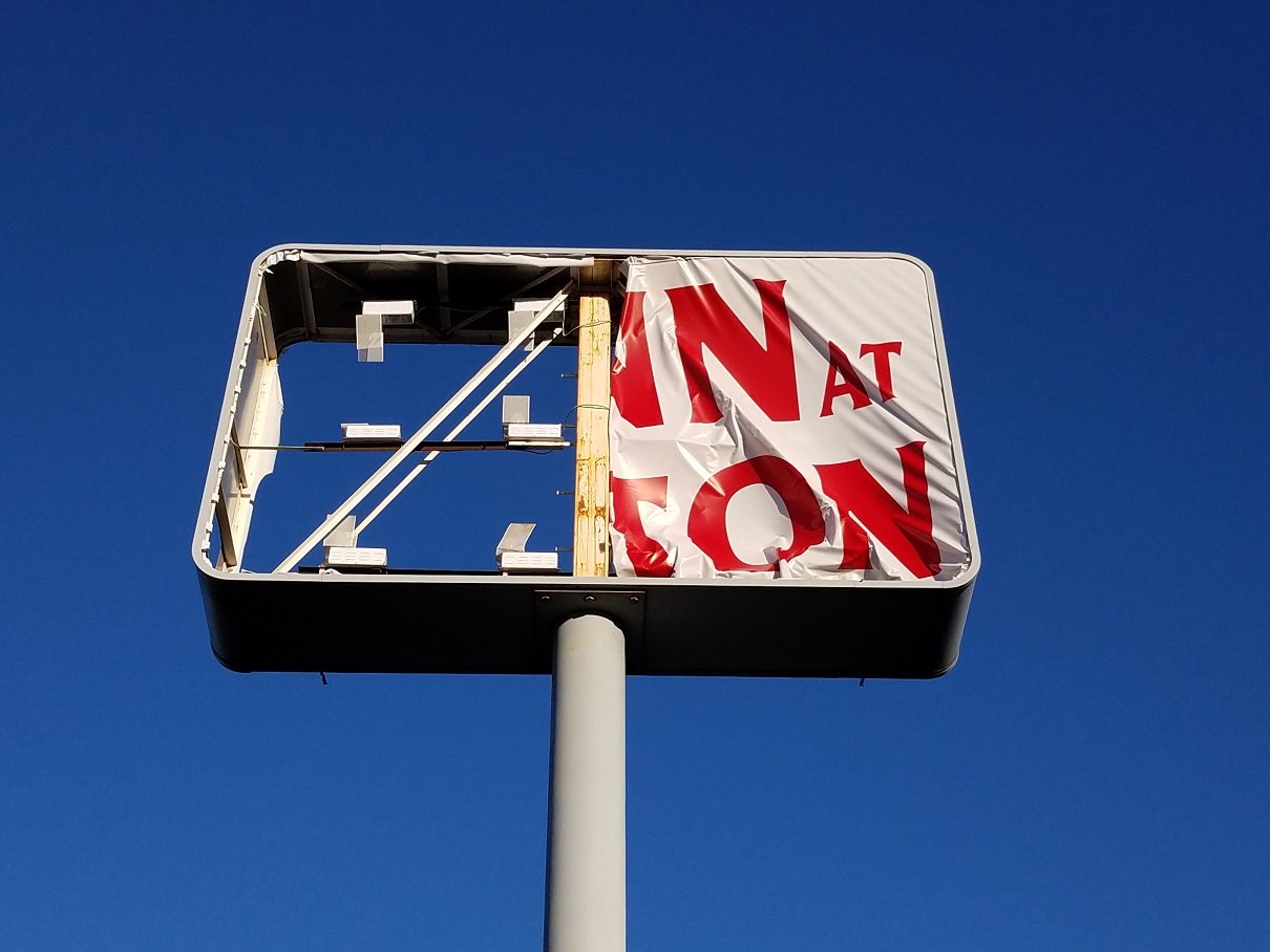

One advantage of using flexible face material, such as Cooley, is its durability. It can be installed and lettered, then stripped and re-lettered later.
I have done this many times. Unless I am eradicating, I would install the blank face material for this sign and then apply vinyl graphics on site. Stripping and re-lettering can be done from a bucket without removing the face. I have stripped and re-lettered the same faces as many as three times this way.
Lettering a blank face on-site avoids any alignment issues you might have when tensioning fabric that's already lettered, an advantage if you are working alone out of a bucket truck. I have even eradicated faces in place for the same reason, though never one this big. Do it carefully, and on a calm day.
The faces in the picture appear to have been cut with a knife. Flexible faces don't just blow out. At least, I've never seen one blow out. Small rips usually stay small without progressing. The fabrics are made to do this. I have even carefully knife-trimmed vinyl right on a flexible face with no problems arising from it even years later.
Had the original faces been left intact in this sign, it may have been possible to strip and re-letter it economically.
I believe flexible faces produce the most durable of lighted signs as long as the internal structure is well built. No breakage or yellowing as with acrylic and polycarbonate. Easier servicing, too, if the cabinet fabricator planned well.
