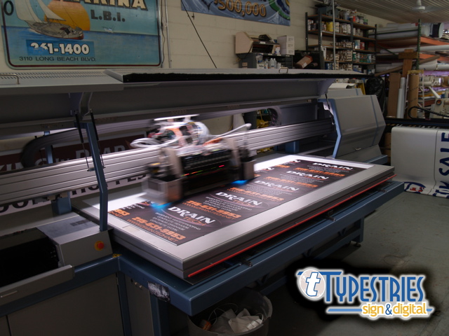

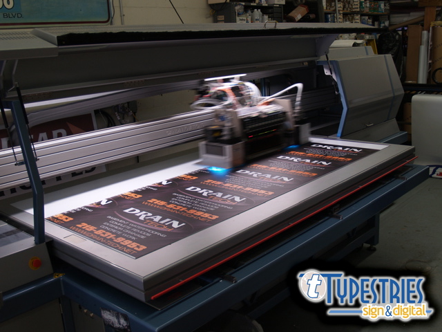

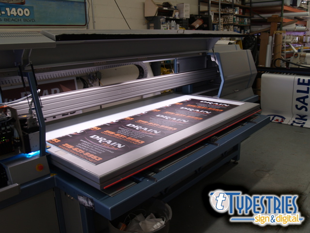

Our Gandinnovations Jeti 1224 is a very well thought out and thoroughly engineered machine. Still, an investment of less than $50 and fewer than 30 minutes greatly improves the usability. We pimped our jeti, how have you pimped yours to improve it?

Actually, we used flourescents. The LED's I looked at didnt seem that bright. So, we wound up with two shoplights, 48" each. It was nice, they had plug end cords already wired. We ran the wires out the top vent hole and plugged in. We added cable ties around the lamps just in case they come loose from vibration. We need to add a switch to make it easier.
Right now it's got the 4000k lamps in it, but I ordered some color correct lamps that should be here in a few days (neither my lowes or HD had them).
Next on the list, relocate the vacuum blower starter switch to the front of the machine (where it should be BTW).
