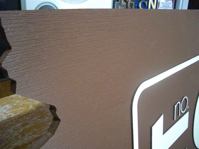

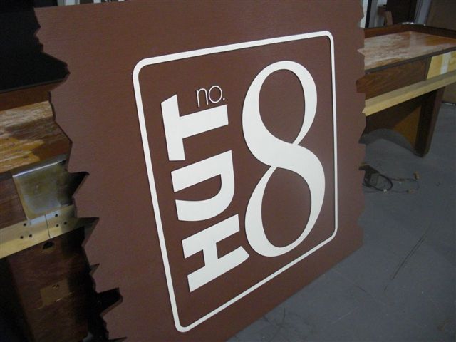

Here's a sign I just finished last week. On the Hut#8 sign, we glued up four boards using biscuits, polyurethane glue and pipe clamps. We then hacked out the sawtooth ends, and in this sign we inlaid the logo from regular PVC. The logo was cemented to the background. The second shot shows a close up of the grain detail.

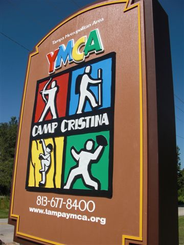

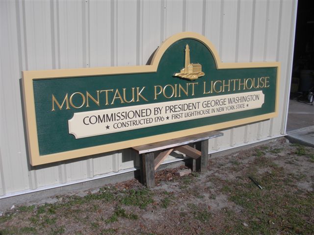

The Lighthouse sign uses the same material and techniques for the green background. The YMCA sign also with some additional inlay work.

OK, I am going to take a lot of crap for this but I don't care. The only signs that I make are signs I can print or cut off of my XC-540. I see a beautiful sign like the lighthouse sign you have there and I wouldn't even know where to start. Would you mind educating me and going through the basic steps that were required to create that sign?

I started with a 2"x2" aluminum framework. This was to give the sign added stiffness and support for the two post it was being installed between. I glued up the frontier board for the background and cut it to shape. The lighthouse lettering was prismatic carved on the router table but you could easily order letters from Gemini or any of the other letter manufacturers, or find a local CNC guy to cut them out for you.
I also carved the lighthouse graphic on the CNC from a photo I converted to replicate the actual lighthouse. I glued and screws the background to the aluminum along the edges and then hid all of the fasteners with the edge molding I made. All paint is Behr's premium exterior latex house paint.
Thats all there really is to it. Try to make a few samples for your shop and then you should have no trouble selling this kind of work. This sign could have been made with basic wood working tools and the carving done with chisels by hand. It's not hard to do at all.

Thank you for the simple and informative answers. I really appreciate it. I have tons of construction tools (I have about 40 rentals that I work on myself) but I never seem to get creative with this kind of stuff. Maybe you have inspired me. What type of material did you use for the edge molding and what process do you use for the curved piece. I will also check out one of the letter manufacturers.

The edge molding is HDU. You can easily cut the curved section with a good saber saw and then you run a hand router around the inside edge with a double ogee bit for the detail. I mitered the intersection corners and the rest of the runs were straight sections and mitered.
