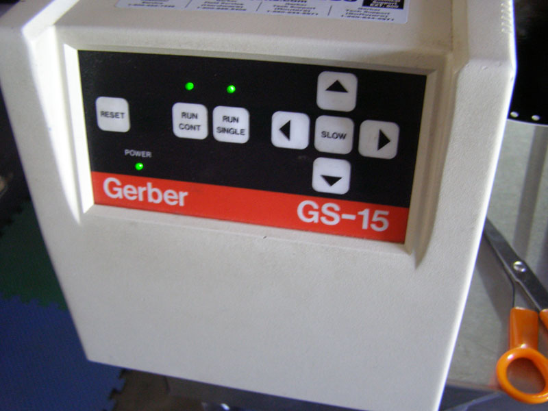

I've been using this plotter since 1994 and never a single problem! Just 5 min ago, I got up from my chair and attempted to advance the vinyl via the left arrow key (as I've done thousands of times before), and as soon as I touched the button, an electrical SHOCK (static electricity) occurred and now I cant do anything!
As soon as the shock happened, I noticed that the "run continuous" and "run single" lights lit up. I can not do anything- none of the buttons work now. The unit does still power one and off fine, but that's it! I tried unplugging the power and the cable for a few seconds....still nothing.
Is there a way to reset this, or am I screwed!? I have a trailer and pickup comin here today to letter. I should have never sold my "spare" plotter! :omg2:

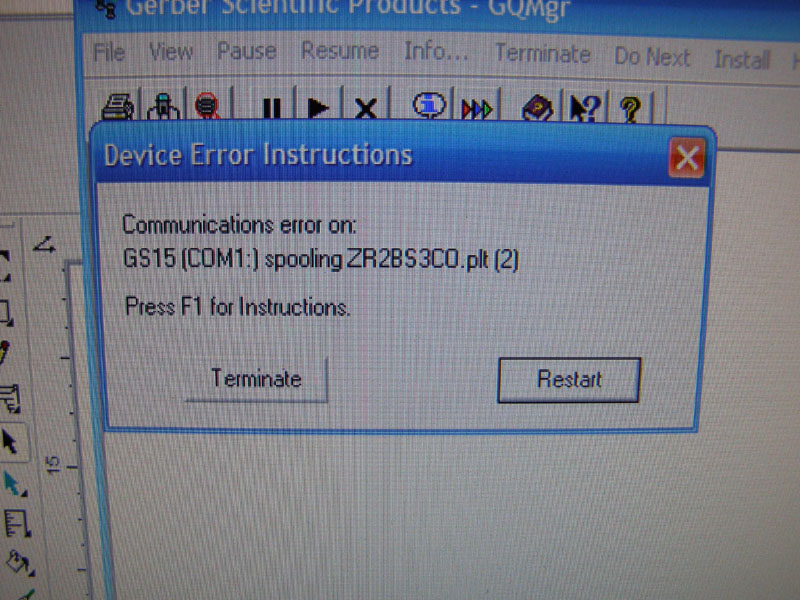

the two lights come on even after you have shut the plotter off and on? when you go to the plot page and send a job tothe plotter, what does the GQmgr say? it should read that the plotter is active.
Yes, the 2 lights stay on when powering back up. I just tried to plot, and got communications error.

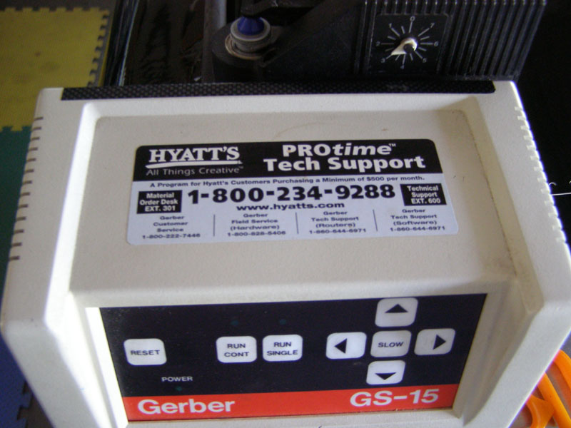

contact hyatt..they should be able to tell you how much the part'll be...i dont believe we ever sent our plotter out, so we must have been able to replace the part by ourselves....if you need the number for hyatt, let me know...

I have their number...right on the plotter, actually!
Just called TubeLite about a loaner...the "boss" is calling me back. Guess I will try Hyatts and see what they think...

Hyatts is really good and they used to have a tech service which is of help if you need to buy the part and install it yourself. best of luck

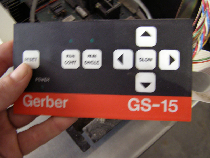

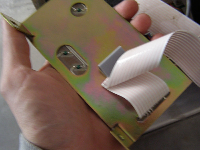

How can i test/tell if I "burned out the motherboard" or not??
Doesn't it make more sense that I "burned out" the small circuit board that controls all of the buttons (se epics)??

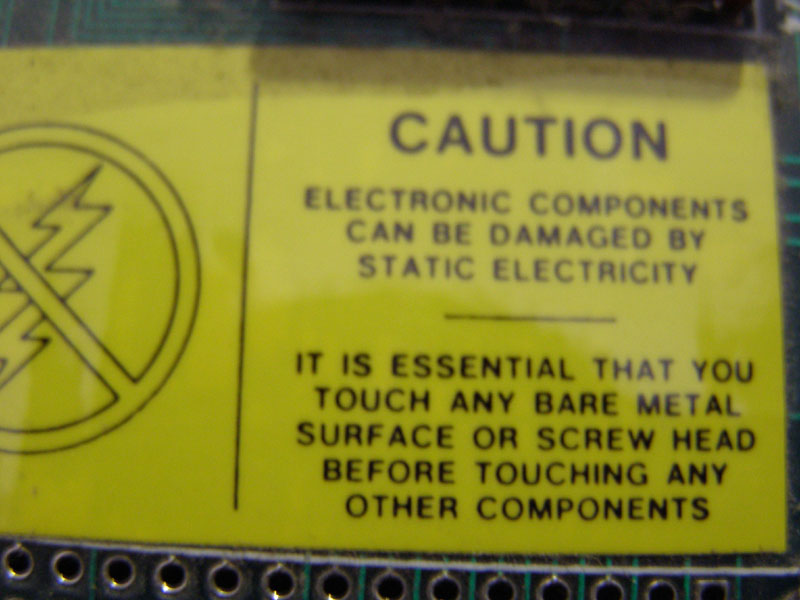

You will need to talk to someone that can lead you through the tests. Static can do strange things!

Well, an extremely pleasant woman named "Peggy" from Gerber tech called me this morning and told me what to do. I just need to unplug the key pad ribbon from the mother board and power it up. If it still "beeps", that means I just need a key pad ($300+). If not, I need a mother board ($661).
Will try it when I get to the shop later...
