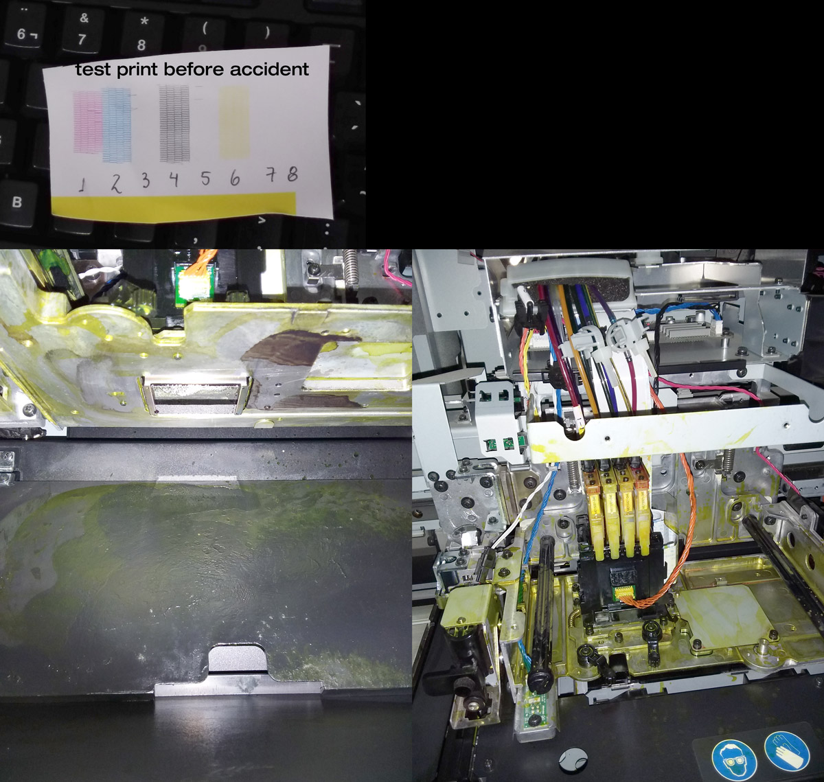

My printhead was not good, only 4 lines working but it was going on, until I have this huge accident today: the yellow hose came out the damper during printing process and spilled ink all over the machine... I left the room for only 5 minutes and this disaster happened. I disconnected the dampers and that area on top of printhead (black plastic cover) was soaked with ink. I cleaned everything as fast as I could, did a nozzle wash, ran a few cleanings and finally did a fill up ink, but none of this made the nozzles come back. Apparently, there's no physical damage to the head and no signs of malfunction in the electric part.
Do you think the damage is only to the printhead or more parts? Please see the photos.

That is a mess!! Is it printing at all now?
I cant see how it didnt get ink into the electronics on the head, all the dampers have yellow ink on them. My guess would be new head, head cable, dampers, capping station, wipers. sponge, etc.
You stated only 4 lines working? is it an 8 color machine? I realize its an 8 color head.

Yes MikePatterson it's an 8 color head, but since 2 lines were missing, I did something to obstruct 2 other lines and work with only 4. It's not printing at all, there were a few black nozzles right after the accident, but after the fill up ink, there's nothing, zero! :(
I had a problem with the head already but now I'm not sure if just replacing the head would do it. Do you think if it was something else, the machine would still detect media and do all the other functions but print?

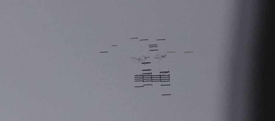

Lady Who
In the morning machine was recognizing media and doing test print. Now I tried another test print, it recognized the media, then when it was supposed to print the test print, I got a long beep and Error 187 HDC SLEW RATE... It's an electrical problem, right? Any chance of recovering the machine or it's total loss already?

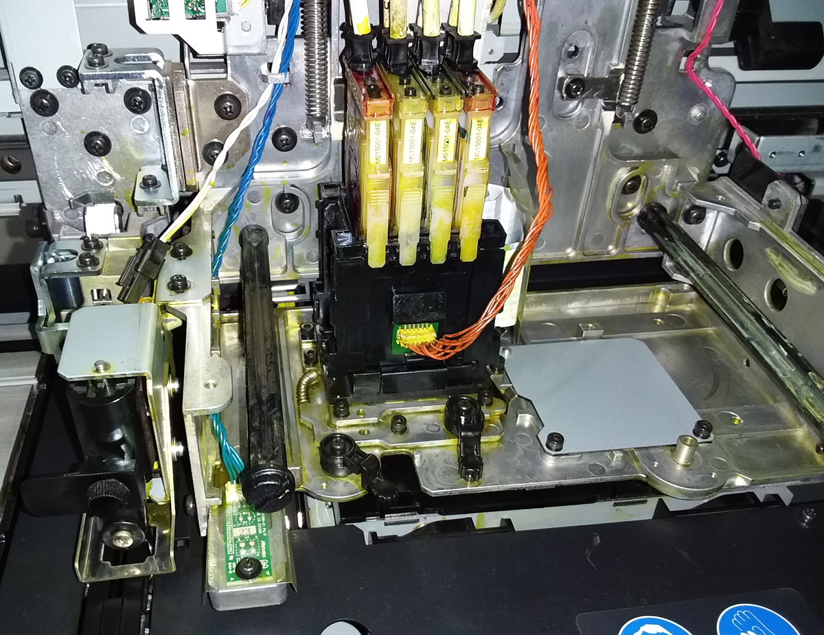

netsol I already cleaned all that I could, see the photo. Should I remove the head to clean better between the metal parts? Can I make things worse?
It's turned off now... I don't know how I was so stupid to leave the machine power on after this, I've been making the worst decisions lately :( Had no idea the ink could pass through the plastic cover in the damper slot and reach the electric parts of the head... Can't believe it, I guess it's not difficult for a damper to leak, that structure was supposed to be sealed and solvent proof. Although, some ink also ran through the outside of the head.

netsol is spot on - the ink has gotten down into the connectors and across the contacts on the board to the left and the head connector and anywhere else it went - You should disconnect the connectors and clean them and the board surface with a fine brush and denatured alcohol - clean it really well and let it dry - the ink will short across electrical contacts even when dry - You have to get the residue off . The other thing to look for is ribbon cable contacts. The ink will cause the contacts to seperate from the cable so you don't want to let them sit if there is ink on them .

you have to be incredibly careful, not to do any damage
ink on the ribbon cables or circuit boards can be very destructive, it all needs to be cleaned, but, depending on your skill level, it's possible to do more harm than good
at this point, it might be best to leave for the tech. IMPORTANT, though, if all the ink has not been removed from ribbon cables and boards, DO NOT turn the machine back on. no good will come of it, and you might do damage that will cost thousands to make good again. once the ink has penetrated the insulation on the ribbons, it only takes 1/60 of a second to do incredible damage. I have seen people say, I only turned it on for a few seconds & do a terrible amount of damage

it is a head board error. we need some very careful cleaning with 91% alcohol
i think you do not necessarily need a mimki authorized tech, just someone to be extremely careful removing any ink residue. it might make sense to try to get 99% alcohol, the less water inthe chemical, the less impurities when cleaning is done
i would start with a gallon of alcohol, discarding and starting with fresh quite often
we have to be patient & work slowly
a tooth brush, some swabs and a hair dryer COOL AIR ONLY, have a delicate touch
