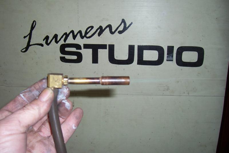

We use this.
It is a torch head cannibalized from a neon crossfire.
It runs off propane,oxygen and air and puts out a very hot pinpoint flame.
We scrape the machine marks with a razor blade and then one pass with the torch.
Turns out looking like glass.
You can also scrape with a razor and spray a glossy clear coat on the edges.
Try it you will be amazed how it looks

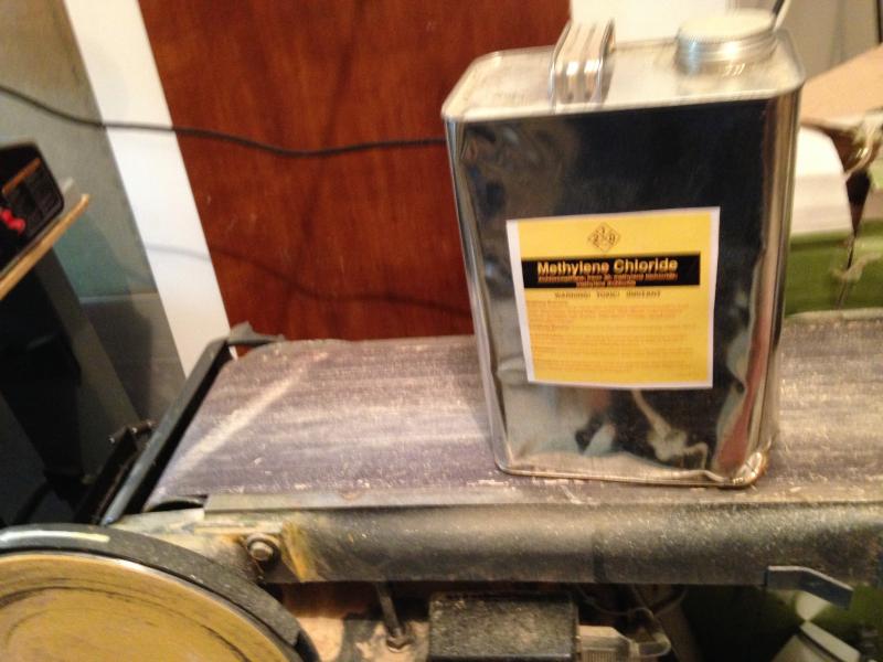

ever wonder how they get plastic lenses to be so smooth and clear?
They use a chemical process to polish the lenses. The lenses are ground to the shape they want. The finish is like an opaque sand blasted surface.
They place the plastic lenses into a small tank filled with a specific solvent and let it set for a short while. The surface soon becomes absolutely clear and micro polished. It goes from a matt finish to a glossy water clear optically perfect surface.
However, You must be sure not to breath the solvent. It is said to be safe but. I wouldn't trust it. If it can change plastic it could change your lungs.
Flame polishing polycarbonate fails because there is moisture in the plastic. Flame will cause micro blisters.
Flame polishing acrylic fails because it sets up heat stresses that very easily fail into micro cracks. Add some cleaning solvent to clean it and suddenly you have a ton of cracks on the edge.
This stuff is magic. You make a shallow bath and a cover. Set up something that will hold the part just above the liquid. Nails with points up will work.. Pour in just enough liquid to wet the bottom plus a little more. This stuff evaps very fast. Put a cover on it and wait a short while. Do not breath it.
There are hundreds of ways to vapor polish the edges this is just a suggestion to get started. Once you get it right you will never again flame polish anything.
I recently polished my old headlight covers. They look like new again.
