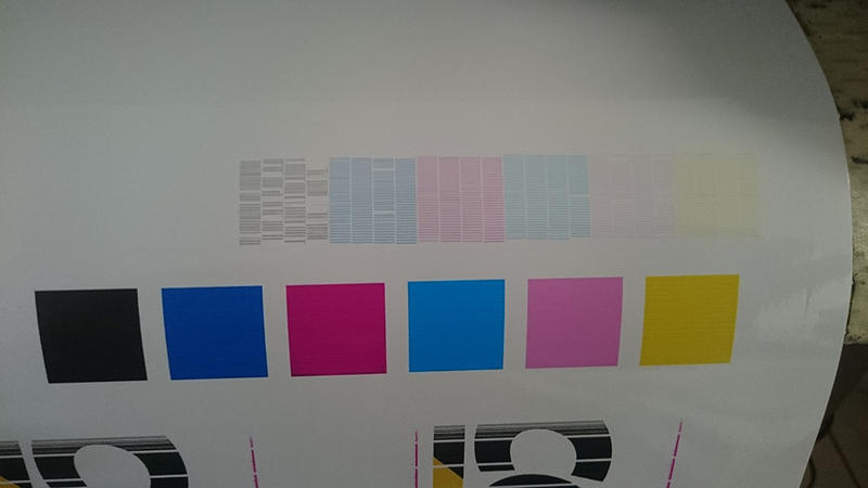

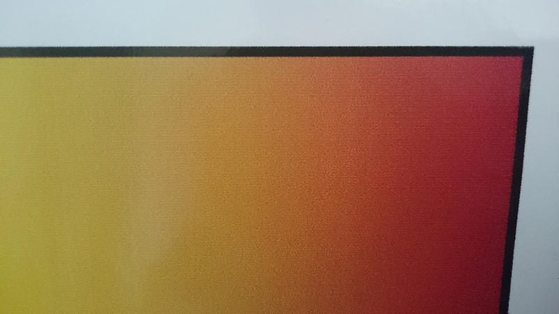

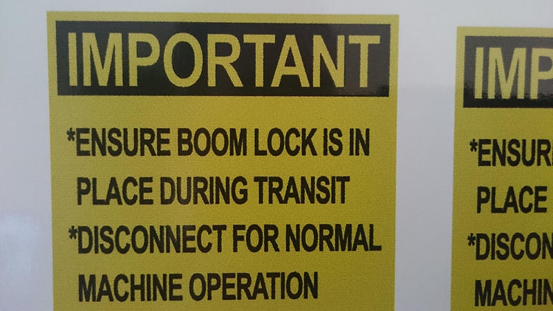

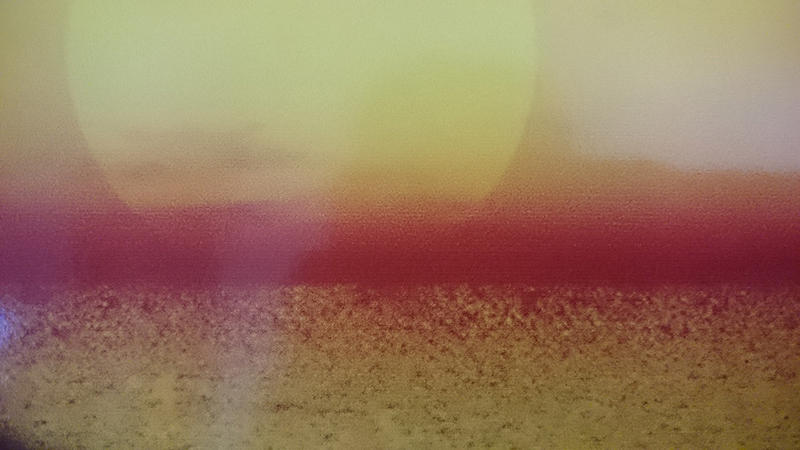

Hey guys, new to the forum and new to wide format printing. Basically we purchased an SC-500 to get into making signage and decals but am having no luck atm. The prints have gotten better since first using the machine but i still can't figure out what is wrong. Had a tech check the machine out and had the pump replaced and the capping station cleaned up which after a few head cleans brought the quality up a little but as you'll see in the attached images, the quality is still quite poor. Regarding the black, the tech said to run some prints through as the solvent in the ink may clear it up but it hasn't enough to make the printing noticibly better. There are visible lines through the 6 colour test print, and other than black, i cannot obtain a solid colour at all. I tried changing eps versions all the way down to version 3 and changing between postscript 2 and 3 for all to see if it was a file issue but no luck with that either. The images i printed were all saved as CMYK, no rasters used. The sunset way a tiff i found online to try someone elses file to further check if it was my file settings but came out the same. All prints were done with the SOL Gloss White profile at either super or photo (min 720dpi either way). Could it be a problem with colorchoice? Or am i looking at hardware issues? The tech has a new head that he'll install labour free at cost if the black doesn't clear up but i need to make some quality prints to make some money back before spending even more money lol. Any help would be great.

+1 deflected nozzles are the mail culprit, particularily in the black & yellow.
if the problem persists when your nozzle check clears-up, then you may also have alignment issues.

Thanks guys. I'll see if i can find somewhere to get cleaning solution that's open on a weekend (today being Saturday). If all of the nozzles, or 90% of them, become unblocked, will the prints clear up and become viable sale wise or are there other issues? The print & cut alignment feed and scan was checked and set by the tech so it should be fine i assume.

So after soaking for 24hrs there was no visible change in print quality and seeing as i need to get jobs out that were already organised, i bit the bullet and got a new head installed. Now the nozzle test print looks fine, heads were aligned, scan and feed alignment done. Basically every setting that could be checked and changed has been done but i'm still not getting good quality prints. No matter what i send to print, everything looks terrible. Can't reproduce a solid colour or gradient and still has lines through the prints. Tech says he's checked everything hardware related that could cause print quality problems so it may be the rip settings but he doesn't deal with the software side of things. Roland doesn't support the printer or the software anymore so i can't even obtain new profiles to see if they will fix the problem and i can't keep getting techs out at $400 a visit. Any other advice before it turns into a $6000 paperweight?
