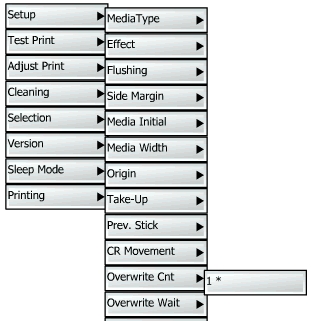

Stealth Ryder
You can set it to 2X, 3X, 4X, whatever you want... It is called Overwrite Count...
jiarby
be sure to also set the overcount wait so the 1st pass can dry... otherwise you will make a mess.

Thanks jiarby,
You typically need about 2.5 seconds for the wait time for most 'specialty' medias.
The process is the same for backlit (coated polyesters).
