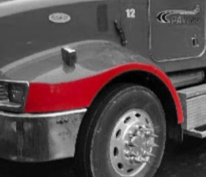

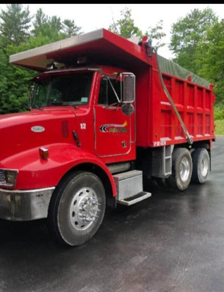

Hello guys, I have a truck scheduled to wrap next week and I'm wondering if anyone has experience doing the flat side into the big wheel wells. Is it possible to do in one piece and if so is it a nightmare? I am thinking of doing the well then a seem over it coming down on the side. I am fairly experienced and will be using 3M 2080 gloss black. I charged $2700 for the cab to be completely turned from red to black. Any thoughts on teh pricing?

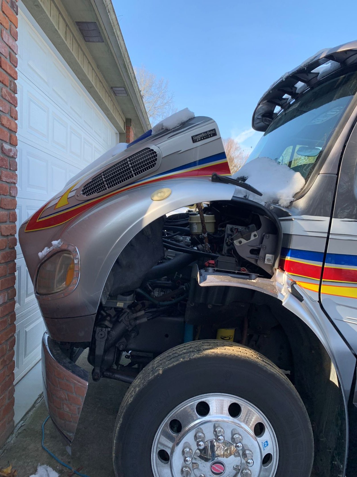

The engine cover and wheel well are separate pieces. They have a seam because the hood raises. No need to do that in one piece.
While I'm not familiar with this particular generation of Peterbilt, on trucks they typically design it so that about 1/2 of the wheel well goes up with the hood for easy service. To check the oil, you typically stand between the engine and front wheel.

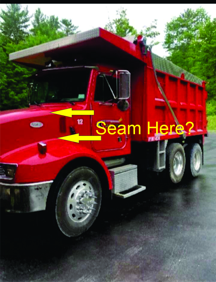

It will need to be done in a couple pieces to stay down in place, too many complex curves and potentials for failure due to overstretching the vinyl. Knifeless tape is your friend here.
Ask the customer to do the disassembly before the truck gets to your shop and reassembly after, a lot of those bolts are going to be a real pain and it will end up taking longer to do all that than the actual wrap.

Sorry, guess maybe I should've specified that it's the front half of the wheel well to be more clear. A picture is worth 1000 words. Here's what they typically look like when open - as a reference for others.

I think it's just the cab, cheers on getting 2,700 to do it, but the real question is, do you plan to raise the bed and wrap the back side of the cab? You more than likely can't do that in the shop, it'll need to be outside unless you have some pretty high bays.
Yes we discussed that the back may have to be done in warmer weather
I contract with a big truck garage and they take everything off and reassemble

Maybe this is clearer. Top seam? bottom seam? Both seams?
Neither seam?
