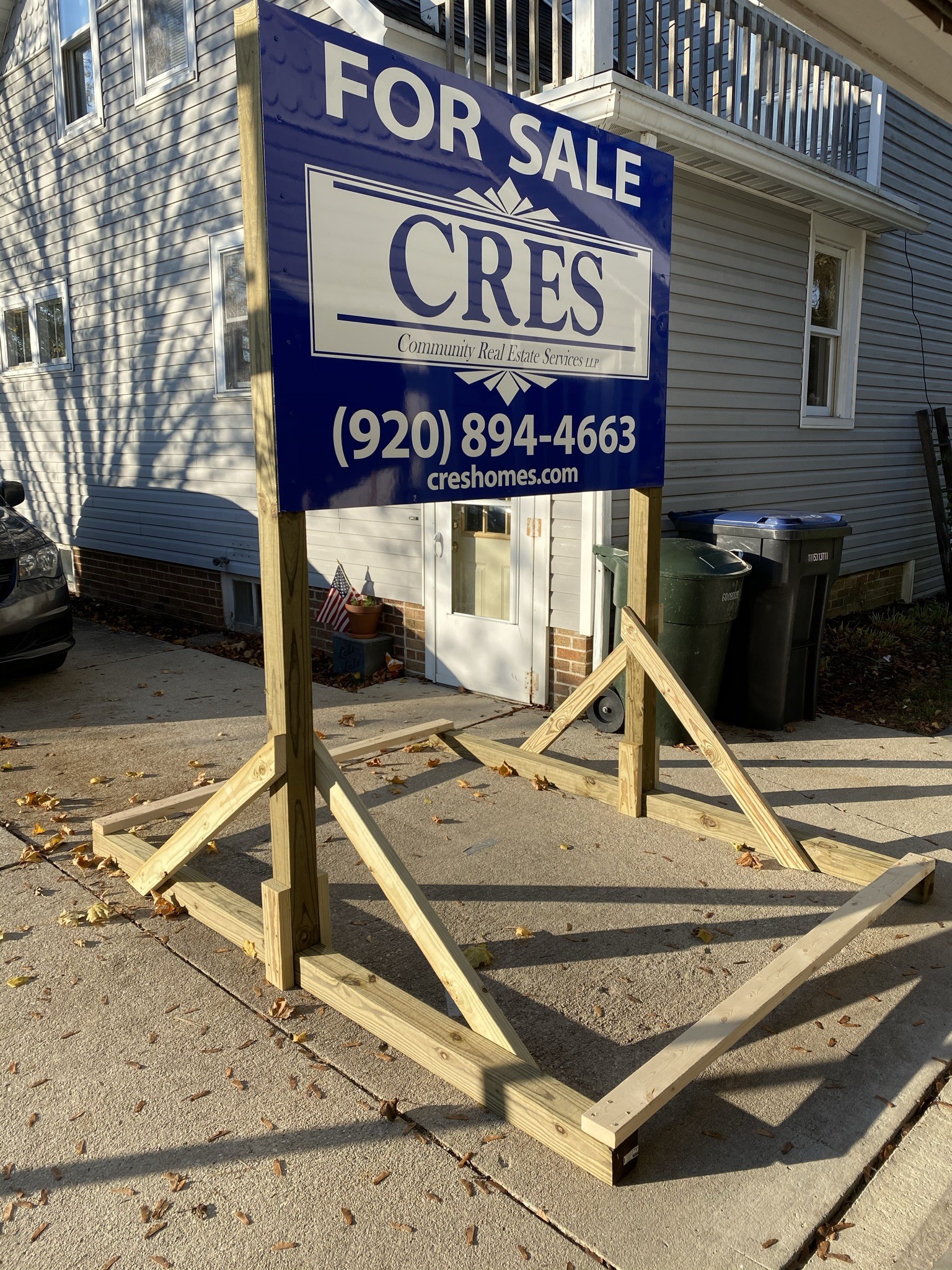

2. I would also suggest a sled because they can move them around to other sites. The sign below has been around plenty. The height is up to you and the customer. I prefer the about 3-4'. Do you get frost in NJ? The sled requires no digging. You can paint it white if you want.

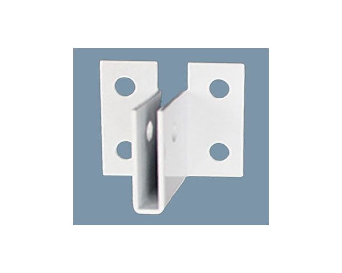

Sooper U brackets, I would use 3 on each side.
They make them for the center also.
I have also seen alum angle with holes drilled in it.

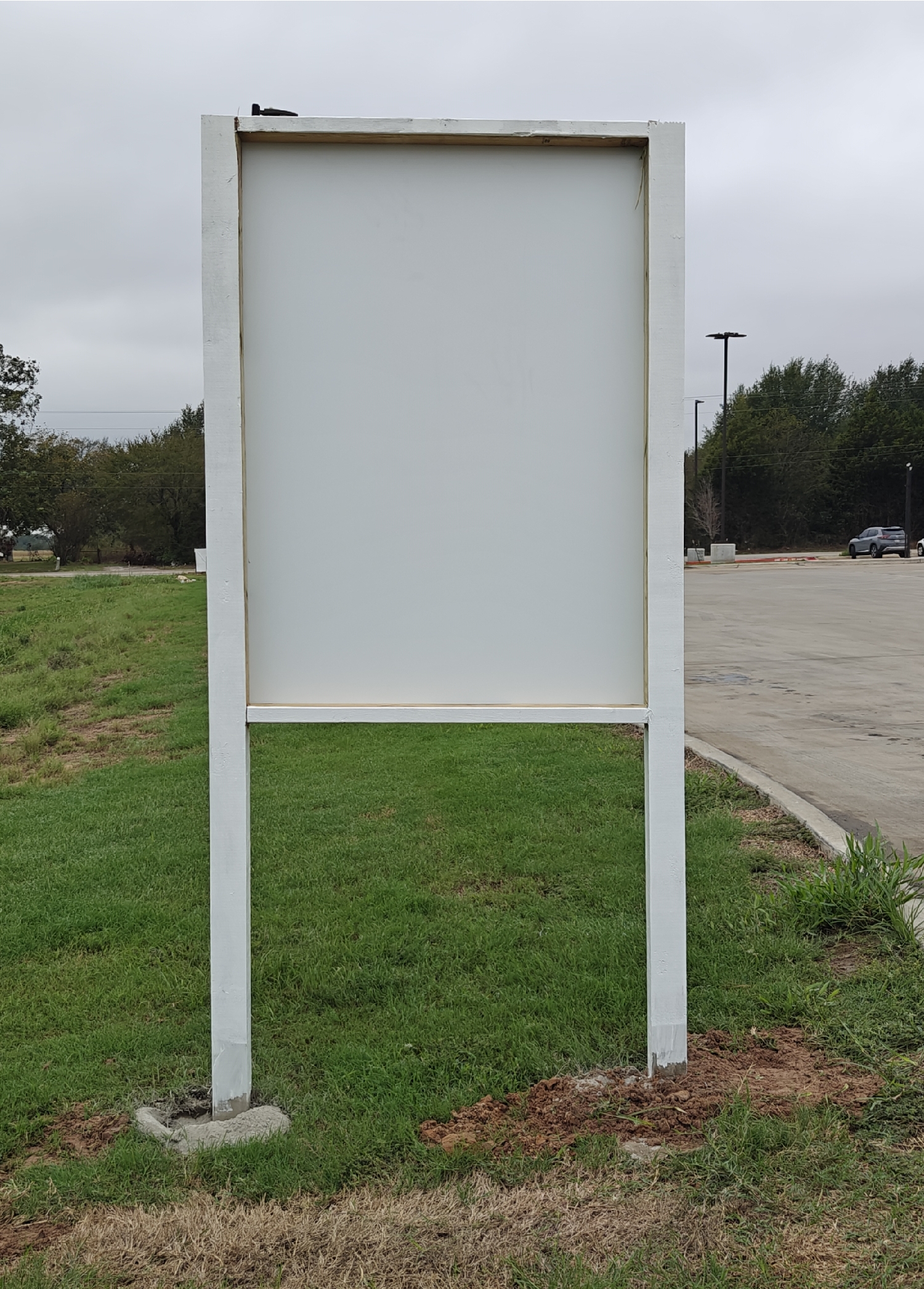

4x4 posts and 2x4 from hardware store. Use 6" deck screws to attach the 2x4s to the inside of the 4x4. This one I put extra 2x4s because it was a 5'x10' sign... but for 4'x8's, I just do the two horizontal 2x4's. Assemble it on the ground where you're going to dig the holes, that way you can lift it into place. If it's double sided... use coroplast or paper to protect the face when you flip it over. Attach the face with painted to match screws and small washers every 24"

The way Texas has it is probably the best way but......... it seems like once a customer thinks it looks better with a double sided panel on the inside of the posts and not two single sided panels mounted on the outside of the posts, there may be no way of talking them out of it.
The double sided panel is a very flimsy way to install a sign in my opinion.
