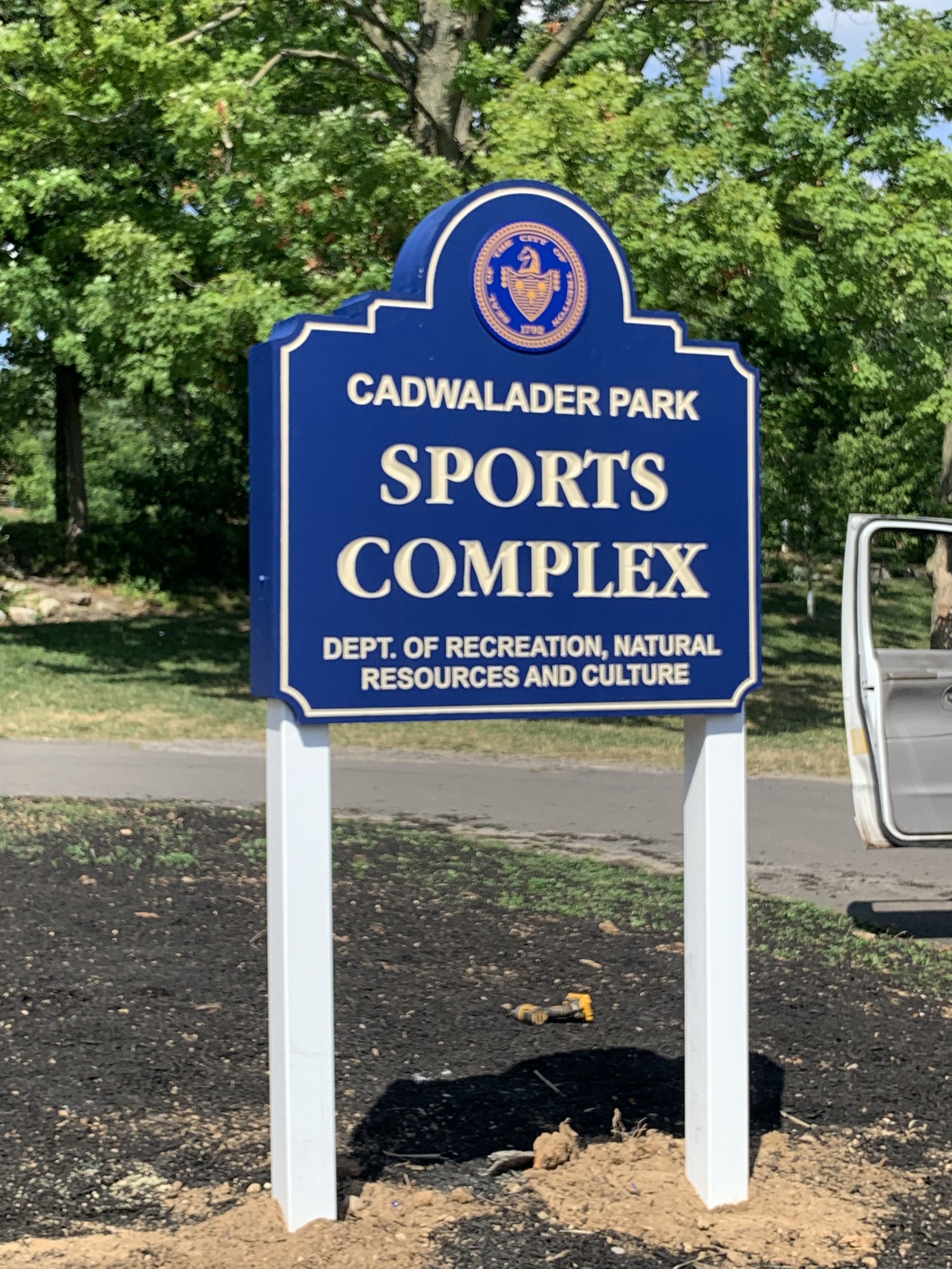

This is how we do a simple 4x4.
Makes the install very easy for many reasons.
Sign is completely assembled wrapped in bubble wrap when it leaves the shop.
Transporting an assembled 4x4 post and panel is no different than transporting a 4x8 sign face.
When installing signs we NEVER do anything in the field that could be done in the shop.
Why you would do it any other way.

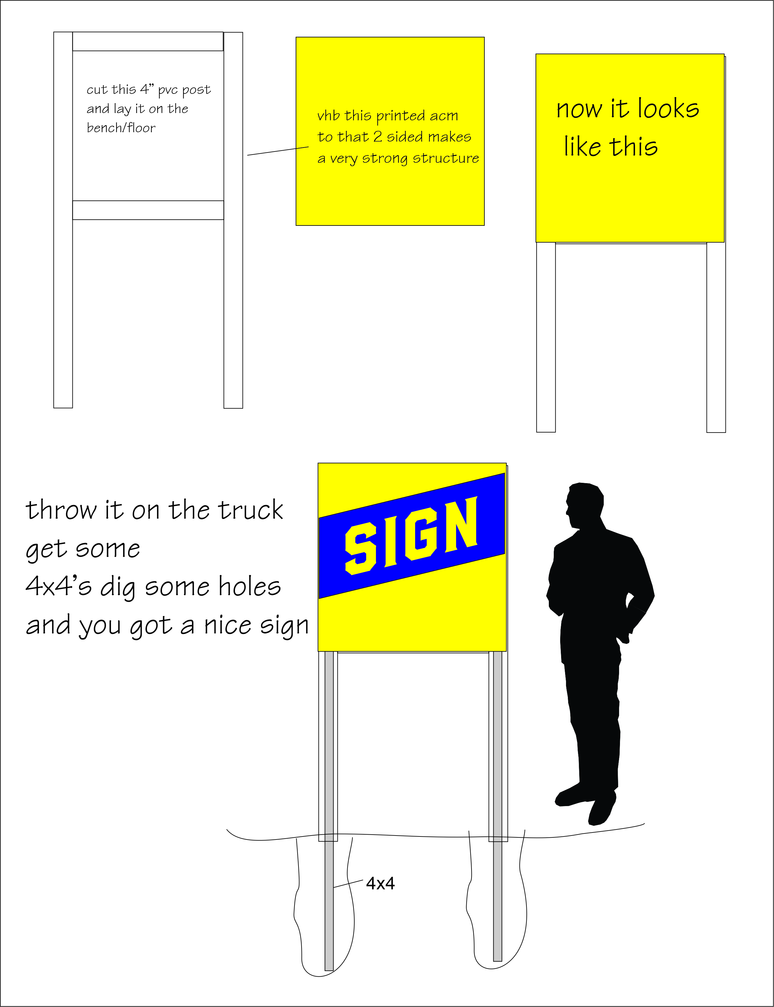

TIP: screw a piece of pointed angle to the ends of each post so that it sticks out at the bottom. When you set the signs, push the pointy angles into the dirt at the bottom of the holes. You can plumb and level easily, even by yourself—and without braces. I have a drawing of this but I couldn't find it.
