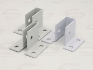

I've installed over 150 post and panel signs, let me know if you need advice. These are the things you need.
For a 48" x 96" 3mm ACM board ?? Are you nuts ?? They'll never hold it in weather, snow plows, heavy winds and so on. That thing would wave in the wind with those little brackets. Perhaps a 36" x 48" might work in 6mm or 10mm, but not a 4 x 8.
ams
I'm pretty sure U brackets are only available in 1/4"-3/4", although I could be wrong. In any case, these are not what you want to use for 3 mm (1/8") ACM.
1/4" would work, it's going to be flexible. Once you start getting into building a complete frame for it, you might as well make a new 1/2" sign.
