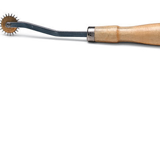

OldPaint
the machine doin it........is so slow......its is much easier when its big stuff to do it with one of these...
