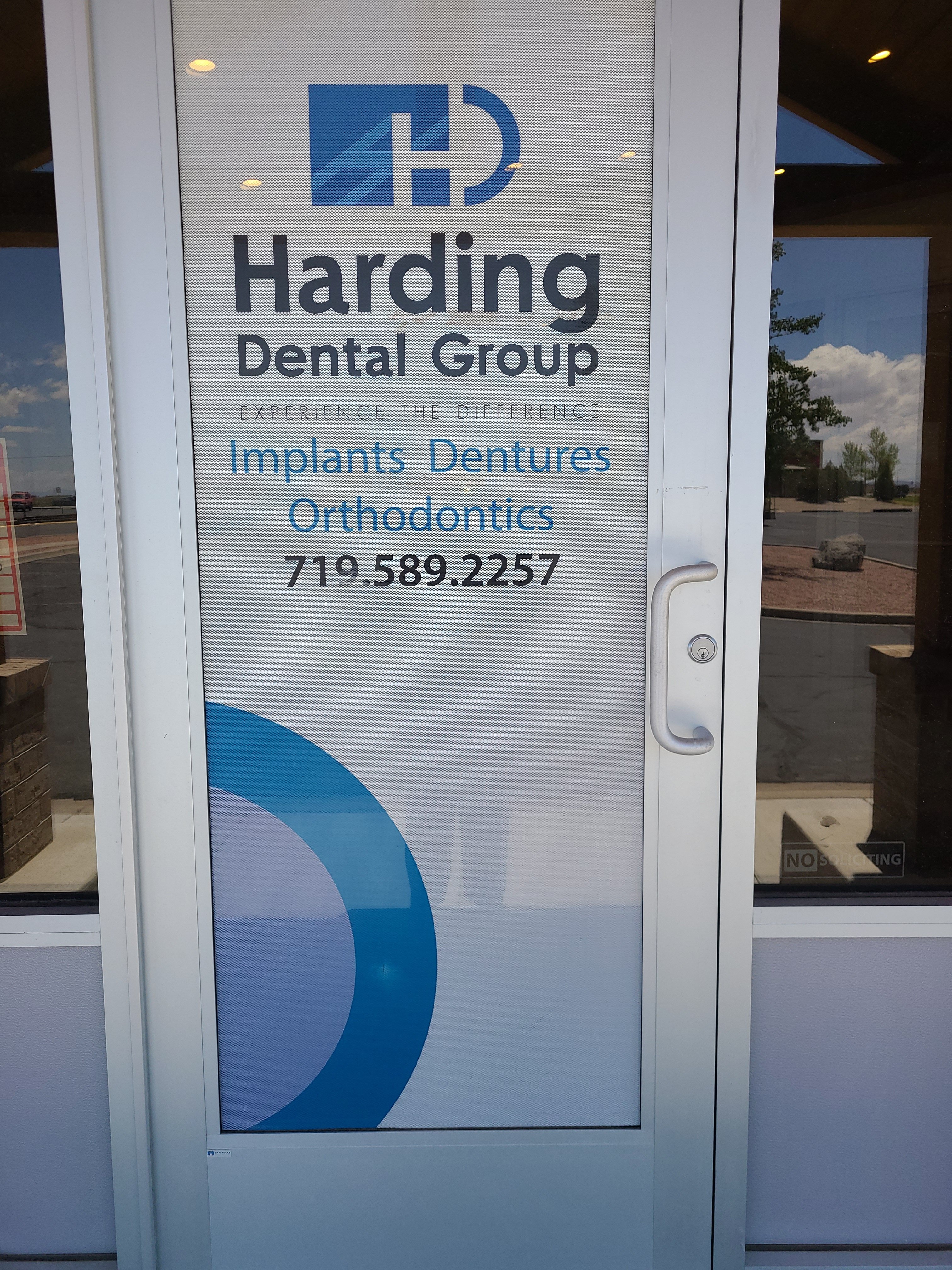

Two-sided printed perf? I think 4Over does that.
I will have to confirm. Maybe it's just cling???have you confirmed that it has adhesive holding it to the window? at least in the pic the long vertical edges appear to be rolled in, it may just be a window shade and not adhered vinyl.
Wouldn't I need to print white? (we aint that cool yet to have a CMYKW printerHexis now make a clear perforated material. You print on it in reverse, back it up with white then apply the adhesive to the interior surface.
Wouldn't I need to print white? (we aint that cool yet to have a CMYKW printer![]()
But they can mount white vinyl (no grey adhesive) to the back of it to create the white. That's an option. Or the adhesive-less perf with clear mounting film will do as well.Yes, you'd need white for that particular product.
ContraVision used to have a product that had a light adhesive that you could print directly onto and still apply to the interior of a window.
It looks like they've gone down the path of Hexis though and made the product clear which will require white inks to make opaque.
Wouldn’t it not be perf anymore if you apply white vinyl to the back?But they can mount white vinyl (no grey adhesive) to the back of it to create the white. That's an option. Or the adhesive-less perf with clear mounting film will do as well.
The only caveat I would add is to print to Optically Clear laminate if they want to retain the clarity of the view through the perf when applied.All these people and none of them seem to know the way to do this? Here's how...First you MUST USE perf media with clear adhesive. Start by printing the mirror image, as in backwards, on clear laminate. Then laminate the printed laminate with the perf media. Apply the result to the inside of the glass. Don't fret if the colors on the laminate seem washed out, when the white perf media is applied as the laminate it becomes the white point for the print and all the colors assume their normal values. The only downside is that the non-white colors on the image are compoetly printed on the laminate making the holes in the perf a washed out transparent version of the color being printed. Most people will never notice. If this bothers you then you're left with the print and then apply adhesive chinese fire drill. If you look closely at the OP's image it looks very much like the method described above was used.
