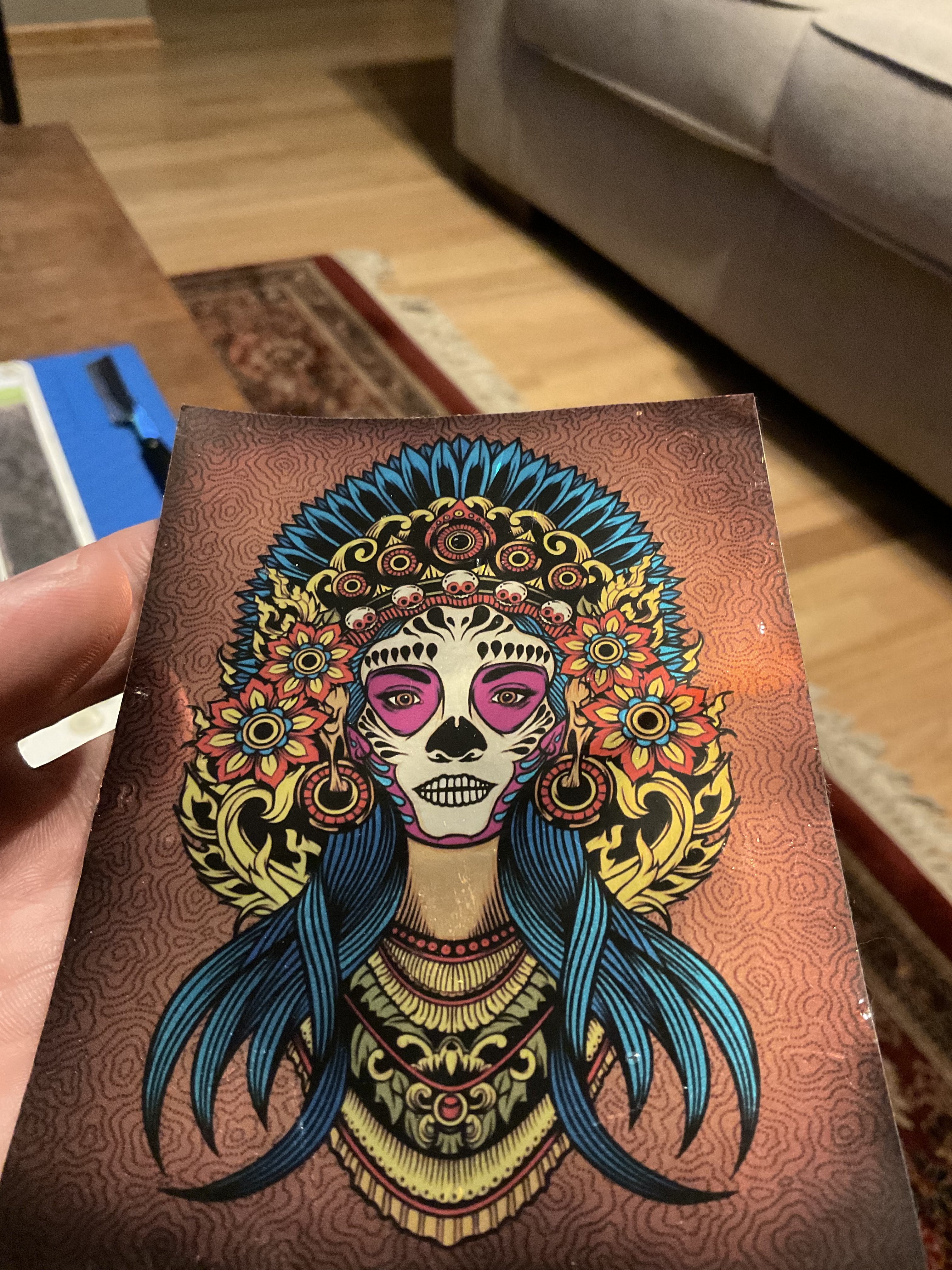

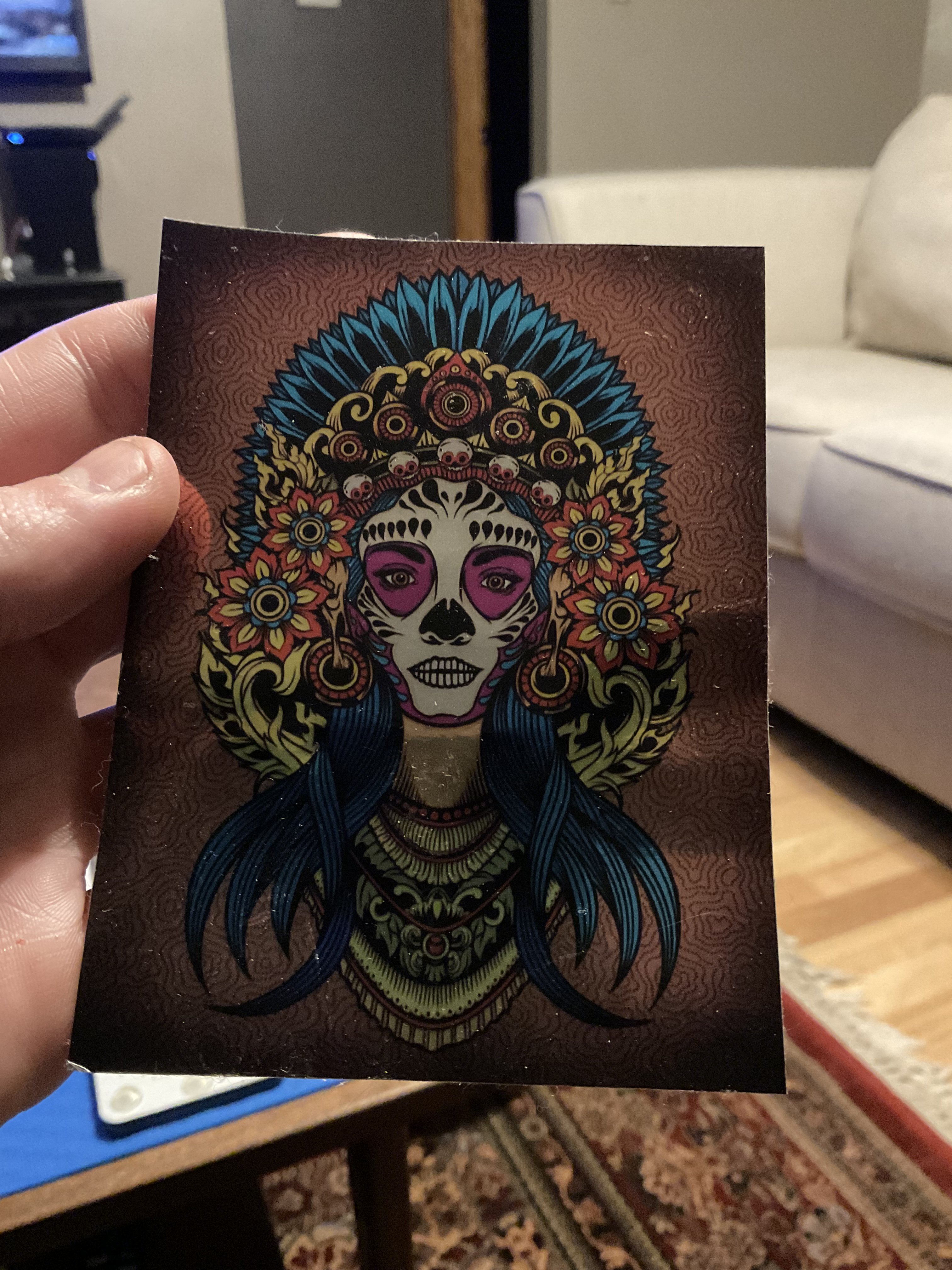

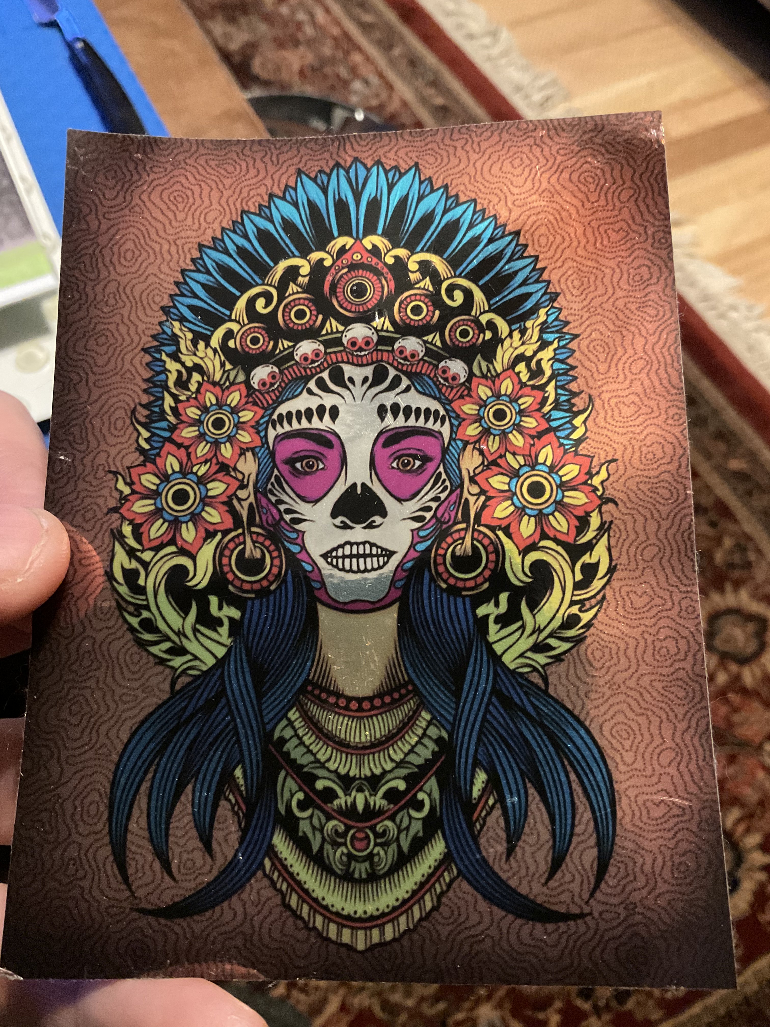

Have you ever tried to print on cast or calendared laminate? after printing your artwork on a laminate, laminate the print or “laminate the laminate“ per say. then mount that to the reflective. its one of my favorite decals to make. in essence you could print your own any color wrap-able chrome decals. i have never tried them on an actual wrap but i know they last forever on flat surface and indoors and ive never seen them delam indoors. my guess is they would work well outdoors too but dont quote me on it… using chrome as your white substrate replacement is probably my favorite decal combo

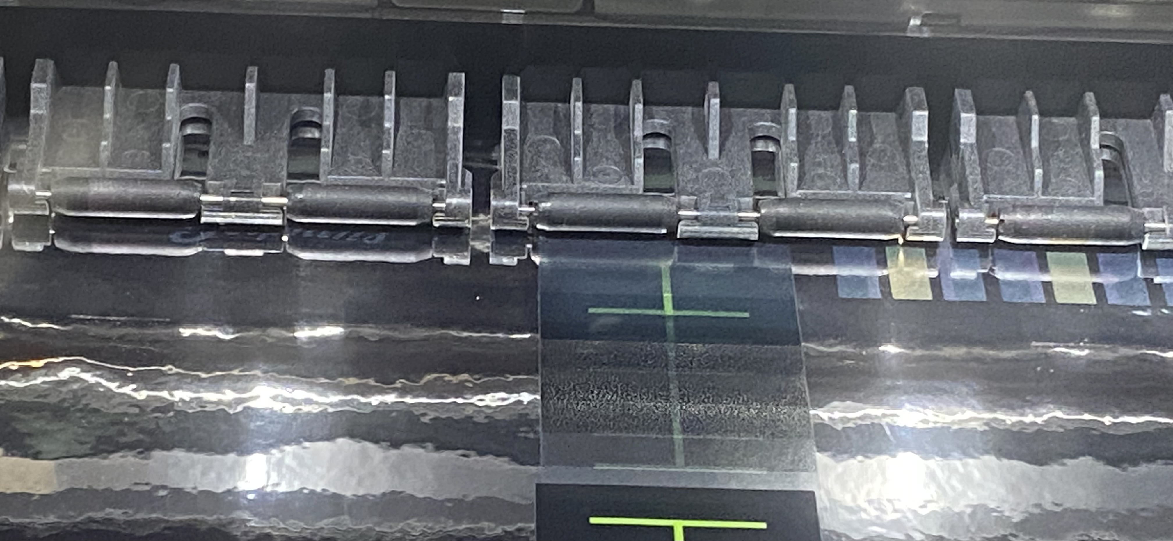

Hello, what HP Latex do you have? I’m having a bit of trouble printing on sub chrome with my Latex 700w.

I’m having a blur effect sometimes. Pic attached.
Also, even if I use the take up reel it seems to stick and won’t move. It happens even on the intake rollers.
