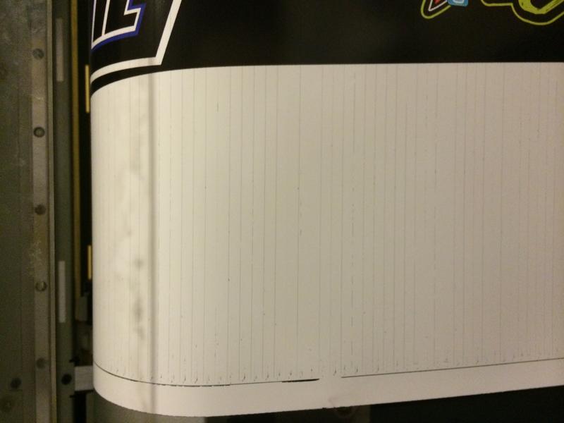

Just started to notice this on a larger print (see pic). Any ideas? I am noticing black ink layered on top of both media clamps as well. Tried Medium, and Powerful cleaning. Any help is appreciated! Thanks!

Did you try swabbing w/ solvent all around the head and carriage? Maybe a piece of lint or hair dangling?
Not yet - can I use the cleaner in abundance around the head? Or just use the swabs?
Have done a manual cleaning before - just not sure if I need to do something more, or if this is a sign of something that can not be solved via a good cleaning.....???
Thank you in advance!!
player
If it is the ink stalactite issue., a good cleaning should clear it up.
When was the last time you cleaned it manually?
Engstrom Graphics
sniperhockeydesigns
I would think your test print would be really bad if you clean it 2 or 3 times a year. I clean it every week, and since I have very ow use, I also clean it after every job.
Do you know what a manual clean is?
Yes I do - remove both covers, use swabs, etc. Just completed a few hours ago and so far so good.
Thanks.
