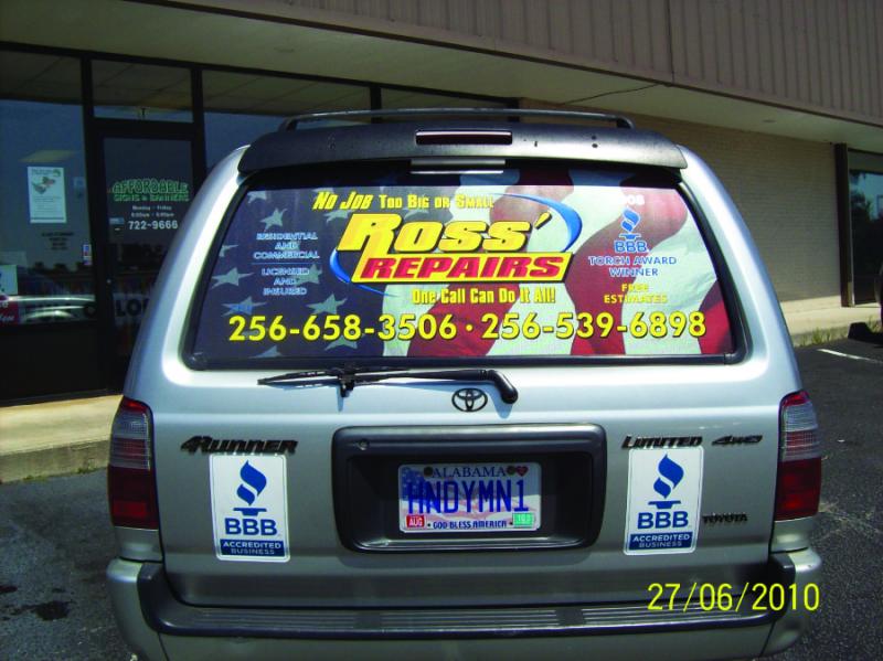

Has anyone ever applied printed vinyl to printed window perf? Well, I just did. Why didn't it occur to me beforehand that the vinyl is going to curl up where it lays on a hole???? I just tried a Sealit Pen and a heat gun. Neither solved the problem. Any other suggestions?
btw - the customer insisted on vinyl on perf because the colors would be brighter. True. It really looks great. The letters have been on there for almost a week and aren't curling any more than the first day but I'm sure they'll come off eventually. You can't tell by looking that they're curling; only when you feel of it. If you rubbed your hand across it carelessly, letters *would* come off.
I also noticed that the lettering with a white outline sticks fine; only the ones printed all the way to the edge are lifting. But it wouldn't look good to outline everything in white.
The customer said he wouldn't mind if we had to reprint the whole thing on window perf (and offered to pay for materials) but I would prefer an easy fix. Any suggestions?

I did some research here first and decided to go with spray laminate. I wiped it down after it was dry and made sure it didn't feel "powdery" before I put the printed vinyl on. Like I mentioned, the parts with the white outline are sticking fine; it's the rest of it that's printed all the way to the edge that is lifting.
I also thought about cutting out the perf and laying the vinyl in, but if you look here, there are just way too many little letters to do that.
We'll probably just end up redoing it and printing the whole thing. I was hoping someone might have another suggestion for fixing it besides the heat gun and Sealit Pen.

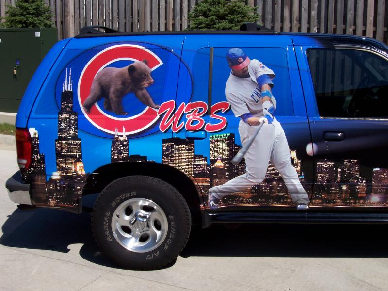

70/30 perf pattern is better than total block out vinyl, that way customer can atleast see outside the window or windows and you get more "pop" with a 70/30 than a standard 50/50. Check your state laws to be on safe side for any perf pattern or blockouts on vehicle windows. Hope this helps.
"Deposit Please"
Here's a wrap i did 5 years ago. All windows are covered with a 50/50 perf. It has good "pop" for that pattern.
