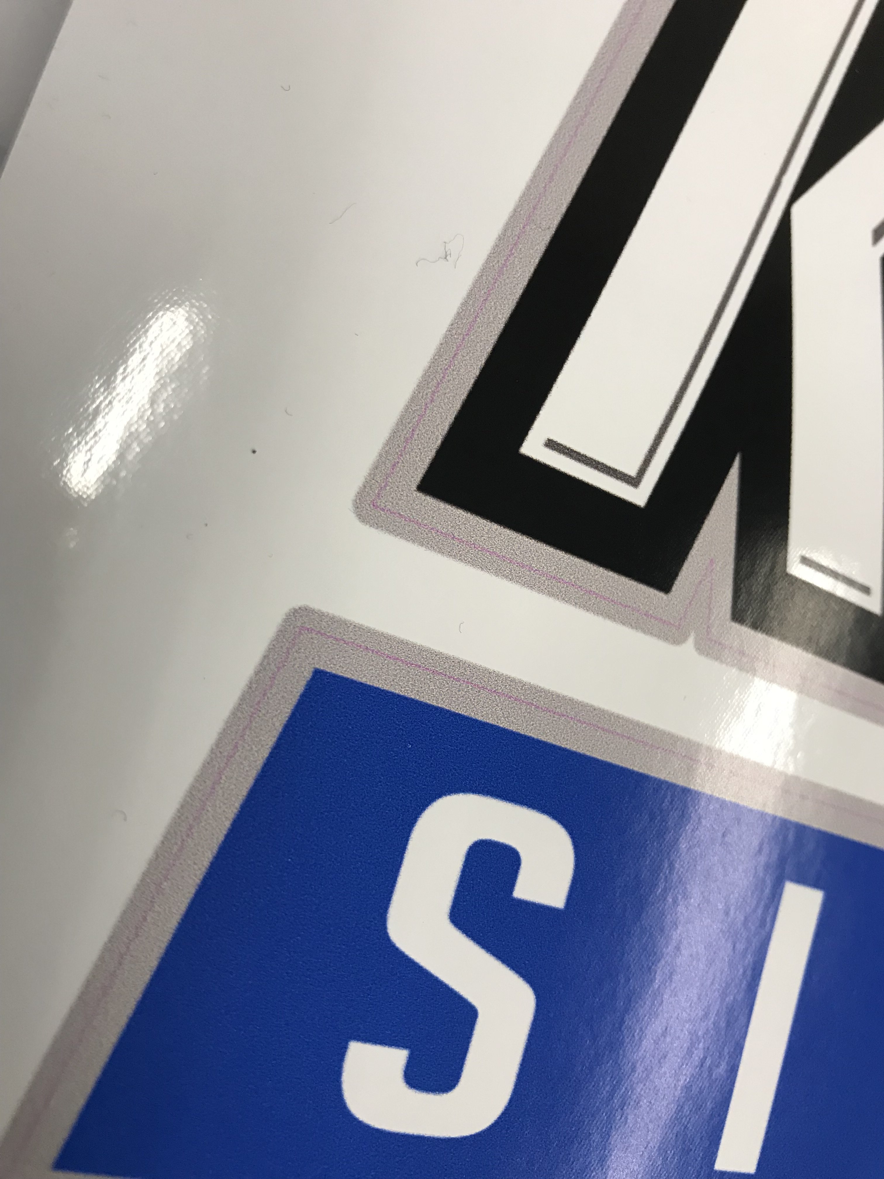

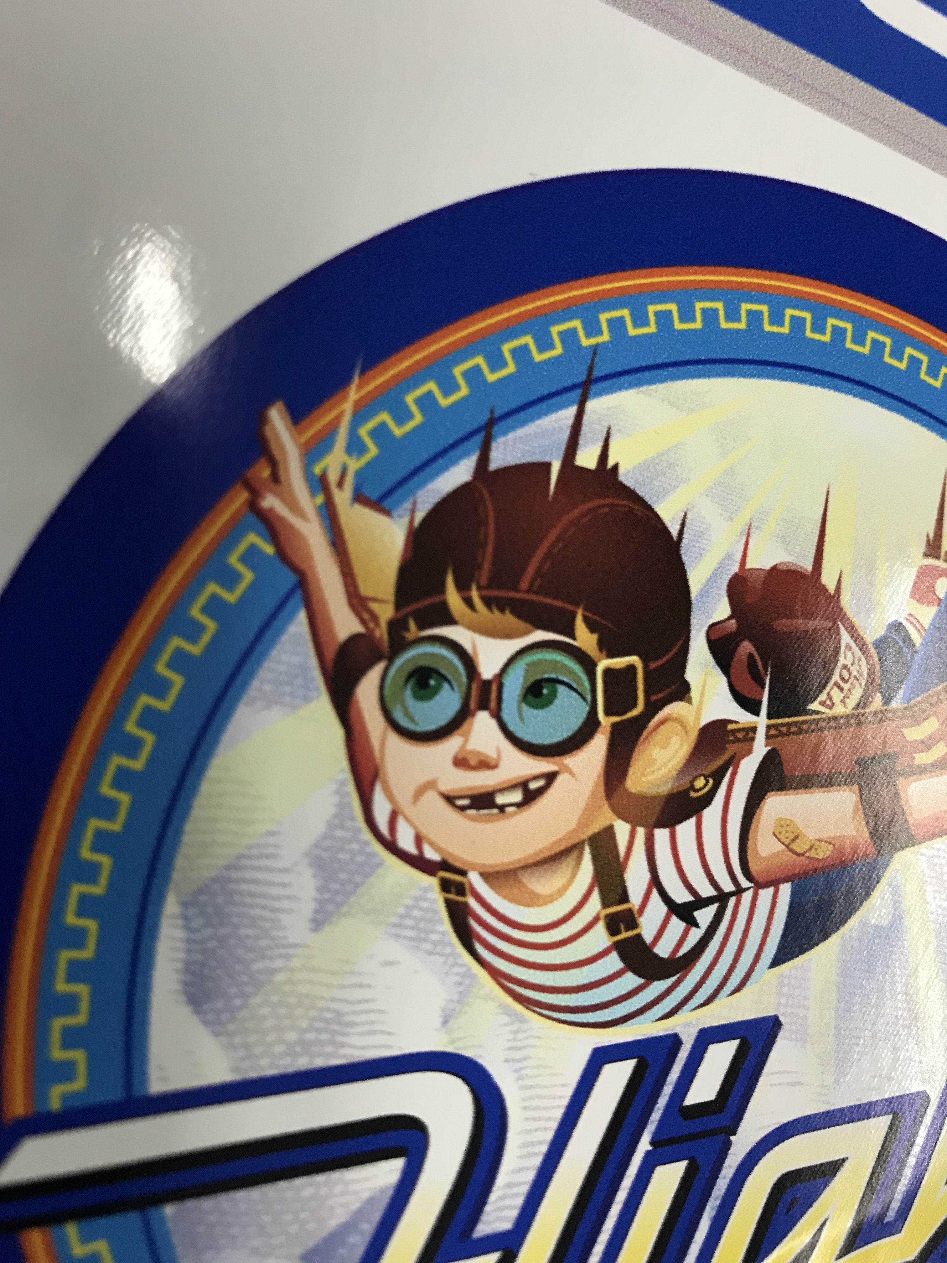

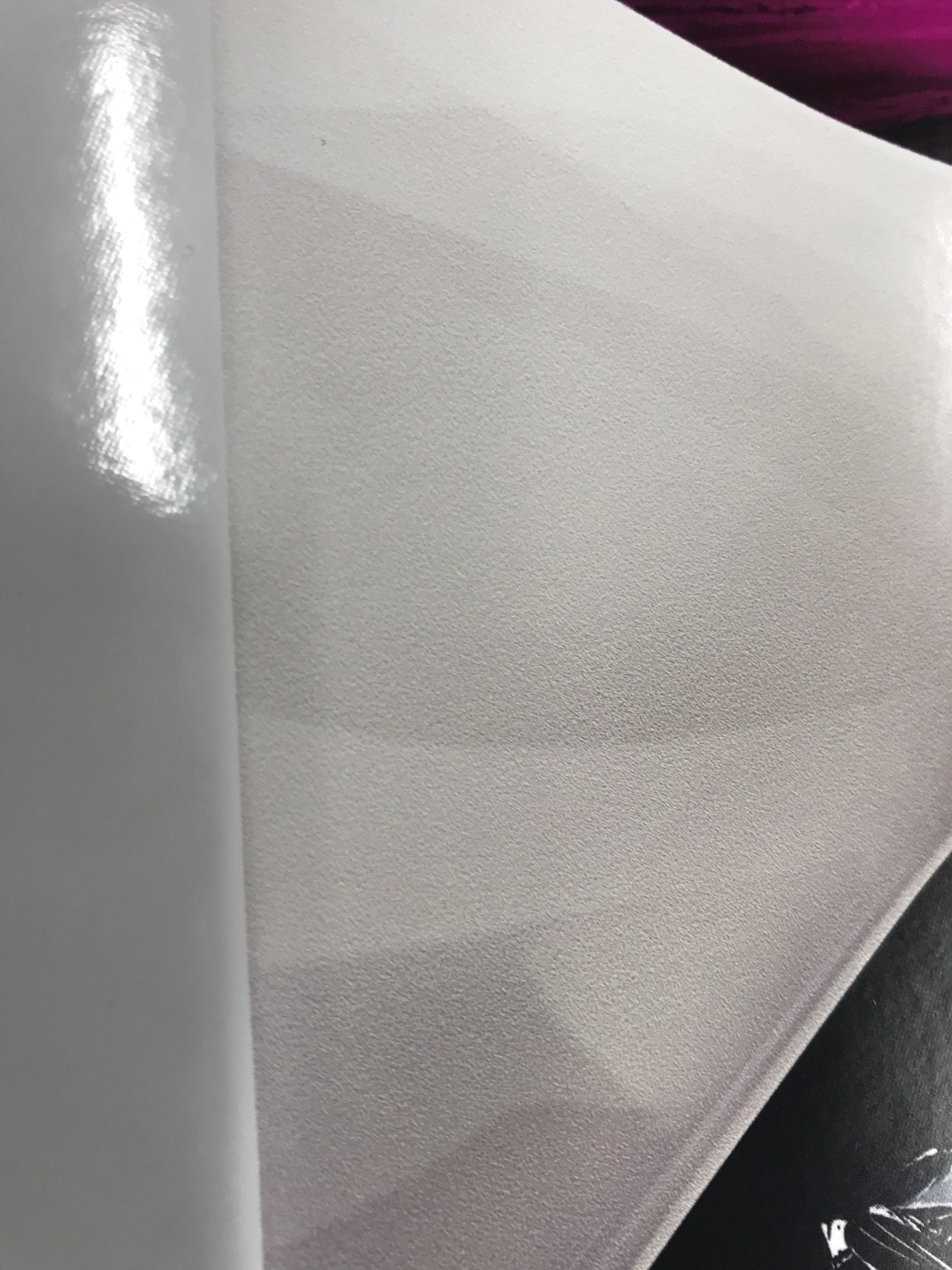

samples printed.

Just seen some stuff printed off the latex. All the colors seem very grainy is that common with this printer?
Yes, see here https://signs101.com/threads/hp-latex-and-sticker-printing.146193/#post-1374328
Lots of folks will claim they have no graininess, but when you look at their samples posted here or samples of prints sent to you, they show graininess. Anything not viewed "close up" will look fine. This is a great sign and wrap printer, it is a horrible "sticker and decal" printer if someone looks at them within 12 to 24 inches.
If you are doing anything that will require close up viewing, go with the Epson. We use Canon 4000's for our sticker business, since all of our stuff is indoors (school stuff, office stuff, etc) and viewed close up. The material and ink cost for aqueous is way more expensive vs the cost for solvent/latex/UV printing.
I love my HP latex for anything sign related or for distance viewing. If I had more room, I'd have at least one Epson in my home shop, but I'm out of room, for now. When I can get rid of my latex, it'll be replaced by either an Epson or something else, but certainly not another Latex machine.
Fixed 12 picoliter droplets, what were they thinking...smh.
Yep, grainy is the word I would use also, was not impressed with the latex's output, that is why I like the Epson machines. Photo quality and hits all the colors.

It's a fine edge these printers walk. The HP is not designed for ultra close viewing on smooth surfaces like Vinyl. If you want close viewing but sacrifice production the Espon all the way, if you need volume then the HP is the better shoe.
These Latexes are designed for Production of larger signs and graphics, by they also do really well for close viewing on Fabric, Wallpaper, Canvas, and other textured surfaces where the grain disappears.
