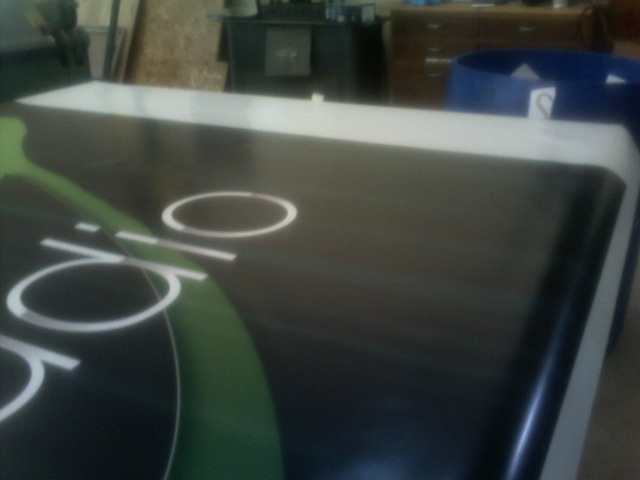

I have a banner 50''x80'' with a dark brown background and bright green letters. The printer is producing long blueish green lines across the print. We tried cleaning the printer thoroughly and replacing all the ink cartridges. Has anyone experienced this problem with any solutions?

Whats your test print look like? Possible could be your feed adjustment is off as well. Do you have a picture of the banner you could post?

Hi,
Take a look at this banner that has a stripey print job. We are currently looking into replacing a sponge inside the printer that has ink collected on it. There is also a container underneath the printer that holds cleaning solution that seems to be filled with dirty black liquid.
We checked out the print heads and they don't seem to have any visible fuzz or dust on them. A maintenance person suggested it may be a damper on the heads that are clogged and caused the printer to basically "choke" and not let ink through.

that is textbook ink starvation. i'm about to cast/coat a bunch of prints. if someone doesn't help you solve it in the next hours i'll help you get rid of it. it's and easy issue to isolate and solve.
theColorist
I think your maintenance guy is correct. For troubleshooting, you can try printing it at a slower speed, so the ink supply on the damper doesn't get empty.

ink starvation is a cause of either insufficient vacuum below the print head or insufficient ink supply above the print head.
first thing you do is determine what color is dropping out. swap ink lines with that color location with a different adjacent print head. you will be running the wrong color to a head. make up a graphic that is a big square of the color you are losing and the color you are switching (big cyan rectangle, big yellow rectangle or whatever).
does the ink starvation show up at the new position of the damper/line swap? or does it remain at the previously starved ink? if it moves to the new print head, you have a supply issue. let's say cyan is dropping out. you move cyan to a new head. cyan still drops out. ink supply. or cyan now doesn't drop out, but yellow drops out. vacuum issue.
do that first and then get back.
supply side is caused by clogged dampers, clogged line, uneven printer, high ink viscosity, clogged cartridge needle, faulty cartridge.
vacuum side is misaligned capping station, clogged pump tube, faulty pump, dirty cap or worn cap, clogged print head.
if neither of these can be isolated. than you can do a data cable swap to see if it's an intermittent data issue. but i doubt it. data issues are usually the result of printing gibberish. not lack thereof.
