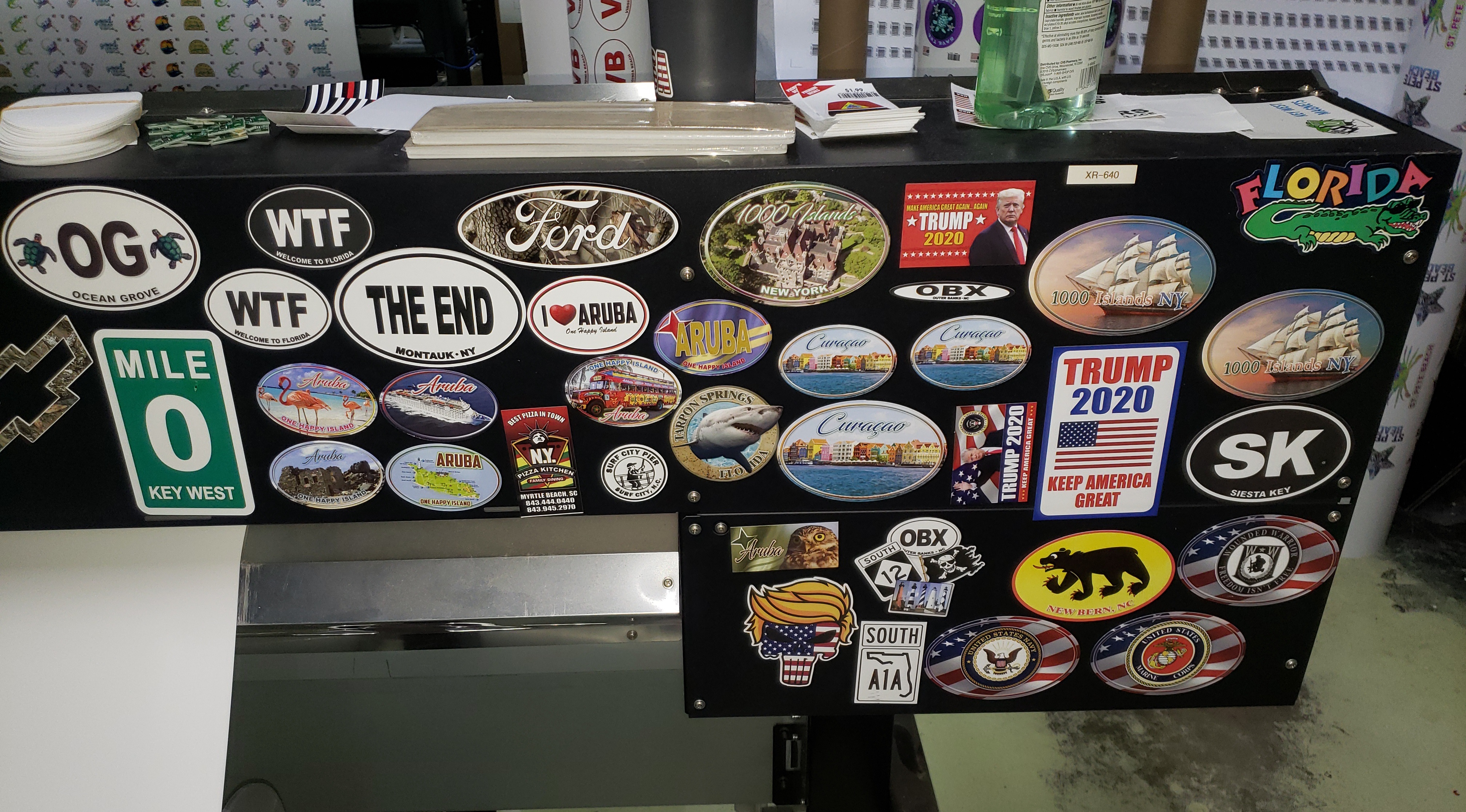

I Love printing direct to magnet material on my Roland XR640. Roll to Roll. Never have I had a head strike in five years.
I don't print magnets daily, I save them up and run them monthly, On about four rolls of material 30"×50'.
All printed on a Roland XR-640 and cut on a Graftec 2250.
All shapes and sizes.
Those look nice. What brand/series of magnetic are you running? Are you having to magnetize the magnets after printing or did you need to do anything to keep the magnet from sticking in the printer?

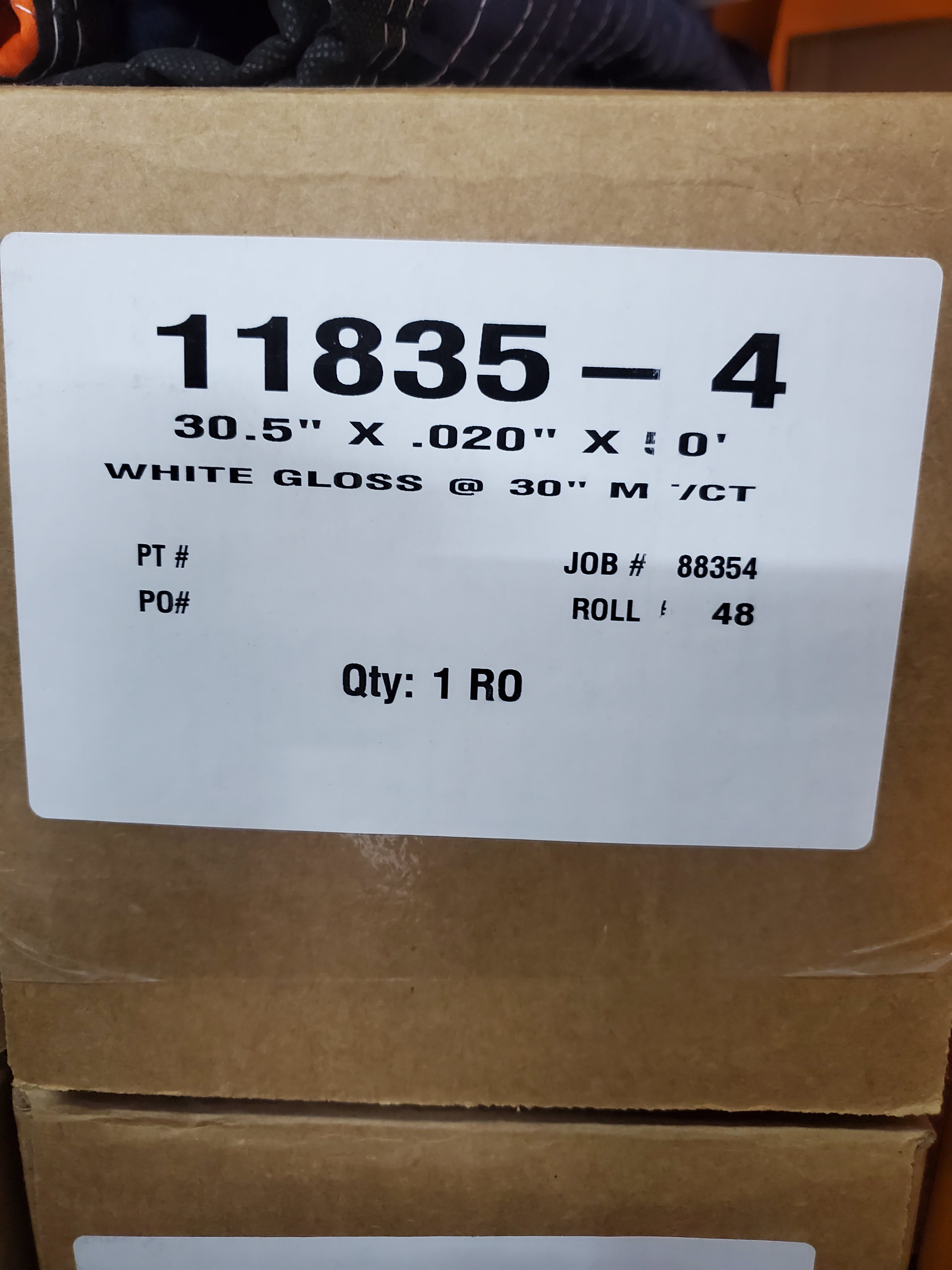

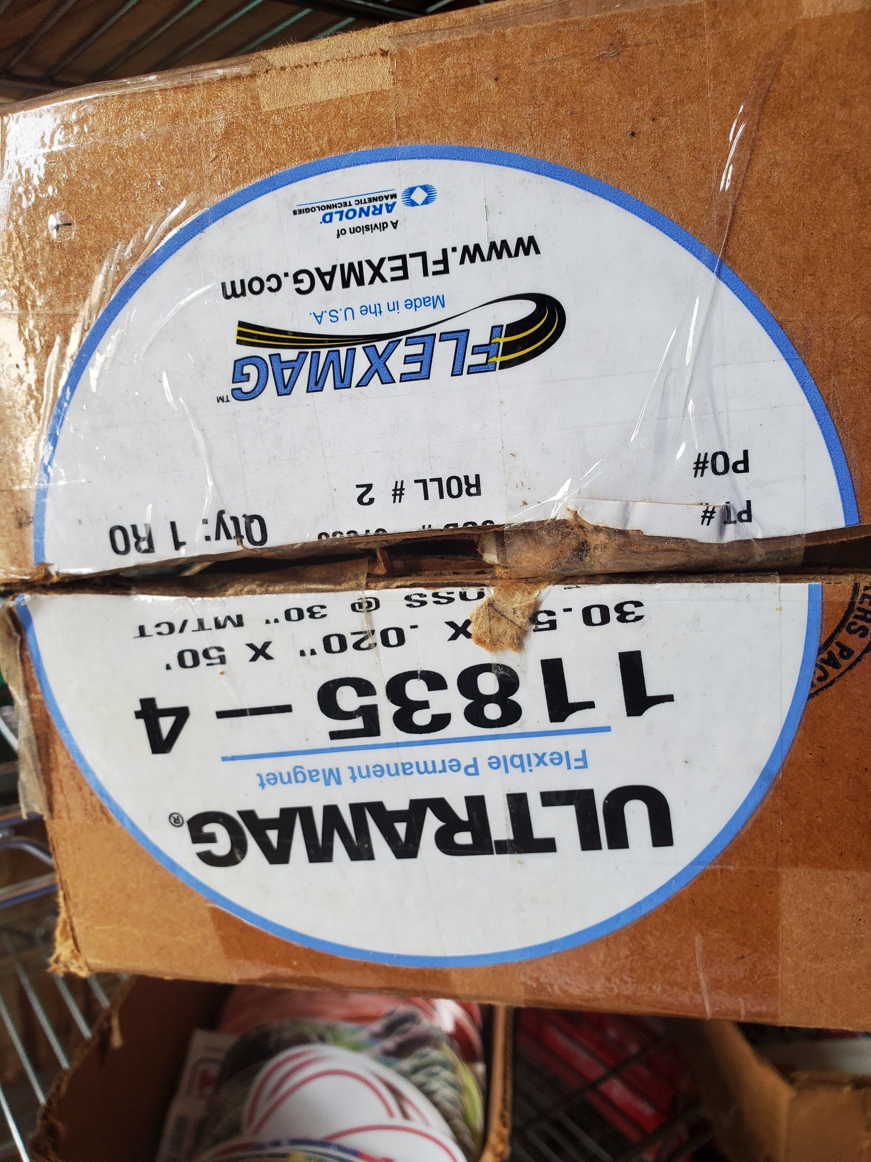

Here is a picture of the label

Thanks for the info. BTW. it looks like your printing .020 thickness based on the label from your screen shot.
Do you also print direct to .030? That's obviously 50% thicker and closer to the print head. That might present a problem.
