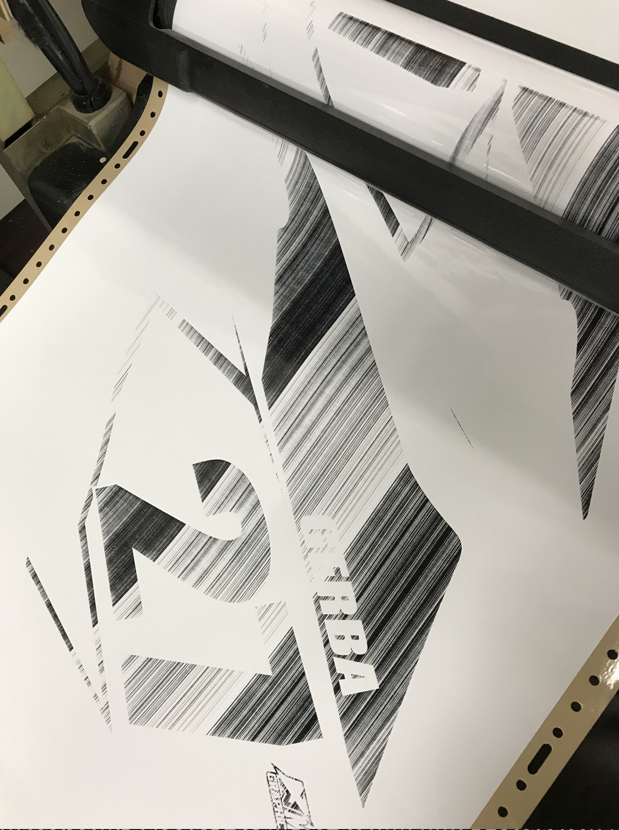

Would anyone know what caused this? It was printing perfect last night and then I come in this morning and it prints like this. I am not sure if its from the vinyl being a little colder than normal or an actual problem. The printer only has about 11,000 minutes on it.

When was the last time you cleaned the print head? Are you using Gerber vinyl and foils? How cold is "colder than normal?" Do you have the correct materials selected for what is printing? Is it only this job that's printing incorrectly or any job you send? If the former, trying clearing out the job and resending. If the latter, make sure your connections are all good.
yamaha581
We did clean the print head not long ago but are waiting for the cloths to come in today to clean it again. it is all the same Gerber foils and vinyl we have been using all year as well as the same settings. It did this on both jobs I had tried so I just stopped for now. It got down to be about 65 in the shop so I would say the vinyl got pretty cold compared to normal but I did wait to print until it warmed up in here. I will try again once we get this head cleaned.

Down to 65 shouldn't be an issue. We set our overnight temp at 64 and have no issue with our Edge printing first thing in the morning. Have you had any data errors? Have you tried just running a simple test print that's 1" - 4" x 11.8" on the same material and settings to see if it has the streaks?
I'm assuming you haven't changed any hardware, software, or computers between yesterday and today.

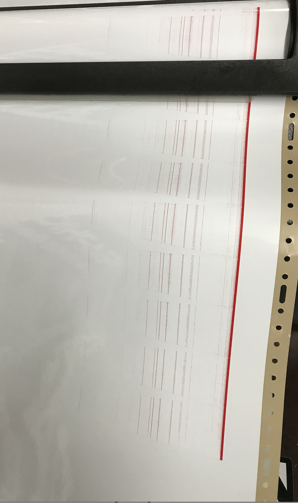

It will look the same as what was shown in the last two pictures. Even on other vinyl we have here it does the same. The red in the last picture we posted is with the Gerber test print that does the checker pattern of solid squares and it just comes out like that not printing half the color.
yamaha581
The one thing it does seem to be doing is before it goes to print now it says warming up and takes a little before it prints and then when it does it doesn't print much as shown in the first picture. Before it would only saying warming up the first time we would use it for the day.
yamaha581
and a large block of colour on test print.. is this the same result..if so, I fear the head personally...??
Yes when we do a large solid block it prints the same as the original picture we posted where it does not turn out solid and just had lines and spots of nothing showing up. Can a head go that fast? Last night it worked perfect without any problem and it only has 11,000 minutes.
