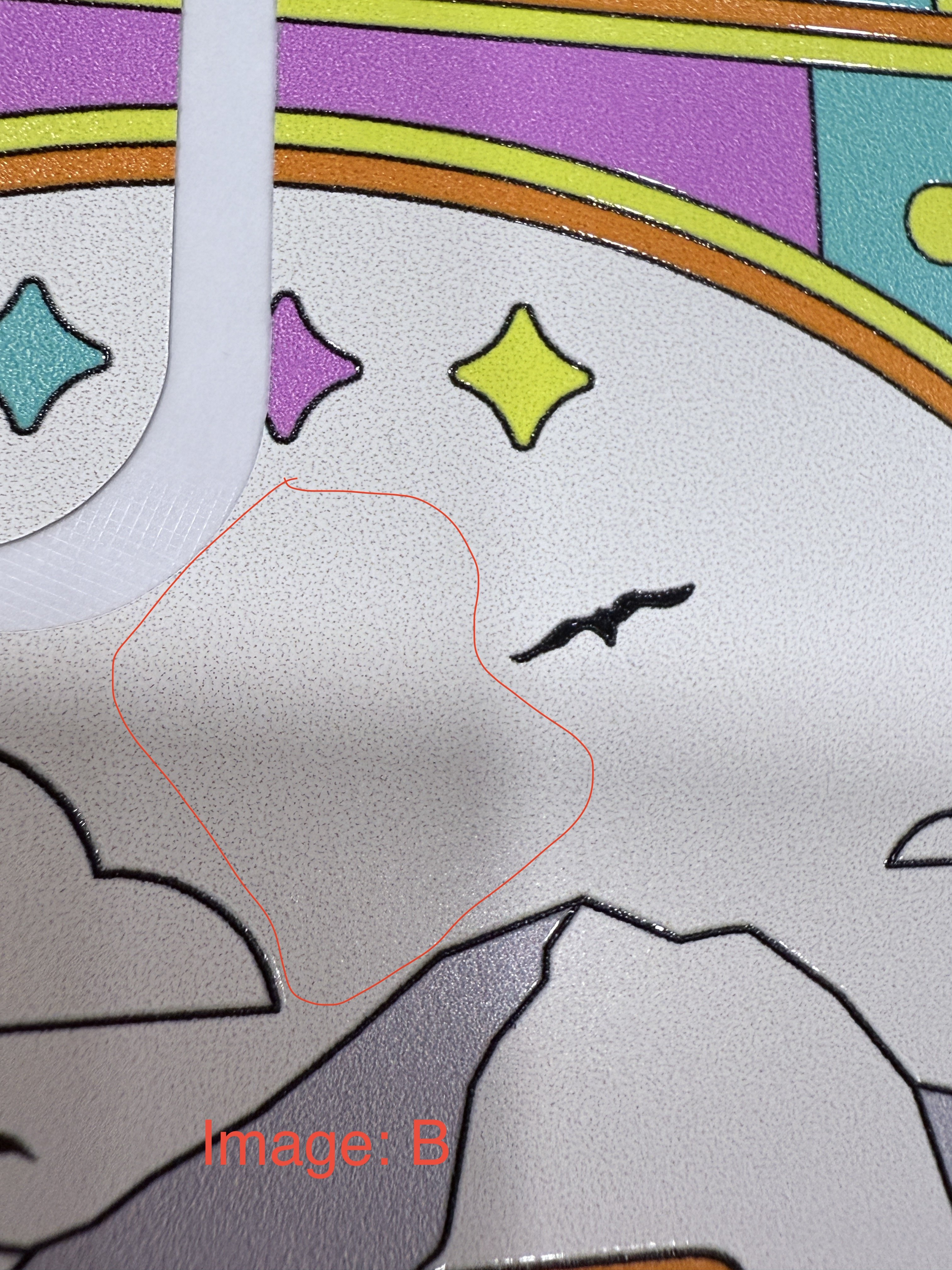

New to large format/solvent printing. I have a Roland SP540i running Liquecolor inks in a 440ml cartridge printing on Oracal 3651 gloss
I read some posts and adjusted print temp to 108 and dry temp to 110
Lighter colors seem to come out grainy, darker seem ok if I print at high quality, also used a few different color profiles in versaworks and kept getting better
My question is will I ever be able to get rid of the grain with Gloss? or would I have to go Matte with Lamination?
Would settings, calibration, ink or media make any difference
Thanks!

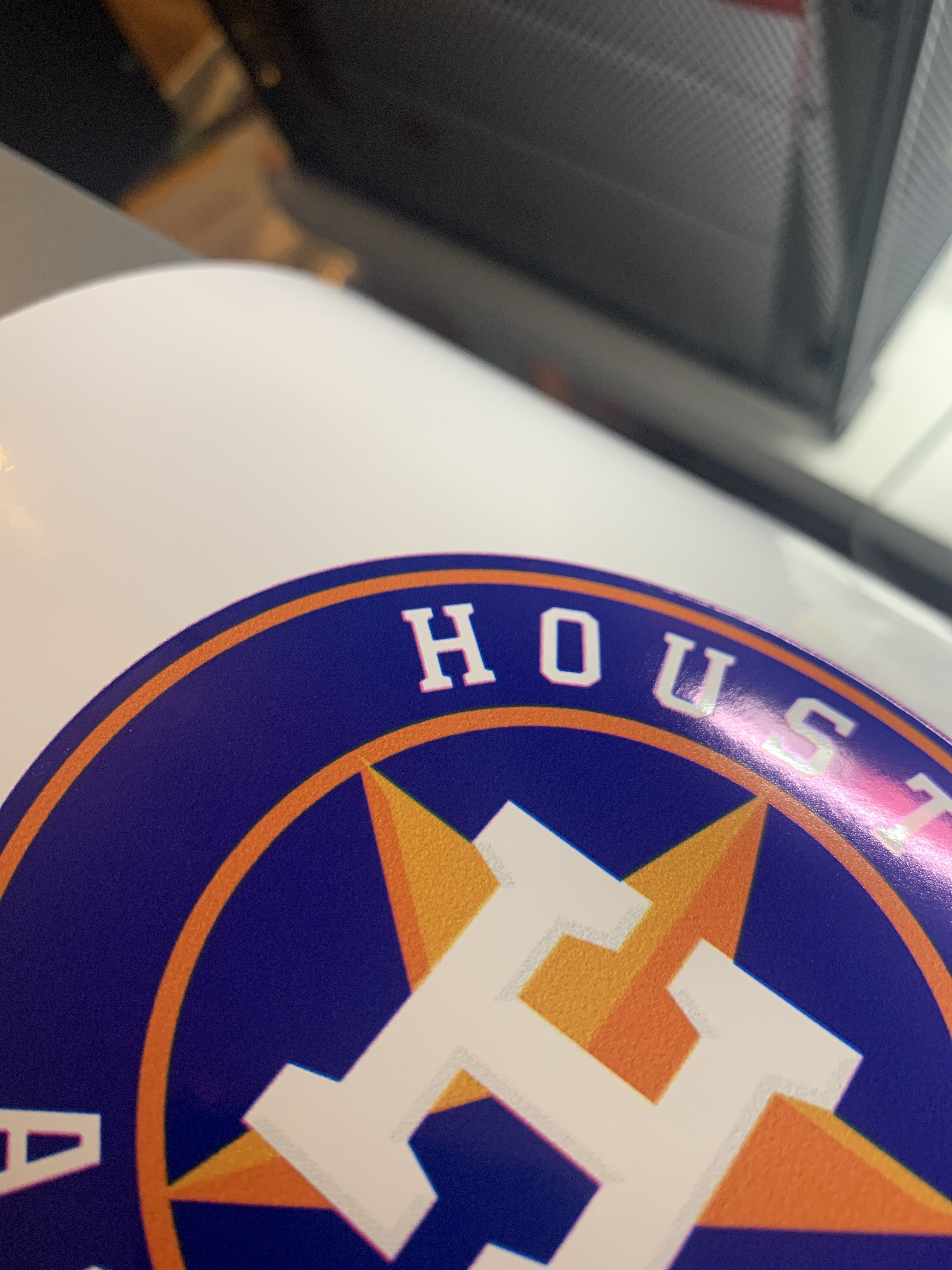

Ran through a detailed bi directional adjustment.
now printing at high quality seems to get rid of the grainy look. I’ll load a couple pictures
ml4cs

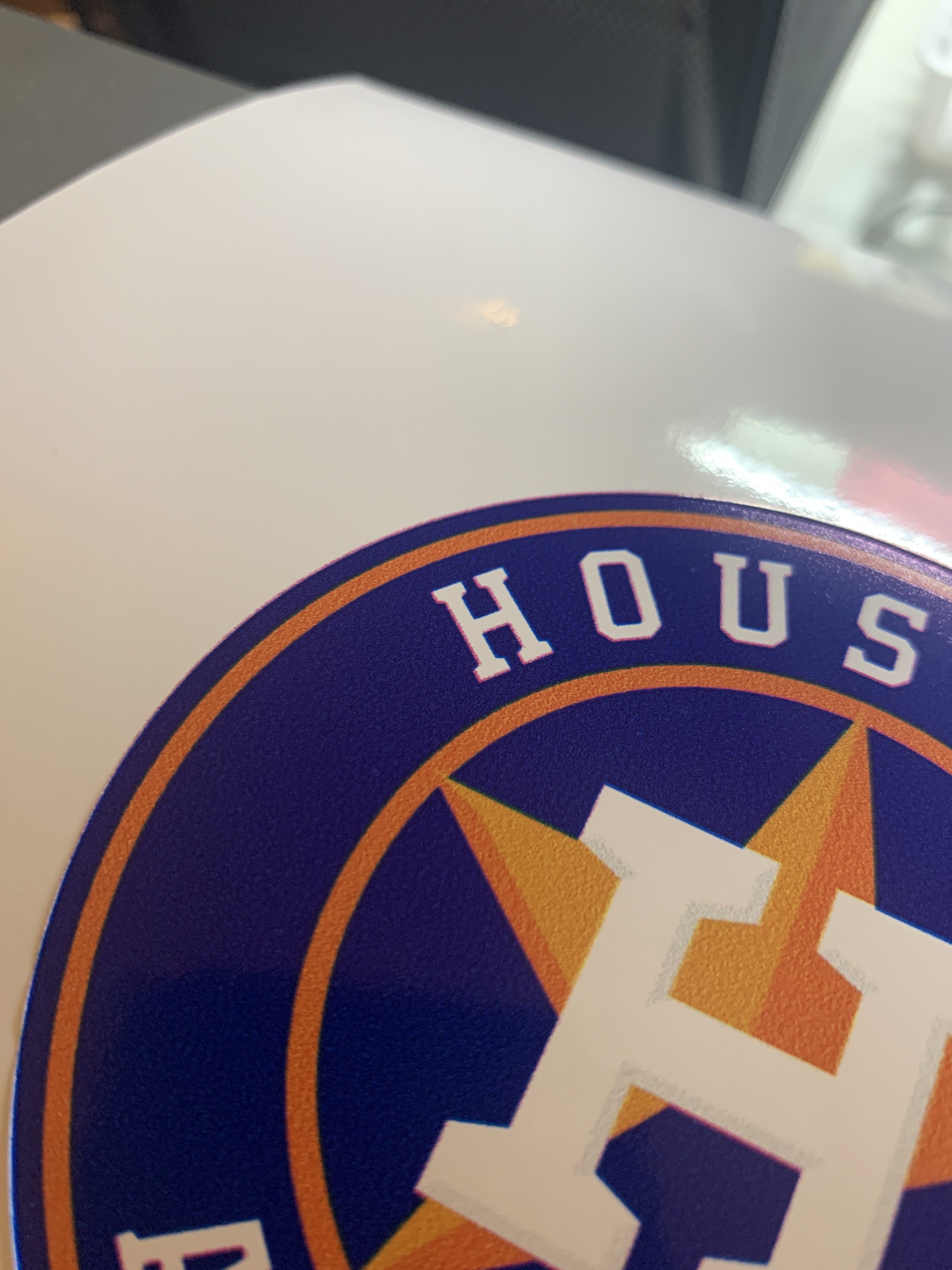

And how can we change this? my print is also giving some grainy effect.
cornholio
First things first.
A SP-540i is a CMYK printer.
LC/LM/ and especially LK would help a lot, but not possible on this 4 channel printer.
If your head alignment is off, you get grainy halftones, no matter the settings.
A quick check is a 100/100/100/100 hairline (0.05mm) square 30x30mm or so. Printed with "density control only".
The vertical lines will be wider. If a lot wider, or double lines, this tells me that the bidirectional setting is off, the horizontal adjustment is off, or the head(s) are slanted.
You can print unidirectional, to take out the bidirectional factor. If in uni, the verticals are still wider, you need to adjust the heads in service mode.
If the horizontal adjustment is off, you can reduce the head speed to 300 to check.
