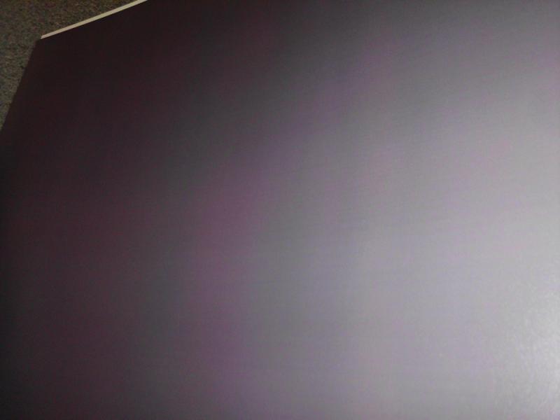

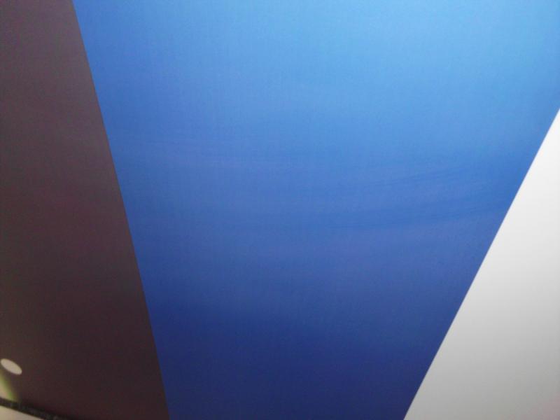

Currently printing large format graphics with an Agfa Anapurna M 4F. I have tried cleaning the sintra with alcohol, rapid prep and even Windex (because you know it is streak-free). Well regardless of what I use for cleaning I still get almost like a cloudy effect in my color. You can sometimes even see the wipe marks. I attached a couple of pics.This happens a lot when solid gray is printed. There will be large "stripes" that almost have a red tint.
I don't know if we should start using something other than sintra to print on or if anyone here would have any other suggestions for me.

Basically......you are screwed. Unfortunately, it's an alarming trend we have found from our PVC suppliers. Sintra, Komatex, Celtec, all are effected. Basically, if you don't clean the boards you will get an unpleasant smearing effect from the manufacturing process of the board, and if you do clean it you will get the effects you are seeing. We suffer from this more on light cyan covering, but also a little bit in light grey. We;ve talked to Laird, Piedmont, and Alcan and all have the same response.
Basically, we have to print a layer of white on the boards first to get decent (smear free) output. It sucks from a time and cost perspective.

is it a "smear" or a uniform "banding" in the direction of the print?
edited: closer inspecition of the photo appears to be the former. disregard my inquiry :)

We fought this a lot when we had our m4f. The Agfa ink is bad about reacting to surface contaminates and shows it. Our fb500 is nowhere near as picky as the agfa was. Things that helped for us, 95% alcohol, lint free cloth. Ideally buy your material by the skid and only wipe with lint free cloth (or not at all). I had more than one conversion with Agfa at print shows about not even needing to wipe material with their printers.
The reddish tint in the gray graduated print looks to be more than an unclean board...looks more like a non neutral color profile to me.
