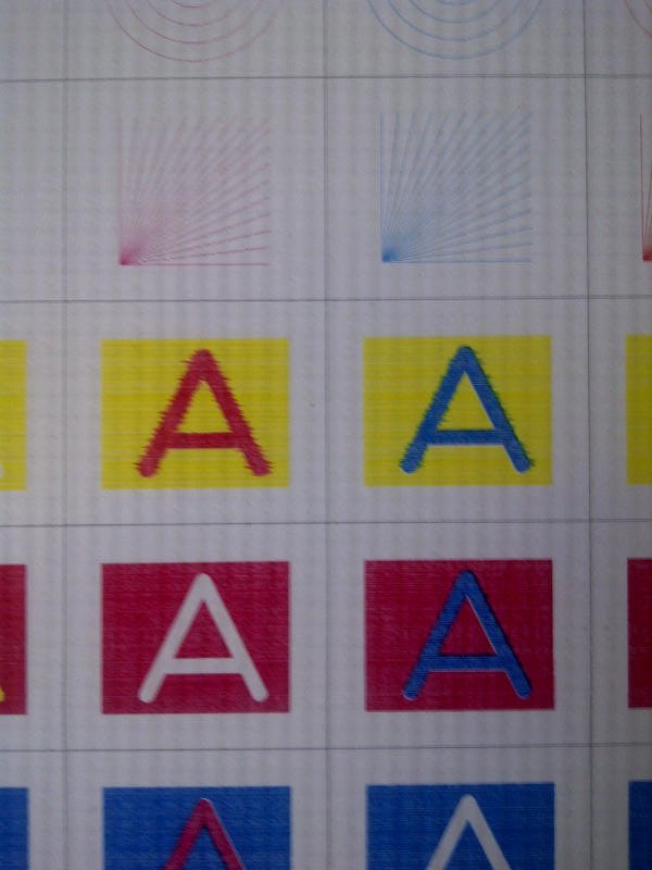

Question.... has anyone had any luck converting a pigment or AQ printer to eco-solvent and had success printing on uncoated media (vinyl and banner material)?
I have a Mutoh RJ6000 that was converted to eco-solvent. But there are no heaters.
The printer is operating very well with the eco ink in it. Test prints on regular paper are fine. nozzle check is decent.
My problem is that as soon as I put a roll of vinyl in and try printing the ink bleeds horribly. It's all over the place.
I've attached a photo to illustrate.
now please note that I did manually heat up the vinyl with a hair dryer before I printed this.... I understand that's not in any way a solution or recommended way to heat up vinyl, but I just wanted to see if it was strictly a heat issue. It seems even if the vinyl is warm, it still bleeds horribly. the example photo is consistent with a print that I did without heating the vinyl.
I'm not sure the brand of vinyl, I've tried printing on three different materials... same result across the board.
Am I SOL? is it simply not possible to print eco solvent without heaters?
I could have sworn people here have said they have done it successfully, but maybe it's just wishful thinking on my part.
ANy input or suggestions would be appreciated.
disclaimer: yes i know the solution would be to buy a new eco-solvent printer haha this is more of a challenge to me now... I want to make this printer run!

So, one says you can't and two say they do it? I'm not sure who to believe. I'm looking for a way into printing outdoor signage .. I have an RJ6000 as well. It says it can accept eco-sol inks. Do I bother? I have an external heater that I thought would just help cure it, can I put it on the pre print side?

It will not work with uncoated vinyl. It could be that you will be successful with very low ink limits on a few medias, but with poor gamut. The first Rockhopper I, which was an EcoSolvent-Printer based on the RJ-6000, was unable to print acceptable quality on vinyl too even the printer was equipped with heaters because of there was no heater directly below the platen, just a preheater and a dryer. Later Mutoh have offered a direct heater upgrade kit because they need to.
Perhaps you can find some coated Vinyl to print on?
