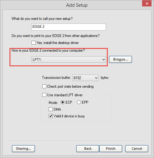

Adding the Edge 2 to Flexi
In Production Manager go to SETUP>ADD SETUP
Tick the Printer Radio Button
Choose the Gerber and Edge 2

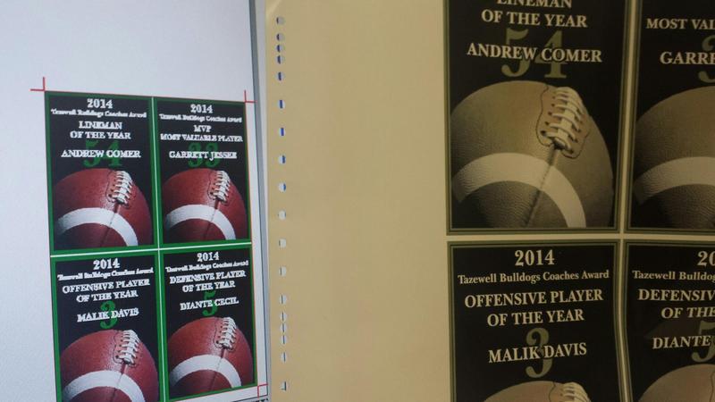

We have it printing but.......it's printing horrible!
see attachment

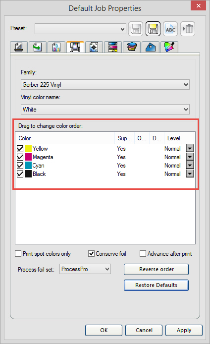

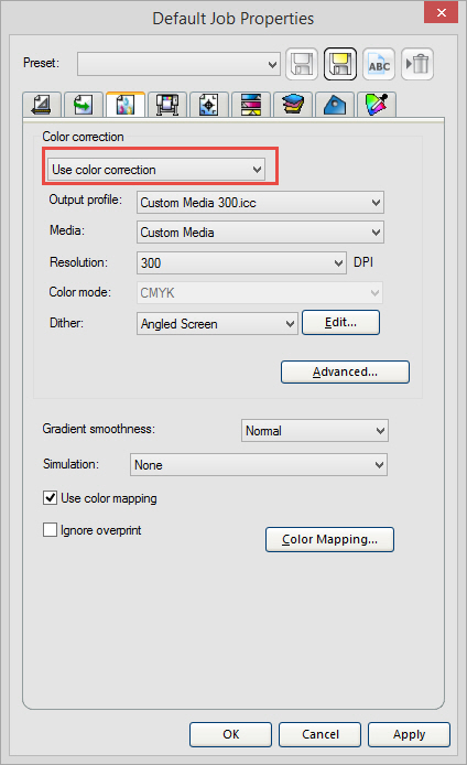

Printing Order & Profile
Be sure to download the Color Correction ICC profile for your device. http://profiles.saicloud.com/ Place the profile in the ICC Folder under flexi for Gerber Edge 2.
In addition you may need to be sure that the ribbons are used in the right order, if I remember correctly. Takes a little getting used to but works well. Coincidentally, I am working on a Flexi for Gerber Users webinar and training DVD as we speak! Details to follow in the coming weeks.

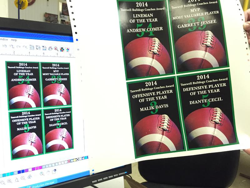

I think we figured it out. Because the colors in the design were Flexi colors we had to print using 4 color process. We need to assign gerber colors and then we should be able to print spot colors...Correct?
We will try spot colors again in the morning.
sgns4u
We were able to print with spot colors today. They are beautiful!!!!
Had a few minor glitches such as cut lines and the registration mark but we figured those out pretty quickly.
